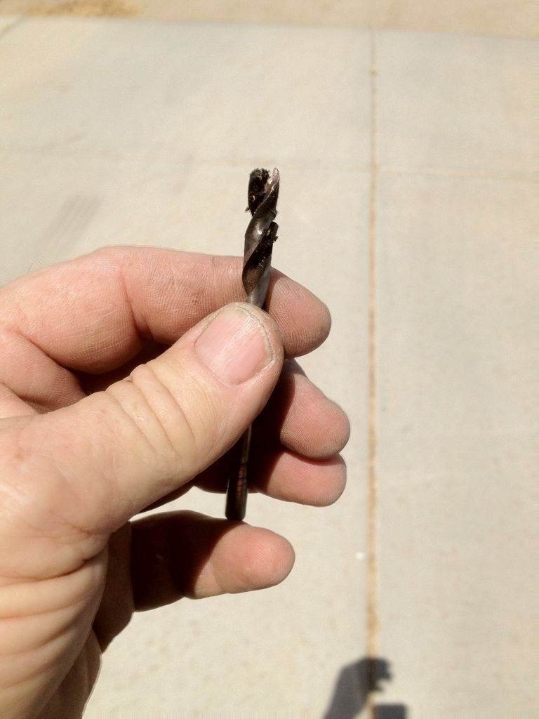

Hi, everyone:
My next goal is to get the car titled and plated, next week if possible. Not too tough.......LOL
(Note to self, check closer before drilling anywhere on this car. There is high voltage everywhere with systems up and running.)
It will be OK, it is right beside a cable, but it should not touch......&*#@!%&@!^*$#)^!&!)$*!(&#*&!*_
The AC lead to the Elcon is 2" shorter that it used to be.
When things are going right, I tend to get casual.
There is no such thing as too safe. Plan safe. Plan again. drill last.
(I wonder if it will resharpen?)

ZORCH! How exciting was that?

The adrenaline rush was satisfying but wore off too quick.
