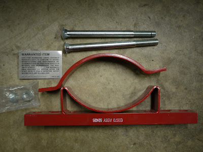

So yesterday I pressure washed the 178,000 miles off grease of the car so when I work on it I don't look like a coal miner.
And tonight I deiced to go ahead and dry fit the motor without the hub. I first needed to layout the motor cradle so I found a short section of heavy wall 1.25" pipe that had a nice tight fit over the input shaft. This allowed me to measure the height and see that the cradle fit really well if I welded it to the sub-frame.
The cradle is the same style I used on the leadwing. It's actually a mount for large high pressure cylinders (9" OD) in military ships. It even comes with a warranty plate circa 1988. Either way it is very stout, comes with all the hardware, and was $30 for two of them shipped!
It will need some modification but for now I just tacked it into place to dry fit the motor.
I am glad that I went with the 9" motor as once I put on the adapter on the assembly weighed over 210lbs! This really wasn't bad to lift, carry and man-handle into place, but if I had a 11" (~350lbs) I would have definitely need a hoist.
Anyway the motor fits in really well. I am going to trim the cradle away some before I weld it all in as I think I can lower it about another 1" to give a little better CG. Seems excessive but this is the heaviest single item on the car.
