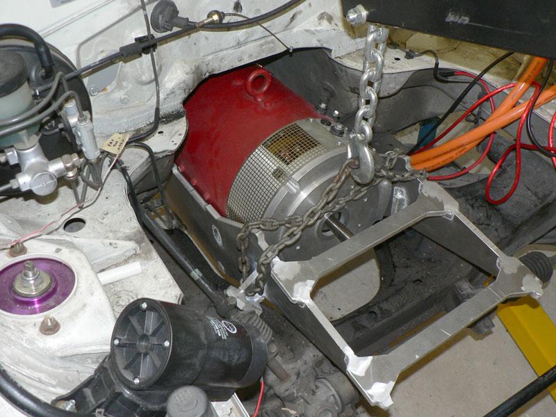

paker,
I have a Warp 9 in a '96 Miata. It is a very tight fit on the diameter. There is only about 1/16 of an inch clearance between the bottom of the motor and the power steering. You may be able to relocate the steering and gain the space you need. I'm not sure about that.
Rob

Hmmm.. I'm not so sure I'd want to mess with the steering. If it was just a mount issue I could work with that. Thanks for the picture RKM.
