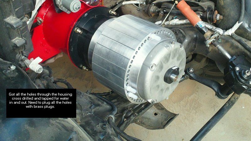

Ivansgarage is building a GMC Sonoma. He is using the original 4L60E transmission. It will work nicely in the truck which will be 3,500Lbs and up in weight. It is still converterless and retains the automatic shift features.
The water cooled AC motor being mocked up with the 4L60E transmission.
The motor specs are not public yet, but it is about 1/3 over an AC50 in torque. This and the 4 speeds will make this a really nice driving combination.
You can kill a nice install by "cheap skating" the gearing. (Trying to make do with what is in the vehicle.)
Everything is in the gearing for your situation.
