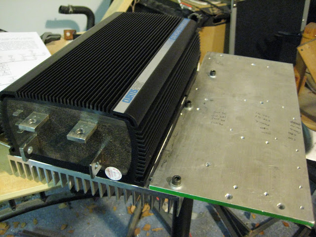

jyanof: My max temp in that test was about 168 F vs the amb temp of 90. It seems like i may have an overheating problem compared to what everyone else is reporting. Any suggestions
Well, most of your problems with temperature are because the controller is putting out so much current. A heatsink would help (i got an aluminum extrusion off ebay) but you should do your best to keep the current down.
I thought i had a better picture, but this is my heatsink - the curtis has since been replaced with the DIY controller. There are fans underneath.
just to prove i'm actually using the DIY controller...
To keep things cool, try shifting gears so that the motor rpms are as high. Not sure what your motor is rated, but I keep my Impulse 9 around 5k rpms while cruising and a smaller motor should surely handle something similar. For me, that means I stay in 1st until 25 mph, 2nd to 40 mph, and 3rd to 55 mph. I think my overall gear ratio is a little larger than yours, so you might be able to go faster in the same gear. You also may have a tough time shifting gears without a clutch, but it'll keep your motor amps down - see if you can get down to ~250 while cruising.
As an aside, your motor must be getting hot too, no?
And, that shunt should work fine. I have a 500A 50mv shunt in the motor loop and have used a relay to toggle between that and a battery loop shunt.

I have no way of measuring motor rpms or motor temp. At least i dont think. Is there a cheap way to get that data?
Are there calculations to follow to figure what a good rpm to shoot for is based off my gear ratio and motor size?
I'm thinking maybe stick i small computer fan in the plexyglass sidewall of the controller if space permits, and if i need to, ill add heat sink on the bottom. A fan seems like it would dissipate more heat than heat sink right? plus im adding a fan to my charger so it will be convenient to add a second.

there's always the hand temp sensor - after a trip, see if you can keep your hand on the motor for a few seconds. If so, definitely good. Or, there are cheap IR thermometers out there for 10-$15. Should give you a ball park idea, anyway.
a fan on the internals would do little, actually. I assume you put the controller together, so you know that the mosfets/diodes are clamped to the aluminum heat spreader which is bolted to the base plate. That's a very good thermal connection from the mosfets to the baseplate. Transferring heat from a heat-source to air is all about maximizing the surface area in contact with the air. Increasing the surface area with a finned heatsink will far surpass the surface area inside the controller and provide a much better cooling mechanism. Not that a fan inside would hurt from a cooling perspective, but you'll subject your controller to a bunch of crap blowing in for only a small gain. No one i know has actually done it though, so maybe try it out and see if it stays any cooler.

The cheap way to measure RPMs is to research your gear ratios, then find the right Formulas (they are here and all over google) to turn your MPH into motor RPM. Then you will know what your RPMs are at a given speed and gear.
You need a heat sink. A fan only provides air flow over surface area, but if you have no surface area that will do nothing. You can get a nice aluminum heat sink on ebay with 1.5-2" fins for around $20-30. Then if necessary you can add a fan to that for even more cooling. I didn't need to; my heat sink never gets hot.
