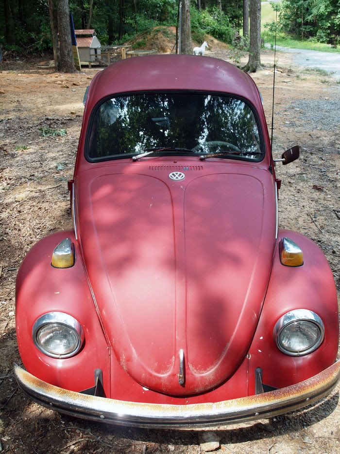

A friend of the family bought this thing and drove it a little, but every time it broke he had to have it towed in and he got tired of putting money into it.
So he gave it to me, currently not running.
If I can get 25 - 30 miles @45mph out of it I can use it as a commuter (10 miles each way, back roads). But I don't know if its possible the way its currently setup, without piling cash into it anyways.
Its a slightly unusual conversion
The body is in alright shape. It does have some rust along the bottom, but nothing awful. All the panels are straight and its even still got the hubcaps and all its chrome trim.

Interesting.
I recognized the sewer pipe adapter for the motor cooling and thought that was a useful way to utilize some old construction parts.
I understand why it kept breaking down.
