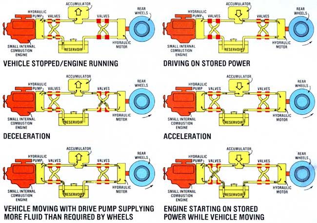

Who am I?
A gearhead like you are. I now make a living in technology but am a certified journeyman mechanic as well. I'm in my mid-fifties and old enough to know when I'm beat and how to capitalize on other peoples work as well as their mistakes. I currently do racecar fabrication and I drive as well during those hours that Corp. America does not have her hooks in me. Like many gearheads, I have more projects than time.. When I crossed the boundary into my 50's I realized that I was burning hours on the sofa in front of the idiot box that I'd never recover. So I guess now I've traded seats and now spend at least some of that time in front of my PC whilst enriching myself on the Internet. During my years turning wrenches - I've been through many automatic transmissions. Of course I was baptised by fire when thrown into the deep end with a Turbo-400 from a pickup truck was assigned to me. (worked like a charm thank you).. I've a thorough understanding of these myterious slush boxes and have grown to both love and hate each one of them equally.
I've had a dream since I was 10 years old to build a series hybrid. Yes over 4.5 decades ago. It was then that my Grand Pa (a brilliant engineer) and I sat down at the rail yards and he taught me how the "new" Diesel Locomotives worked.
It was that principle that I wanted to use (in essence) in the creation of my own EV. Start out building and refining the car as an EV and adding Waste-oil diesel generator to the mix for a range extender.
