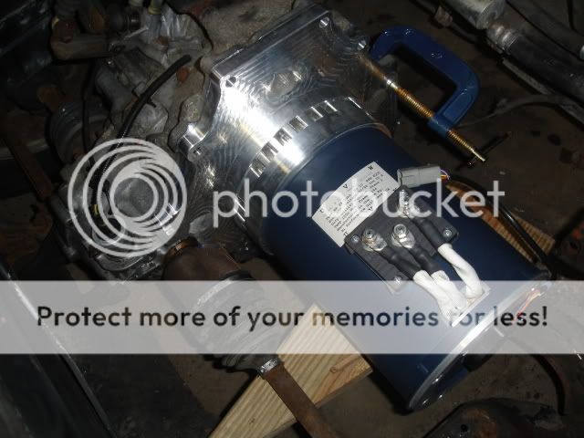

Since there are now a few of us using the AC/30/31/50 motors I thought it might be helpful to have a thread to discuss how people are wiring and mounting them in various applications and what additional components are being used with them, contactors, DC/DC's, fuses, etc.

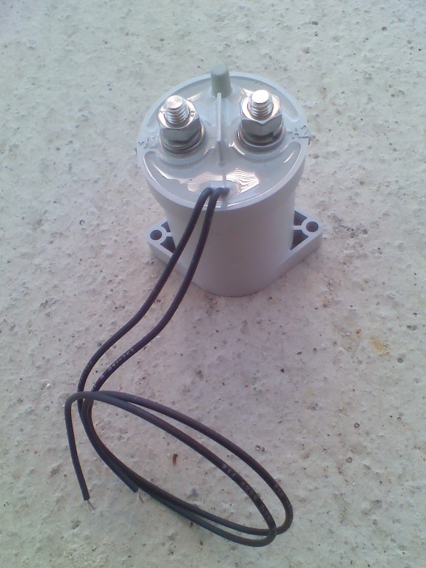

I'm using a Kilovac LEV200 A5NAA contactor I got from HPG, I still need a fuse that I may integrate into an emergency disconnect, and I still need a throttle, (I may make my own since I think the PB6 is overpriced).
Did anyone else get a wire sticking out of their connector like this?
It can be tapped into the large red wire to make the proper connection. Don't know if this was a mistake or they are all like this.

Hey JRP3,
nice job on the motor mount! Is it clutchless? What kind of shaft does this motor have? Keyed, same as Warp9?
Motor looks real nice, definitely need to post more pics and start a build thread
Is the documentation for the controller available online? Link please....
Watching with great interest....

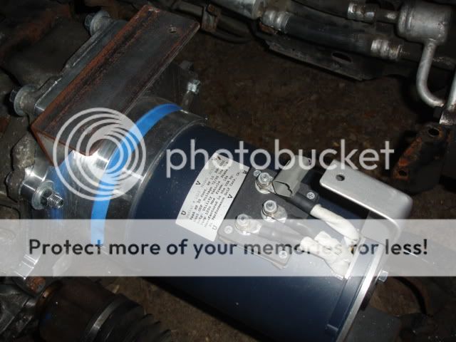

No build thread yet, probably once the batteries arrive and I make some progress. There is also another bracket at the end of the motor attaching it to the original motor mount, I'll get some pics up later.
The motor face and shaft are the same as a Warp9, adapter plate and clutchless coupler are from Craig at http://ev-solutions.net/store/
Motor and Controller info can be downloaded from here: http://www.thunderstruck-ev.com/AC_d...erformance.htm
Best price at this time is here http://www.grassrootsev.com/motorsac.htm

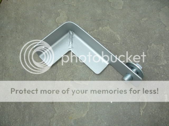

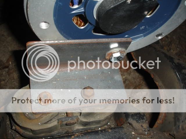

Here's what I did to mount the other end of the motor, I may weld on a section to use another hole just above the bracket
This is what happens when you over complicate a simple idea. I should have just bent some flat bar into a right angle but didn't have any on hand. Probably would have taken less time to go buy the flat bar and bend it than it did to make this thing
Controller mounting board will sit on top of the brackets
