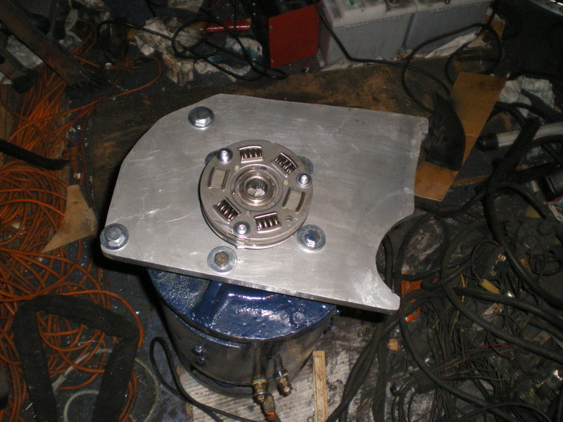

I would not consider the coupler to be my design, I copied it mostly from Electric Lemon: http://www.electric-lemon.com/?q=node/213

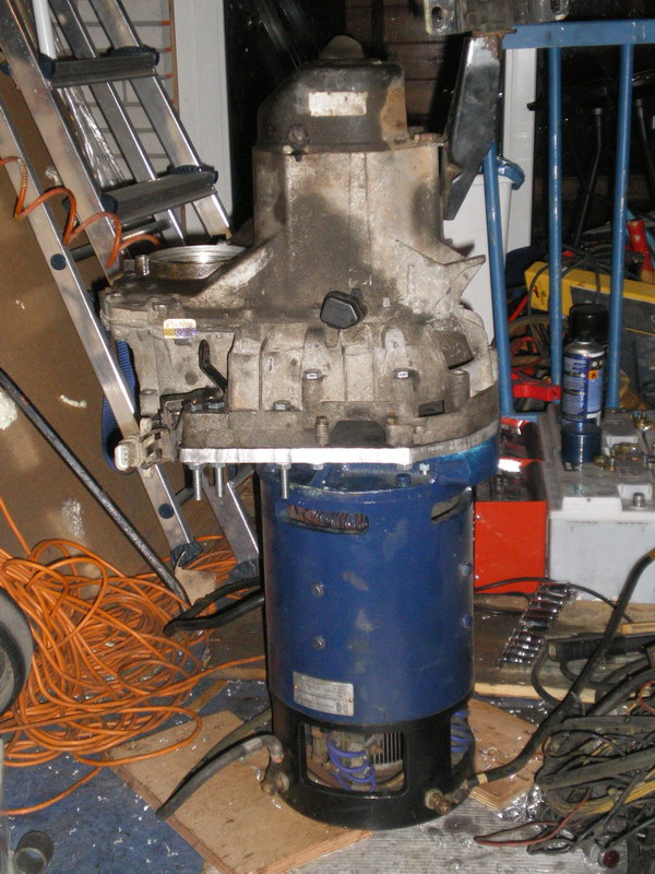

but a little milestone today
with this as the result :-)
http://www.etlaare.demon.nl/firstrun.wmv
no noticeable vibration .. I just hope there's not too much damage doing this without oil for a little while ...
But it was too hard to resist.

It sounds a little rough in the video but that could just be the sound quality. It won't do any harm to run it without oil as it is slow speed, short duration and the gears will still be a little oily anyway.

Yes, the microphone of the camera was quite close and seems to have amplified the sound a bit, but I do agree it could be smoother. I took it apart again and indeed it seemed that the top spline hub was off center for some reason. I am trying to figure out what caused it , it was not much, less than a tenth of a millimeter and it could be just the springs of the connector, but I will do some very accurate measuring before I put it together for it's final assembly (I did not "locktied" it yet).
