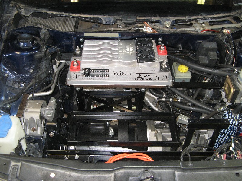

I just got my new Soliton 1 controller!
Can't wait to put it to the test...
