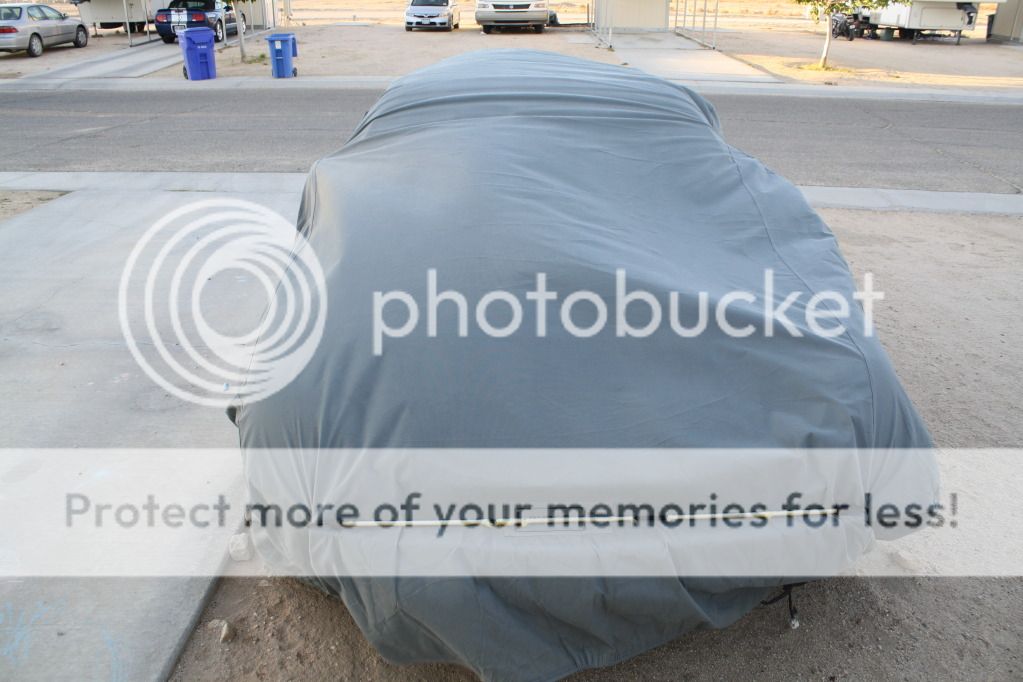

Picture time, as promised:
a picture capturing my sploder, and the car that this motor will ultimately go into, I know, the cover leaves a lot to the imagination, but that comes later.

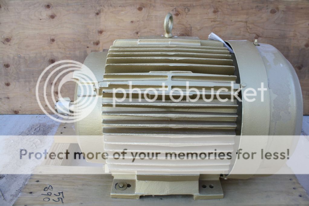

this is the motor I wanted to get, attatched to a pallet, it is BIG.
High drag, low speed LOL but 40 HP WHOO HOO!
oh, yeah! takes up a whole doggone pallet by itself.

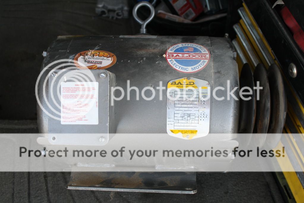

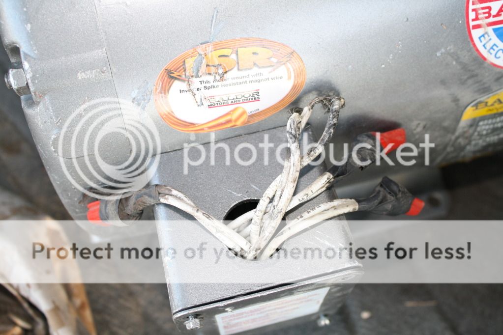

a 10 horse motor 30-28/14A 208-230/460V 1725rpms baldor motor, freebie, got it from the scrappers before they pulled it from a dumpster.
the whole pic, in the back of the sploder
gotta figure out how it is wired, looks like it couldn't handle more than 25A though, pretty low guage wire. I would like to seek to have it re-wound for more efficiency, and changed/balanced to rotate faster without detonation "tee hee"

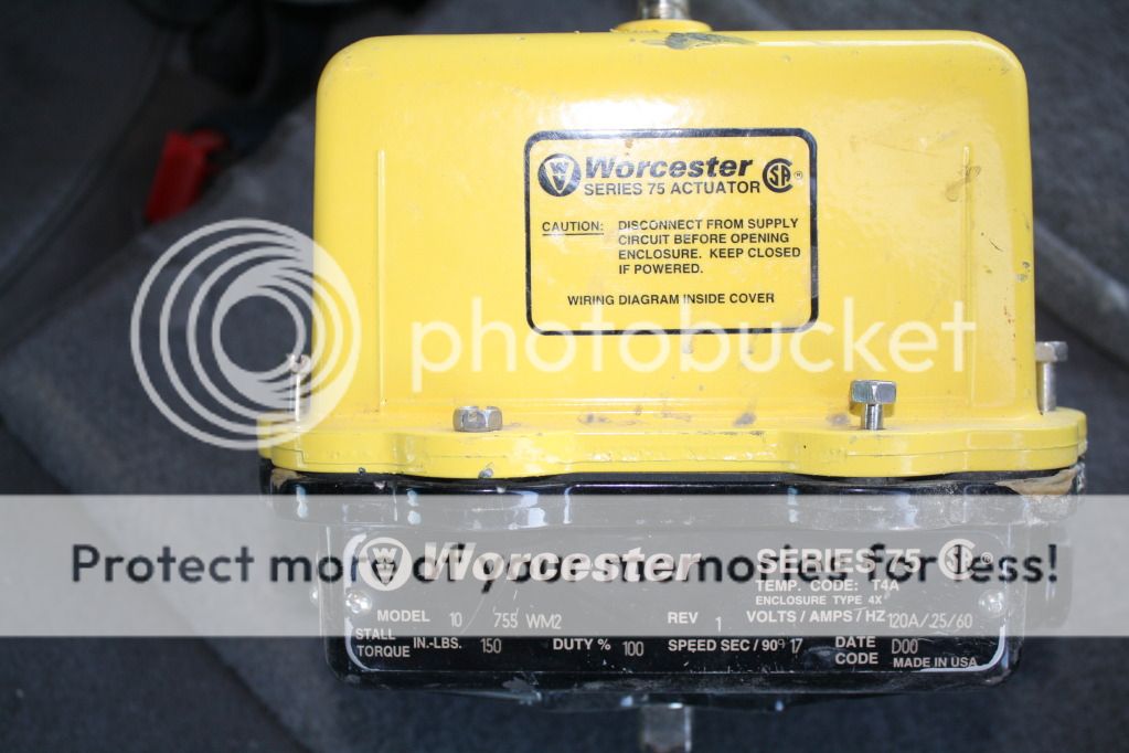

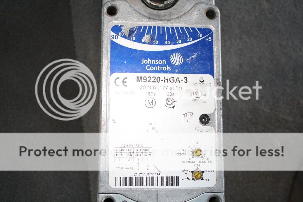

another freebie
another shot
yet another freebie
interesting, well that is all for now. I have more to come, motors that is. anyone interested in getting one can pm me later. There is new construction, and the old compressors are being replaced "hint: that is where these motors came from"

I have a 10HP baldor from the pictures "the gray one" specs are listed above, I can procure more motors, and am currently in the process of doing so.
