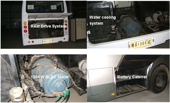

Anybody actually seen or used this (new?) AC motor/controller combo? I see the Greenstage guys have a good history here, but this seems to be a first for them, and beats out the current HPEVS Curtis/AC50 combo by a good margin.
Thanks to efan for pointing this out!
