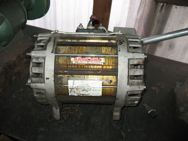

Hi All,
I went and visited a forklift today at lunch.
It is a Raymond 36V stand-on model.
It is in working condition, but has no battery pack.
It has 2 motors, a 7 inch diameter by 9 inch long motor for the hydrolics, and about a 10 inch motor for the wheels.
It also includes a 36V - 65 amp charger.
It costs $500, and I have to get it out of there my self.
Here are some photos, I will post more later. It's sounding pretty good, but I have no idea how to move this thing! I think it weighs about 4000 lbs!
-Ben

I showed the photos of the forklift to my friend last night. He is an engineer for a manlift company.
He told me that the motors look pretty good. They appear to be good quality rebuilds, so they have had the cleaning, bearings re-done, etc.
He said that his company uses 9" Advanced DC motors running at 48 volts for their lift trucks.
He also recognized the charger. I don't remember what brand name he said it was, but he said it was a good one, and that $500 would be a great deal on the charger alone.
He also mentioned that because the motor has those big, open view ports for the brushes, the the motor will need to be protected from the weather with a belly pan or some other cover or enclosure.

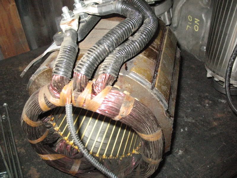

Twilly
A lift motor can usually be over volted (data tag rating) 2 to 3 times with 120 volts being used alot already. You do have to advance the timing 7 to 10 degrees depending on many, many, factors. I'm still recouping from my trip to Electric Dragin this weekend and hope this answers enough for now 8^)
Ben
Those 570-215 motors are a good motor and Advance still makes a current version (at least beyond that Prestolite version). It's a short 9" motor and if you could strech it out it'd be very comparable to a Warp9 or ADC9. At around 80 lbs (from memory) it's about half their mass though, so you'd need a pair to equal a "standard9".
The one problem is, that motor has a small commutator and it isn't a "heavy duty version" which had a bigger brush (the only difference). I could get you the HD brushes and brush rings and you could pop-rivit it into the plate. It'd make a huge difference in it's ability to take current. The biggest problem with this motor like I say is the small comm and brushes, as even the HD brush for this motor is the same brush for most the 6.7" motors that Prestolite made. So even though this motor has the 80 lbs mass lower limit met, it's 4 brush setup is mismatched to it's size if one looks at a 6.7 or 7.2" motor that weighs 80 lbs but has a longer comm and 8 brushes. This is a motor that I've been curious about as to how it'll do. It's my opinion that it's better suited for a motorcycle or three wheeler than a car due to it's small comm, I believe it doesn't have a fan either and would have to be blower cooled. My brain is melting fast and I hope this answers enough for now as well 8^)
I couldn't find who asked about terminal numbers. Two posted motors only run one direction and are pump motors, unless they are a per mag which switching the cables would make it reverse. 4 studded motors are usually drive motors (they do have 4 term'd pump motors, but rare and are just motors that could have been used for either a CW or CCW rotaion pump. Series wound motors have thick, corse, field windings. If you see thin wire, it's a sep-ex or compound wound motor.
Dan
