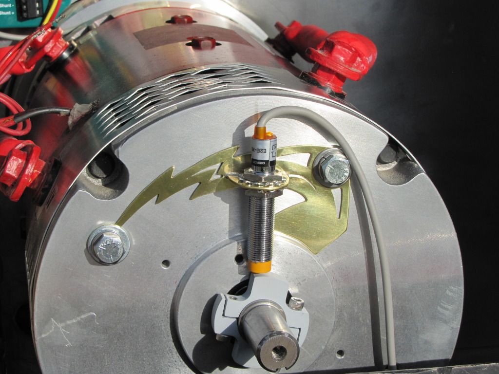

There's no need to use such long bolts. The aim is just to produce two pulses for each rotation. You could make the bolts much shorter and move the sensor closer to the shaft to reduce the risk of unbalancing your motor. If the heads of the bolts are closer to the shaft it will also increase the duration of the pulse, which will make it easier for the controller to 'see' the pulses.
Here's a pic of my setup.
Thanks for the input,
The two bolts are accurately drilled & tapped into collar aposing each other and are of equal length so I think balance of motor should be fine.
The reason I made the set up with bolts of this length was to create a big enough diameter so the soliton 1 controller can actually count the pulses at high rpm to give an accurate reading. As I understand it, the smaller the diameter the faster the controller has to read the switching and I think there is limit.

No, you haven't got it wrong, you've just met the minimum requirement. As you move the bolt head closer to the shaft you increase the time it takes for the head of the bolt to pass the sensor. It might be easier to picture if you think of slices of pie, drawn from the centre of the shaft to the outer edges of a bolt head. The slices get fatter as you move the bolt head closer to the shaft. The fatter the slice, the easier it is to 'see'.

As I see it the larger the diameter, the longer between switch signals making it more possible for the controller to be able to count the switch pulses at high rpm.
If you make the diameter two small it would eventually become one continuous signal to a controller at high rpm, at some point before that state you will receive inaccurate data, at low rpm its not an issue.
At the end of the day I suppose the best way to monitor whether an rpm sensor set up is working accurately is to use a hand held tacho-meter,
Here is long-bolt rpm sensor result:
Here is short-bolt rpm sensor result:
Which has better resolution and accuracy? At low rpm your tach needle will go THump Thump Thump. It won't be smooth.
We are talking about electronics here. They can handle very high frequencies with no problem. Creating a low-frequency tach output is not necessary or desirable.
I would shorten the bolts as much as possible.
Either way should work though... It is merely a matter of aesthetic and accuracy.
