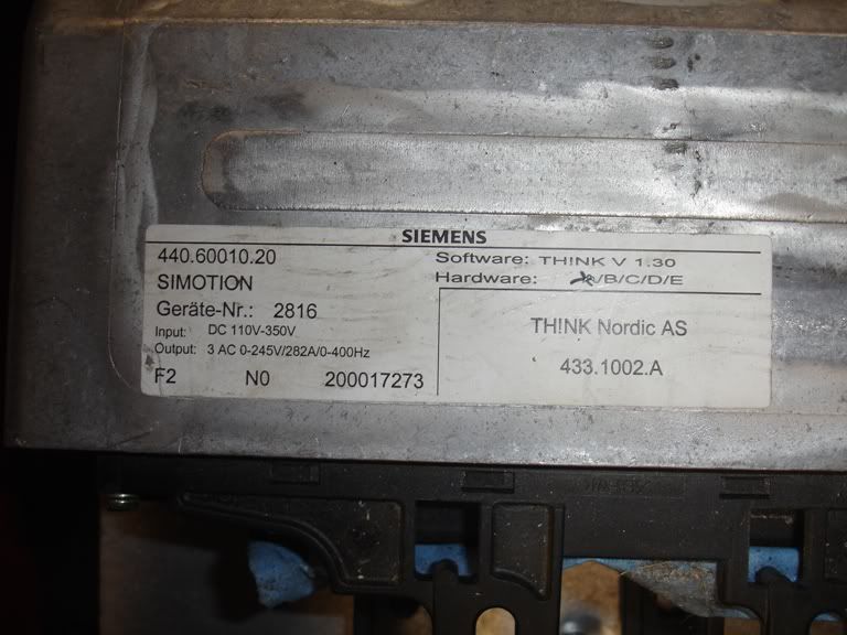

I'm working on a conversion of a 66 mini pickup. It is my first conversion and I have already learned a lot. I have used a Think 1999 model as a donor, and used Thundersky batteries in combination with a BMS from www.elektromotus.lt
The plan is to be ready for summer, but I have one problem. The enginecontroller is set from Siemens too do 7200 rpm, but with the 10 inch wheels on the Mini I will need 9500 rpm. I have contacted Siemens in Germany but they can`t help me (refuse) Is there anyone on this forums that can give me any information about hove too raise the rpm ?

Bear in mind that it looks in the photos as if Siemens may have done a
special version of the firmware that runs inside the inverter (looking at the labelling) so it may not even work with the software I'm talking about

I thought SIADIS would have that parameter locked, it is trying to protect
the motor from overspeeding.
If you try to change the number of pulses per rev that the motor's speed sensor sends to the inverter, it might not work well. The inverter needs to know the motor's speed accurately to drive it properly with the variable speed 3phase AC the motor needs. This depends on whether it is an induction motor (might work ok) or a synchronous permanent-magnet motor (won't work at all)
