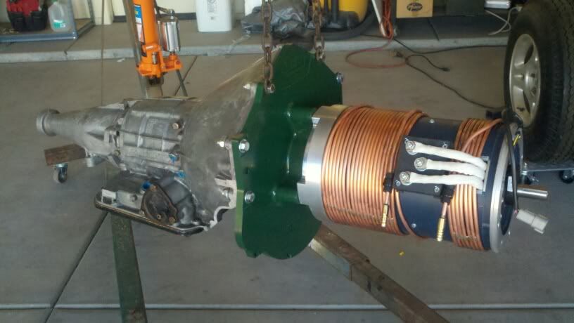

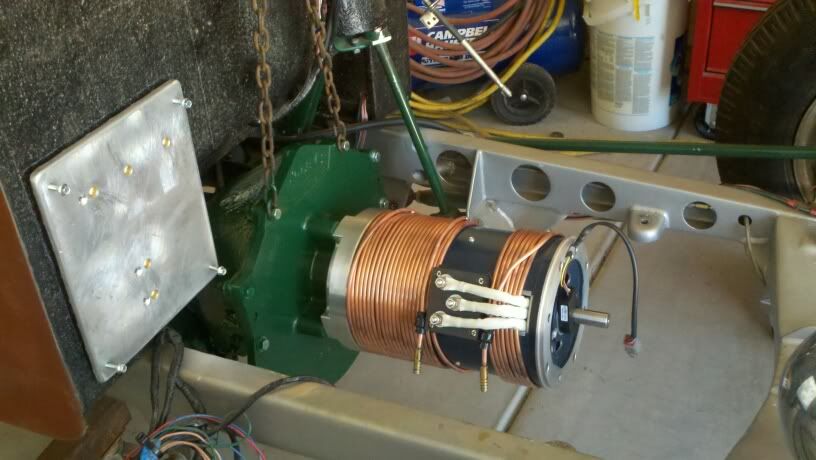

Assembly of drive motor to transmission
Well, the last three days have been very productive. I have been able to get everything assembled and installed in the car as a unit. (BTW: it balances perfectly with the chain shown).
In the car.

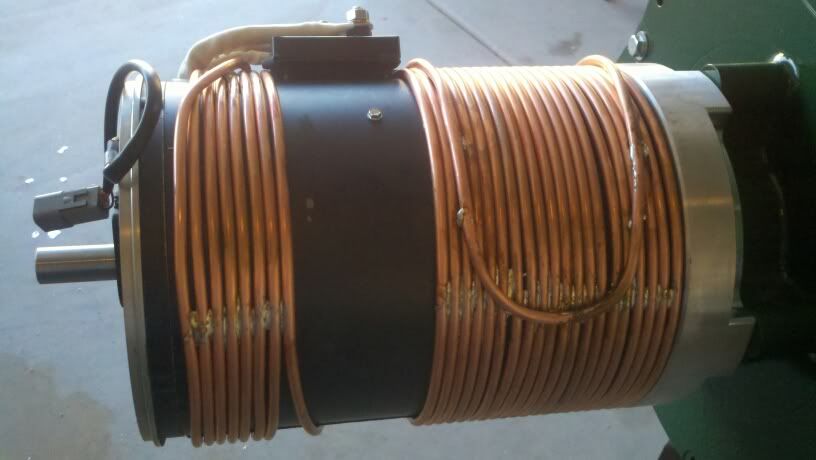

Motor heat exchanger tubing:
I have already had a question about the water cooling tubing on the motor. It is about 76 feet of common 1/4" copper tubing.
RIGHT SIDE:
The motor was suspended vertically from the drive hub with a chain.
The tube was anchored,to start, to the electrical wires with a Zip tie. Then wound tightly to the motor. It took two strong people to keep it tight. Horizonal might have been better, set on "Vee" blocks. The tubing was then anchored on the loose ends with two "P" clamps set under the electrical terminal support block screws. (Top pic)
LEFT SIDE:
I ran two lines of solder down opposite sides (shown in both pics) and at both loose ends for support. The soldering had another side effect: It shrank the tubing even tighter to the motor housing.
The hose barbs were sweated to the ends. The tubing cleaned and clear coated two coats to retard corrosion.
1 year later edit: The motor cooling effort only reduces the temps. from 62C to 55C. Looking back, I would only do it if I was seeing motor temps over 100C.

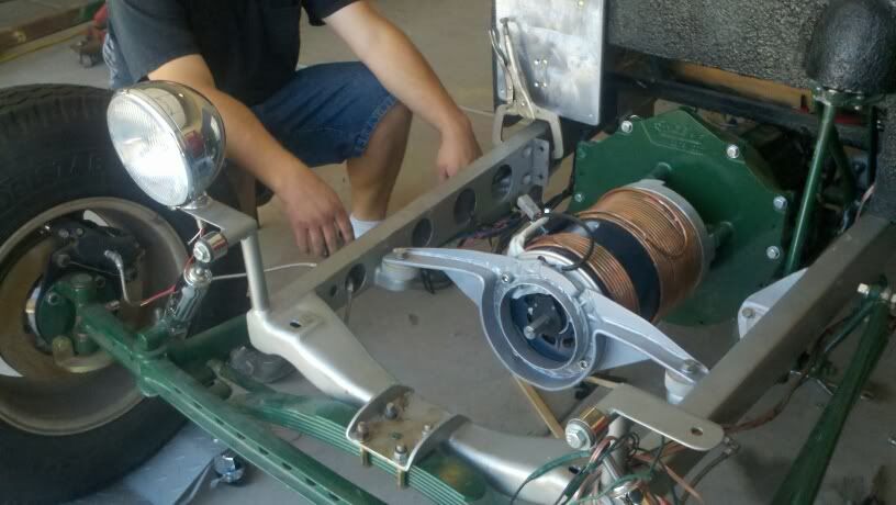

The drive unit is bolted to the transmission crossmember at the rear mount. The front end is held to height by a floor jack and centered in the frame. Measurements have been taken, mid and front mounts will be fabbed up.
I have decided to assemble the car in a "Mark 1" state (meaning not all improvements will be done at first). Nothing will be water cooled to begin with. That way it will let me get a set of DATA for the transmission temp, Motor temp and controller temps without any special treatment. Then I will phase in the water cooling circuits one at a time. I will wind up with some great before and after data to compare.
I simply plugged the transmission cooling ports with common 1/8" NPT plugs. After all, some applications were factory air cooled to begin with and I will not even have the torque converter to make heat. My oval track experience indicates the temp range without a converter is somewhere between 140 and 190 Deg. F. This lets me use my existing engine water temp guage for the transmission oil temp. I just retapped the pan threads to 1/4NPT and bushed it 1/4" to 1/8" to screw in the sensor.

8,155 Posts
Do you have the means to reprogram the controller for hall effect?
I'll be interested in seeing how your water cooling for the motor turns out, but I don't think motor heat has ever been an issue for the HPEVs systems considering the limited power of the controllers. Of course you're in the desert so...

I am a 60 year old desert dweller and am very aware of vehicle heat issues and believe there is no such thing as overkill. LOL
I am interested as to the differences between dry and water. It will be entertaining.

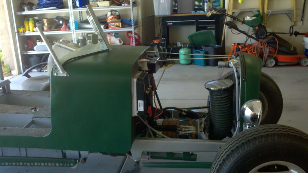

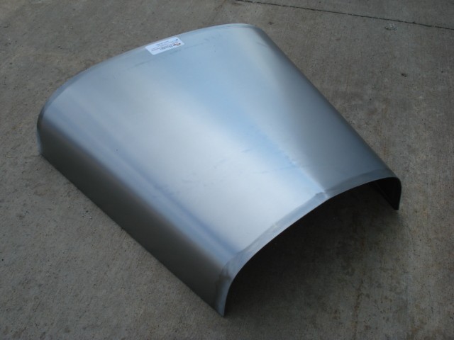

I am more concerned about that motor air intake facing forwards, hanging open 2 feet behind the front axle and so close to the ground...dirt...water...
I have a front motor mount plate that has a 6" diameter flange on it so I can clamp on a 6" I.D. flex tube and get air up high under the hood.

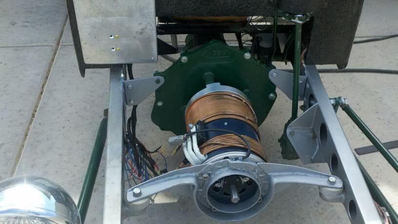

Some progress. This is the rough unpainted front crossmember/ motor mount. It sets on my original frame mounts. It incorporates a 6" flange for a flex tube to run the motor intake air up high out of the dirt and wet.
Tomorrow, I plan to put my speed o gears and drive cable spindle in the trans. that will allow me to permanently mount the power unit and then make a cardboard template of the mid mount at the bell housing.
Next week the drive-shaft gets cut down. Mid mounts made and controller mounted so wiring can begin. I have to cut open my existing harness to redo it from ICE to EV configuration. The controller harness is awesome as-is.

OK, More progress. Saturday was good to me. I was able to get in 8 Hrs. of work before I was driven inside at 104 Degrees. It will be 110 by this afternoon, tomorrow and tuesday.
This is what it looks like sitting in the car permanently. I am making the mid-mounts at the bellhousing in this Pic.
The transmission speedo gears are installed and everything is bolted down.
When I look inside that motor and see the tiny clearance between the armature and fields, I can not help but wonder what dust and moisture would do over time. This is the plan to keep clean air supplied to the motor.
A 6" duct to put the air intake up high under the hood out of the dirt and water from the road....Maybe an air filter too... Or am I just paranoid?

Hi Tat: i am currently lookingfor a decent 6" ducted fan to go inside the flex duct to assure an adequate air flow. Especially when there is an air cleaner.
An AC50 has a small radial fan at the drive end. It depends on the ram air effect of driving to assist it. A tube blocks that air and must be compensated for.
