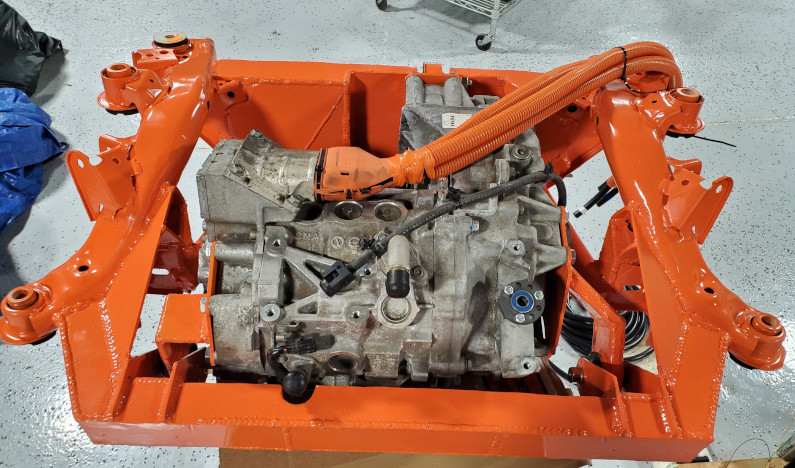

Inductive auto put a 1st gen leaf motor in an EV RX8 rear subframe (pics at bottom). From what I understand, that is interchangable with a NC miata subframe.
That's really helpful to see, thank you! I wish they had more photo though. But from what I see, they had no problems with enough room. But I would be working with the older style subframes and my mileage may very. Also interesting how they used the old-style Leaf inverter and mounted it upside down.

I might be able to avoid welding to the original framerails by doing something like this:
This is a first-gen Mustang that somebody adapted a Jaguar IRS to. He made auxiliary frame railes that bolt to the leaf spring attachment points, then the crossmember attaches to the new framerails. And then the Juaguar IRS attaches to the crossmember.
While I still had a Miata in my driveway, I took these measurements of the rear subframe:

First up, a 90's 240sx or 300zx subframe might be a better choice. It would be too wide for me but look how roomy it is, I bet I could chop it to the width I need and still fit the leaf motor. And the Nissan bolt pattern is just what I need too.
HOWEVER! There might be an even better idea!
The fine folks of the internet, this forum included, has informed of the concept of the De Dion Tube. Basically its like a live axle but with CV axles on the outside instead of the inside. This is what Ford used for the 2000 Ranger EV.
Here's an example from "some crazy guy in Australia" reportandly [edit: no, its actually from an EV West engineer here in the states].
I'm going to need a lot more information and to see the hubs, but this could be just perfect.

Well I did some very crude... rendering?... and as I suspected, the Leaf motor will not fit between the lower control arm pivot points.
While the overall width may be correct, the Leaf drive unit (motor plus transaxle) is not symmetric like that - the motor is on one side (right side in the original installation) with the final drive on the other side. That can be important to inboard CV joint locations and axle lengths.
I found the video that explains everything I need to know for the De Dion axle. Looks like it was made from a EV West engineer.
So I will probably just copy this the best I can. But there's a lot of time between now and when I actually get started on this, so I'll probably change my mind at least 10 times by then.

The beauty is the Dedion member may wind up being a straight tube...
We'll just agree to disagree on 30 degrees being a healthy angle for a CV joint. You gotta remember this is when loaded just right as well. Light or heavy in the back, there's a vertical component to the angle in addition.
