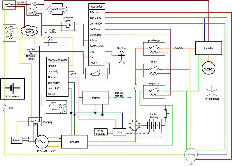

hi i looking to do up my 63 bug but now want to put a leaf motor and inverter in her and attach it directly to the trans axl with no clutch i will just drive her in 3rd gear and use reverse gear i have been looking at a Thunderstruck vcu as controller with a Curtis ET-126 throttle connected to original cable is this set up a good plan or is there a better plan out there thanks fish wellington nz
You're fine either way! All you need to engage reverse with the Thunderstruck VCU is a switch to change from forward to reverse. If you want to trigger the reverse lights, you'll need a special relay that can trigger a 12v circuit with a 5v signal (I found one on Amazon for US$5).
thanks but 1963 bugs don't have reverse lights ..old school baby ....
