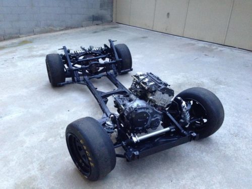

I have a 1964 Honda S600 that I have modified with a motorcycle engine (2007 CBR1000RR) and I am planning on adding an electric motor to make it a hybrid drive. I will be using a QWC/EVDrive EVD35 system running directly to the driveshaft after the motorcycle engine. It will be running at 96V with a Sevcon size 6. I haven't put much thought into the battery yet; I'm still working on packaging and engineering the motor and drivetrain connection. It should be a fun project and I'd like to hear feedback from some people who have more experience in this area than I do. Pictures and more info to follow, if this one makes it through.
1 - 15 of 15 Posts
Alright, cool. :cool:
So the story goes like this: I have this motorcycle powered 1964 Honda S600 (seen here: https://www.youtube.com/watch?v=UsbfzmPCYX4) There are a few things I don't love about it, mainly that it doesn't have reverse, but also it could use a few extra horsepower and I'd like to re-do the driveshaft layout. It occurred to me that I could solve all of these problems by adding an electric motor to the powertrain. I've also been wanting to do an electric vehicle build for a while and this seems like a good introduction.

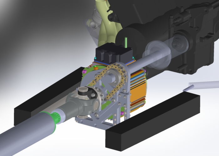

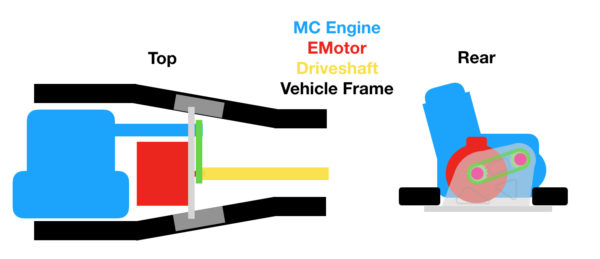

Because of the motorcycle engine location and packaging space, I'll be running the electric motor directly to the driveshaft and the motorcycle engine will be connected with a chain drive to a sprocket on the driveshaft. Max driveshaft RPM is 6500. I have a lot of fabrication and engineering experience, so I'm not worried about the mechanical side.
I'm not sure how much battery I'm going to need; I'm not looking for range so I suspect I will be getting the minimum battery size I need to output the peak 660 amps at 96 volts. Any thoughts on where I should be looking for high discharge current batteries? Used (cheaper) batteries would be preferable.
I'd also like to know if anyone has any experience with this layout: a hybrid setup with the electric motor after the transmission output. I suspect there are some requirements and, uh, nuances of this setup? Any other thoughts are appreciated.

There isn't a whole lot of space for the motor, but It should fit neatly where the original transmission was (I'm using the integrated motorcycle transmission). If I mount the EMotor on a frame just behind the MC engine, and have the driveshaft mounted directly to the Emotor, I should be able to run a short shaft to a sprocket and get the MC engine power to the driveshaft through a chain. Not ideal because I'm using the chain on the more powerful engine which will give me more total parasitic losses than if I did it the other way around, but otherwise this seems to be an effective and reasonably priced approach that mostly can use OTS industrial components (keyed shafts, sprockets, etc).

I've done all my mechanical design for motor mounting and power transmission and I think I'm happy with it. It's all packed tightly into the transmission tunnel.
