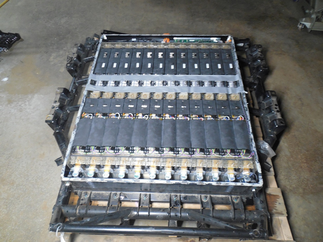

Feb 2020: Bought a Tesla/Mercedes battery pack. Originally rated at 36kwh in 12x 7s modules.

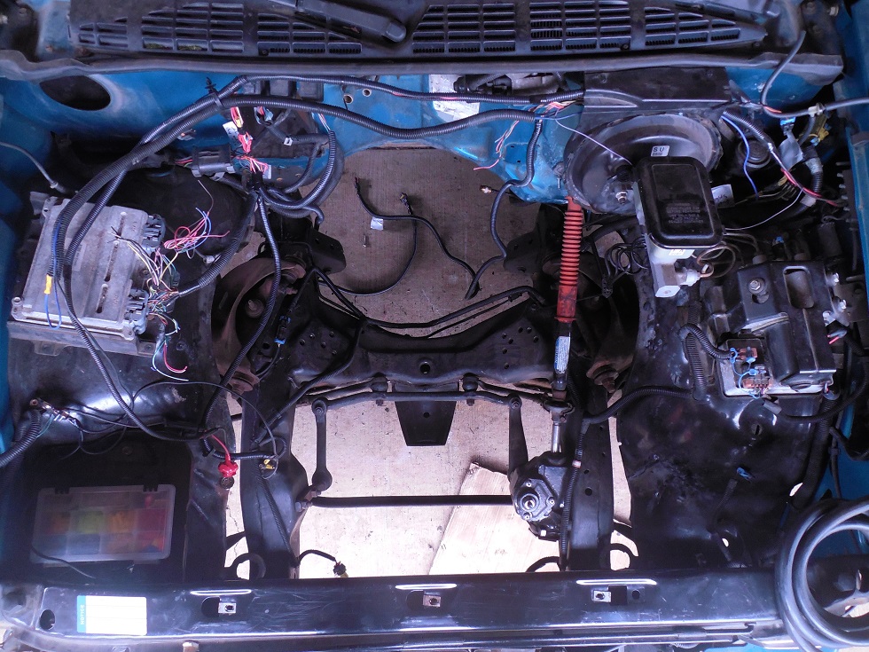

May 2020: Pulled out the ICE wiring and started getting the engine bay ready.
I mounted the brake booster, and stripped down the dashboard.

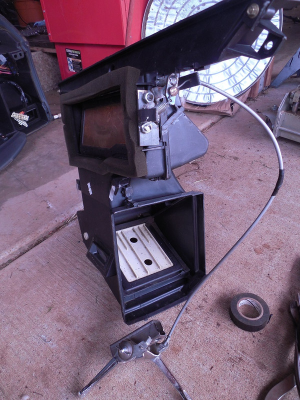

I pulled out the vacuum system that controls the vents, and instead made a mechanical system to switch between the defrost and cabin vent settings.

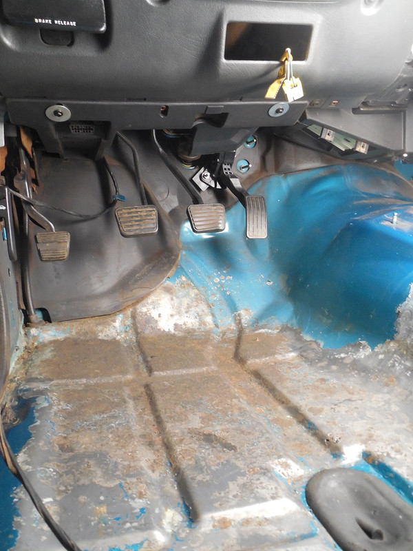

June 2020: I mounted a pedal assembly from a subaru.

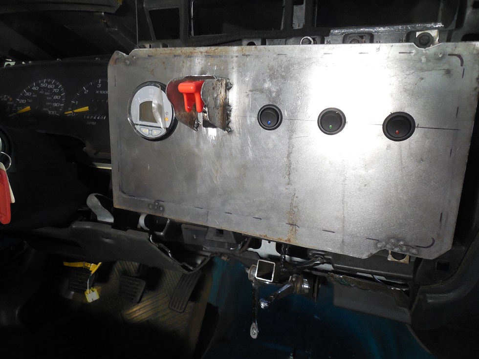

August 2020: I started working on a switch panel for the dash.

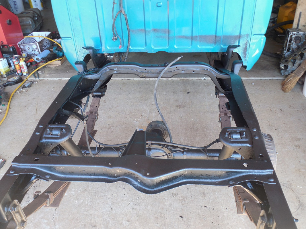

I spent a lot of time today just moving pieces around and trying to figure out how everything was going to go together, so I did not make as much progress as I had hoped. Also, a bolt shortage made it hard to start fitting pieces up to the truck's frame.
The steel components will support wooden sides, and I am including brackets at the corners to mount short sides or some sort of lumber rack later on.
I am building the bed 5' wide, so the wooden side boards will straddle the tires a little bit. My plan had been to make a curved steel fender and make an arched cut-out in the wood to accommodate it. I am thinking I am going to have to do this step at the end, once the modules are loaded and I have and idea of where it will ride. I am wondering, though, how much space should I leave between the tire and fender? Should I load it up with its estimated max capacity first?

I did get the frame for the battery finished today:
The battery box will attach with 10x 3/8" bolts, and then the sub-frame bolts to the truck in 6 places. I am only using the fore and aft bolting flanges of the battery box, but it seems like overkill to add another 10 bolts on the sides.

The spring rate of truck leaf springs is usually not a constant - they are designed to get stiffer as they are compressed, which is called a "rising spring rate". This is usually done with leaves that don't engage until the spring pack deflects enough.
For fender clearance I would just assume that at some point the suspension will travel enough to compress the bump stops (the rubber blocks that keep that axle from hitting the frame).

Thanks Brian, I measured 6 inches from the tip of the bump stops (thanks for giving them a name, I really am out of my element) to the part of the axle that they would hit. I decided to leave 7" of clearance to give them some room to compress.
It leaves enough meat in the wooden frame to carry quite a bit of the eventual load. I am a little concerned that the steel frame is too close to the tire in case one wheel rises really high and it leans inward, but I am hoping it will not be a problem, as this truck is not going off-roading or anything.
I realized when I had finished that the steel uprights in the corners should have been 1 1/2" taller to clear the 2x8 decking that Is going to be on top. In hindsight, it would have looked nicer to have gone with 2x12 sides, and recessed the decking to hide all the endgrain... but oh well. My next flatbed will look really sharp.
Next up: I am going to extend those uprights, and then the frame will be ready to prep for paint.

The guy who I got the pack from had numbered all the modules, and provided me with initial voltages and internal resistances. Does anyone have thoughts about how they should go back in? Should I use the original order? Should I try and sort them? Since I am going to be doing 2 strings, should I strive to have both strings have a similar resistance?
In the bottom left you can see the flat (aluminum?) bar that was the positive terminal. I will probably keep that in place, and then make grooves for the 4/0 cable that will split the pack into 2 strings. Its going to be tight to fit 2 fuses, 2 contactos, and 4 BMS boxes in the little channel at the bottom of the image, but I think It will be doable. I have decided to spend the extra money and just have a BMS monitoring each cell-group in each string instead of trying to join them together somehow.
