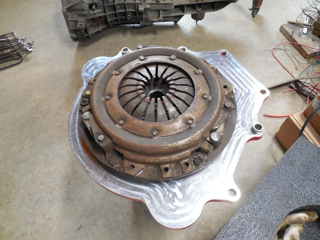

I took the motor in to an electric motor shop, and they popped the hub off as easy as opening a pickle jar! They didnt even need to heat it up. They would have been willing to do it for free, so I was back on track for just a morning spent driving around and some beer money for the very helpful guys down at Advance Electric Motors.

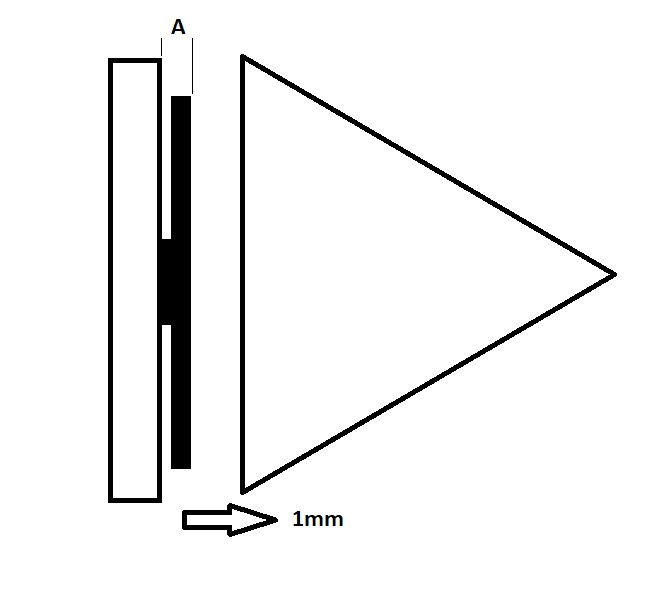

I had measured the critical distance as 21.2mm when I took the motor apart - now I am getting 22.3mm. How precise should I strive to be here?
I would only be concerned if this causes the transmission input shaft to bottom out in the adapter.
It seems like it is generally recommended to have the flywheel resurfaced anytime you have it out of the vehicle, anyway, so should I have it shaved down by about a mm to get closer to my original value? Also, is there any value in having them mill off extra weight, like the gear teeth, for example? I might also put in a new clutch disc, as the one in there is getting pretty close to needing replacement (I think).
Since a clutch lasts at least half the life of a car, I've never replaced a clutch disk more than once... and not resurfaced the flywheel except in the one case that we were also lightening the flywheel.
Yes, although it's certainly not necessary when you have a clutch. Flywheels exist primarily to add rotational inertia; mounting the clutch is secondary. Flywheel inertia smooths out the pulses of an engine, and makes it easier to start off from a standstill without stalling; neither of these applies to an electric motor. Flywheel inertia just stores kinetic energy, making the car behave as if it were a bit more massive when changing speed.
Even with an engine the flywheel is routinely far heavier than it needs to be: I had half the weight taken out of our Honda's flywheel when preparing it for competition, and it still wasn't rough or hard to drive after that.
The ring gear is commonly a shrink-fit on the flywheel - in that case, it can be removed without machining work, and makes a significant contribution to interia.

I am measuring the gap on the engine/adapter plate side, so since the distance has gotten larger I am assuming the tip of the transmission input shaft will have less engagement if anything, right? I am starting to think I might just plan on assembling everything as-is. I am not really going to be using the clutch very much anyway, so it should be fine at least to get this project rolling.
5,750 Posts
I apparently misunderstood what you were measuring, but if the flywheel and transmission are further apart than intended then I wouldn't worry about one millimetre. The engagement of the input shaft into the pilot bearing, input shaft spline space available for the clutch hub to slide on, and clutch fork travel required disengage the clutch will all be affected... and none should care about that one millimetre.

A picture is worth a thousand words. Two thousand words if, like me, you dont really know what you are talking about :)
I measured distance A, from the front face of the flywheel. That gap got bigger, so the whole flywheel is now about 1mm closer to the trans. I see now that my last response probably didnt make any sense, as I was thinking that moving the flywheel would somehow hold the input shaft back, which it wont.
So your original point is valid, the shaft will insert an extra mm, but there is quite a bit of clearance from the back end of the pilot bushing to the shaft of the electric motor. I will measure that depth and compare it to the length of the pilot shaft on the trans - but I think it will be fine.
I borrowed an alignment tool, and started getting the flywheel put back together. I inspected the ring gear more closely, which did reveal that it was press fit on. There is a lip on the top surface - the ring presses on the from the rear, so from above it looks like the teeth are machined into the actual flywheel. I used a torch to gently heat it, and it tapped right off. It will save me a little weight out at the very edge of the flywheel, and get rid of all the sharp edges, so seemed like a good idea.
I am just about ready to mate the two halves together to be hoisted in. I will probably have to wait until next week for the install when I have an extra set of hands (and feet) to get it in place and bleed the clutch. Thanks for all the help with the "car stuff," I am looking forward to being back in my element with the last of the wiring!

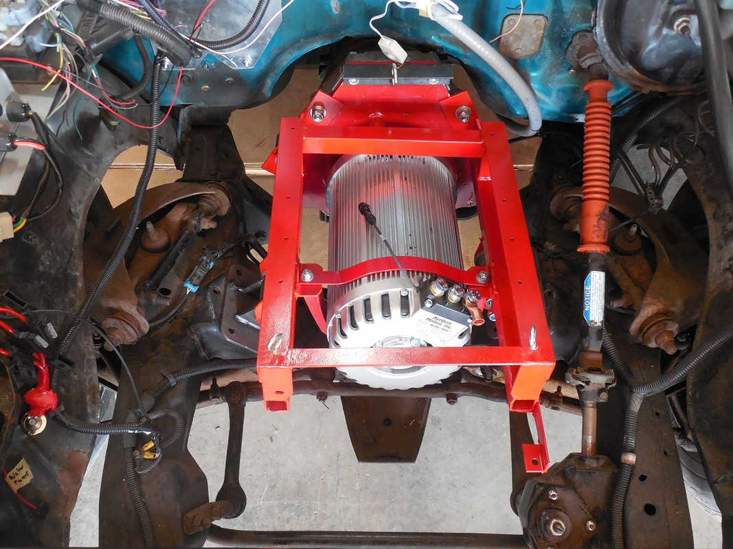

The flywheel is all assembled now
I was able to simply pick the transmission up, and just set it down on the motor, so it was really pretty easy to get them together. Its now ready for installation!
I forgot to check the shaft clearance, but since it went on there, I am guessing it did not cause a problem :). Oh yeah, and I did eventually hear back from the motor supplier. They said that the motor can be supported only from the face, as long as the transmission is mounted in such a way that it can resist rotation. They also said that it was not a problem to mount the back end, and even sell a clamping band that looks like a much less crude version of what I built.

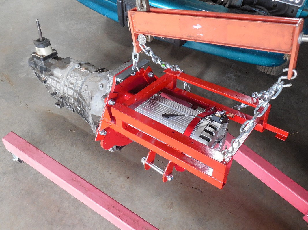

A clamped-on support won't help with torque - all of that must be done by whatever is bolted to the motor's mounting face. In this case, the rotational constraint (torque reaction) is provided by the cradle and the engine mounts, which is fine, although I'll note that the torque is the motor torque multiplied by the gear ratio of whatever gear the transmission is in - it's substantial.
The cradle isn't really designed for torque - ideally it would be better with diagonal braces on each side of the cradle, to lower on the adapter plate. Sorry, I should have mentioned that before it was painted...
Haha, its sure not :)
I had not realized that the gear ratio would multiply the torque, but I guess that makes sense. The motor is rated for 173 ft-lbs, and if I plan on driving it in third gear, the ratio is 1.67 (I think). So thats about 290 ft lbs, which is acting around an approx 7" radius, So there should be 168lbs of force acting on the cradle, or 84lbs per side. First gear would obviously be a lot more, putting almost 300lbs per side - but doesnt this assume full throttle?
As far as fortifying the structure goes, there isnt a bolt hole farther down the adapter plate, that is the lowest one. Since I am not really capable of designing it to resist some given force anyway, I am pretty much limited to trial and error. If I see broken welds, I will simply have to redo it, I suppose.
Close... if you're driving a shaft (or turning a wrench) you use the radius and get 290 lb-ft of torque divided by (7/12) ft of lever length or 498 lb of force; if the motor and transmission were mounted by bearings around the input and output shafts and all that kept the case from spinning around was an anchor 7 inches from the shaft centreline this would apply and there would be almost 500 pounds of force on that anchor, tangentially.
In this case you are supporting from two points so if they are 14" apart that's 290 lb-ft of torque divided by (14/12) ft lever length, or 249 lb of vertical force on each side (one side in addition to that mount's share of the weight, on the other side pushing up against the weight). Yes, first gear would be about double the torque (depending on your gearing).
Yes, that's all at maximum motor torque, which you will only see at low motor speed and full accelerator setting. You should be able to set a lower current limit in the controller if this is too much for your structure; ideally there would be a current limit for each gear but of course the controller won't have this and doesn't know your gear selection anyway.
Motor mounts are no joke. 😮 Have you ever seen a drag racer (with live beam rear axle and suspension, not a rail dragster or funny car or anything with independent suspension on the driven wheels) twist as it lifts the front end at the start? That's all reaction to transmission output shaft torque, transmitted through the engine mounts, then the vehicle structure, then the rear suspension. They routinely lift one front wheel off the ground and unweight the opposite corner rear tire enough that without a locked differential that tire spins.
That's not surprising, since there is only engine block to bolt into from roughly the crank height and up. The alternative is to brace upward - it doesn't matter which way you go. Basically, those small triangular gussets on each side should just be larger, spanning the whole height between the two bolts used on each side, and extending horizontally as far as practical.
The cast aluminum adapter plate is pretty substantial, so even though there is no bolt to the transmission near the bottom a brace could still go to the plate.
Of course most people build their transmission and motor mounts with little understanding of the forces involved, and seem to generally get away with it. :)

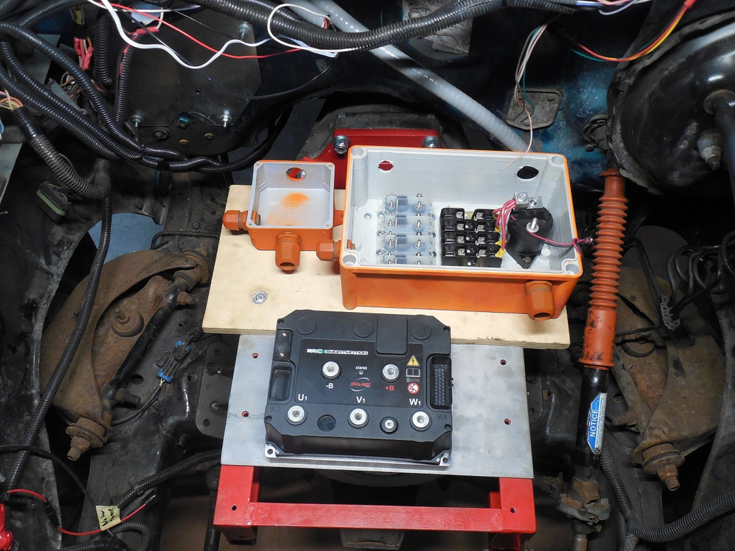

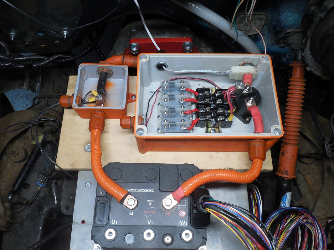

I got a little work done on my high voltage stuff today, and it is starting to come together.
I cut the conduits to length for my main power leads, and have spray painted them orange. Once they are dry I can get the 2/0 cable run back to my main contactors. Up front the big contactor is for the controller, and then 4 smaller ones will run the cabin heat, DC-DC, precharge circuit, and coolant heater. All the high voltage negative wiring is split off into the smaller box on the side. I was hoping to be able to keep all the wiring nice and neat, but I suspect its going to turn into kind of a rats nest when all is said and done.
Got the clutch bled today too - the fluid was very dark, so I wound up cleaning out the reservoir and flushing quite a bit through to try and clean it up some.
Anyway, lots of fiddly wiring to do now, but I will keep chipping away at it... I need to sit down and read over the manual for the X144 controller and figure out which of the wires I will need, and which ones I can ignore for now. Its a rather daunting looking wiring harness!

Main leads are in place, so I am wired up as far as the controller now. I still need to make the engine leads, and then I can start in on the big controller wiring harness. There will be a bunch of detail work to do, so I suspect this next part is going to take longer than I think. Still, It feels like the end may be in sight. I am excited to get my controller fired up so that I can finally see these tires move under their own power!
257 Posts
Discussion Starter · #100 ·
Made my motor leads today - I am annoyed by the way the controller is laid out. I wish they had swapped the layout so that the leads were not all twisted up. Maybe there is a technical reason to do it this way? It seems like it makes the logical configuration of having the controller above the motor harder to wire up neatly.
I pulled my high voltage wiring for the DC-DC converter, and the coolant heater (which is not installed yet). I realized today that I have the wrong size of fuses for my fuse-blocks, so I will need to get the right ones ordered before I can test anything.
I also checked and labeled all the wires coming out of the main harness - someone had mentioned they got one with a few mixed up colors. Everything checked out, though, and it is looking a bit more manageable with all the wires I am not going to use set aside. I have probably at least another mornings worth of wiring to do, but then I will be ready to bring the controller online.
