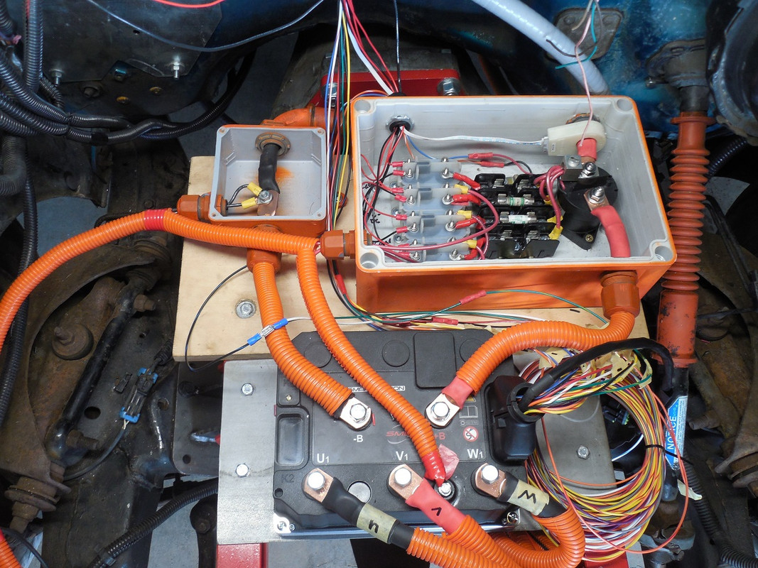

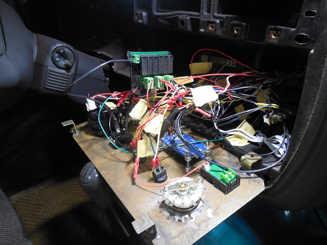

I got the controller wiring all wrapped up today - and ran the wires for all the contactors. Tomorrow I should be ready to connect the main power leads, and get the controller programmed. With a little luck, I might be able to drive it down the driveway.

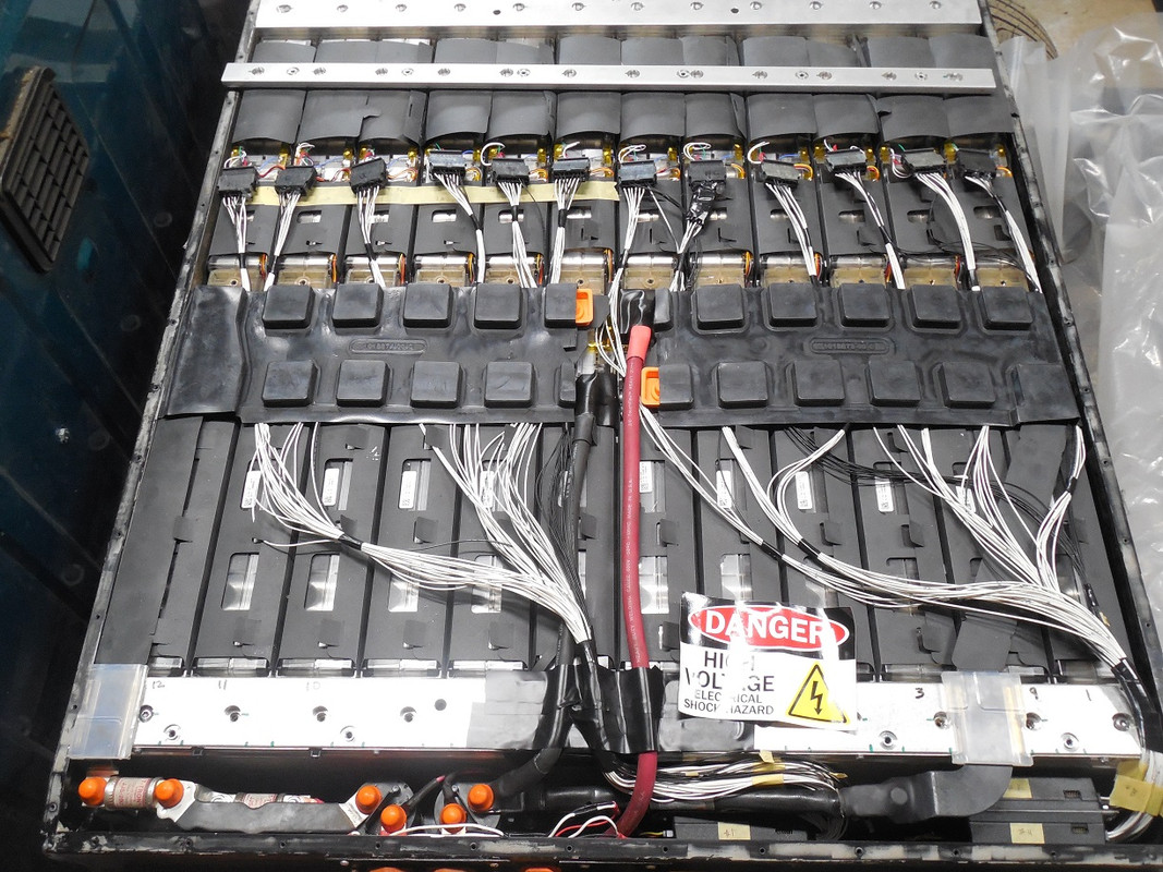

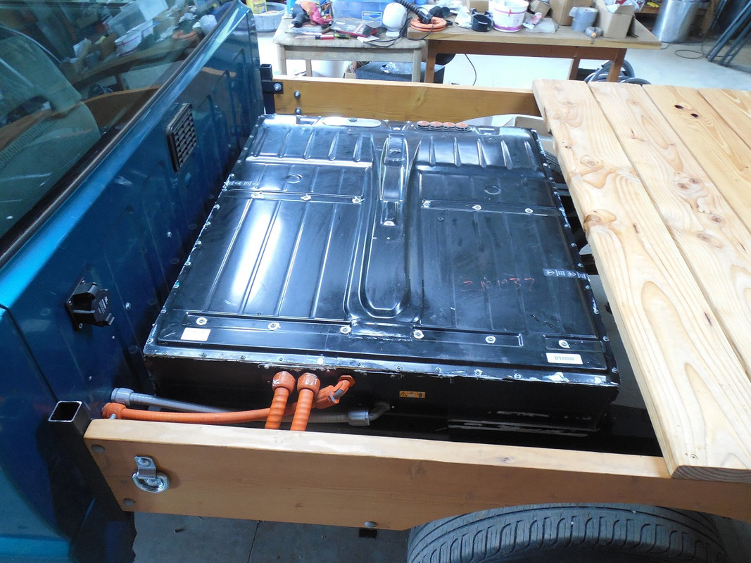

I wired my batteries together today, which I was sort of worried was going to be dramatic - but they were close enough in voltage that there was not even a spark when I went to connect them.
All my wiring for the controller checked out okay, so I went ahead and fired it up and got it programmed. My brake booster is still not operating, but I did manage to get the truck up to 10mph, and that did feel like something. The problems started cropping up pretty quickly, though, which put an end to my enthusiasm. It appears that the clutch does not fully disengage, which is annoying. I need to remap the throttle, as it only gives me about enough juice to get up to ... 10mph. I backed it into the garage to go ahead and get started charging it up, only to find that the charger now no longer works. I also checked the 12v system, and also found that the DC-DC converter is not charging the battery. So anyway, I still have a lot of work to do, it seems.

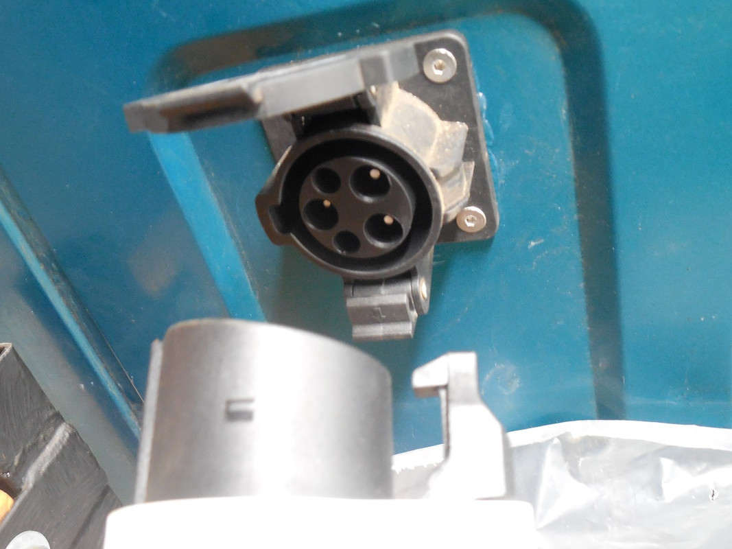

I took a little time off to work on other stuff, and the guys at Thunderstruck pointed me in the right direction to get my charger figured out. It was actually just a really stupid mix-up - I inadvertently put the male part of the J1772 plug on backwards after opening it to fix the wiring. Here is the correct way - the little latch slides up the ramp and then clicks down into the groove, letting the charger know it is firmly latched
With the plug end reversed, everything still works, the plug slides into place, but there is no groove for the latch, so the charger wont turn on. Anyway, there were a lot of little hints that I somehow managed to ignore, but now its working again. It can only push 1500w on 120v, so it is going to take a while to get a full charge. I ran it for a couple of hours today while tracking down a problem with one of the bulb holders for the turn signals.

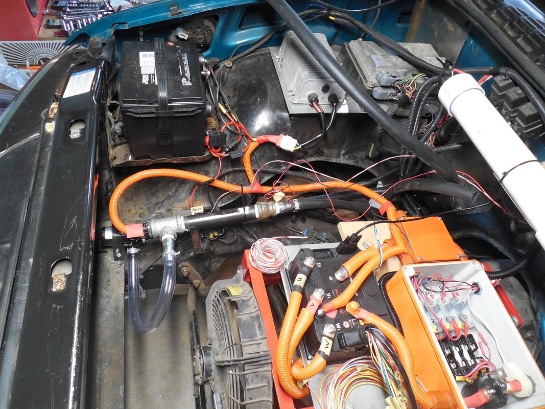

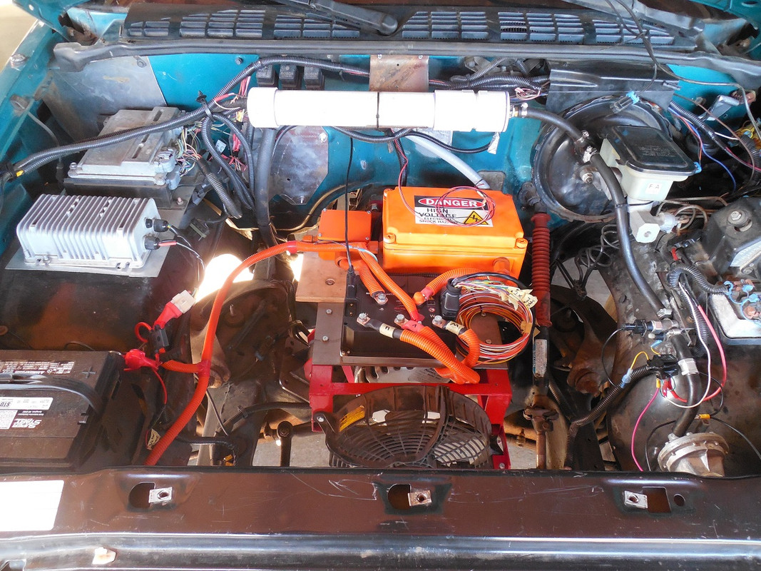

I got my brake booster squared away today. The sensor that came with the kit was causing relay chatter, so I ended up making a time delay relay controller with a resistor/capacitor pair driving a transistor. Now the pump runs for about 5 seconds after the pressure drops to the right value; which makes sure there is enough vacuum for it to stay off. I plumbed in a small reservoir made of PVC pipe, and everything seems to be working. There is a slow leak somewhere, so the pump does come on occasionally for no reason, but I can live with that.
I remapped the throttle profile, as the default mapping only gave me about 50% with the pedal to the floor. It now has considerably more oompf. I did play around with feeding it 200amps in second gear, and it takes off pretty well. Here is a quick video of it going down the driveway.
