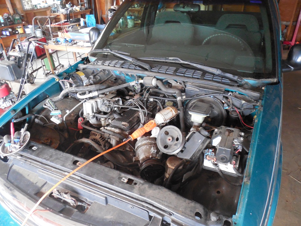

I just picked up my donor vehicle today; a really clean '96 with a blown head gasket. I will post a picture when I get a chance.

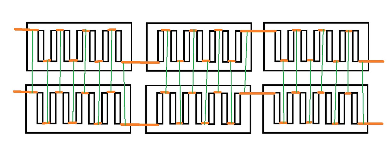

With 444 cells per module, and a string of 6 modules that is 2664 cells for the BMS to keep tabs on.
No, the BMS is not aware that there are thousands of cells (7104 among the 16 modules in this example). It monitors only the groups of parallel cells, so every EV with the common battery configuration of 96 cell groups in series monitors only 96 voltages and a few temperatures (one or two temperatures per module), regardless of whether a group has a couple of large cells or dozens of small cells (74 in the modules from a Tesla 85 kWh battery).

Not "the other 95" (of the 96 groups in series), but the other 73 of the 74 in a parallel group within the module.
Yes, sorry I misread the earlier post and was thinking that the standard was 96pXXs, but yeah, i was talking about the parallel cells within the cell group. (I was about to gripe that you cant read the old posts while formulating a response, then scrolled down and found them. :)
So basically, a 5.3kw 22.8v Tesla module out of a model S, which has 3400ma cells in (74p6s) is going to look to the BMS like it was 6 cells in series, with a capacity of 251.6AH (74*3.4), right?
So complexity wise, 6 of those modules in series would be electrically equivalent to 36x prismatic cells of 251AH capacity.
That helps make it seem less daunting. I am still a little worried about thermal run-away, but maybe after doing more reading it will seem like less of a problem. I will try and find some threads with info on thermal management.
Yes, and yes.

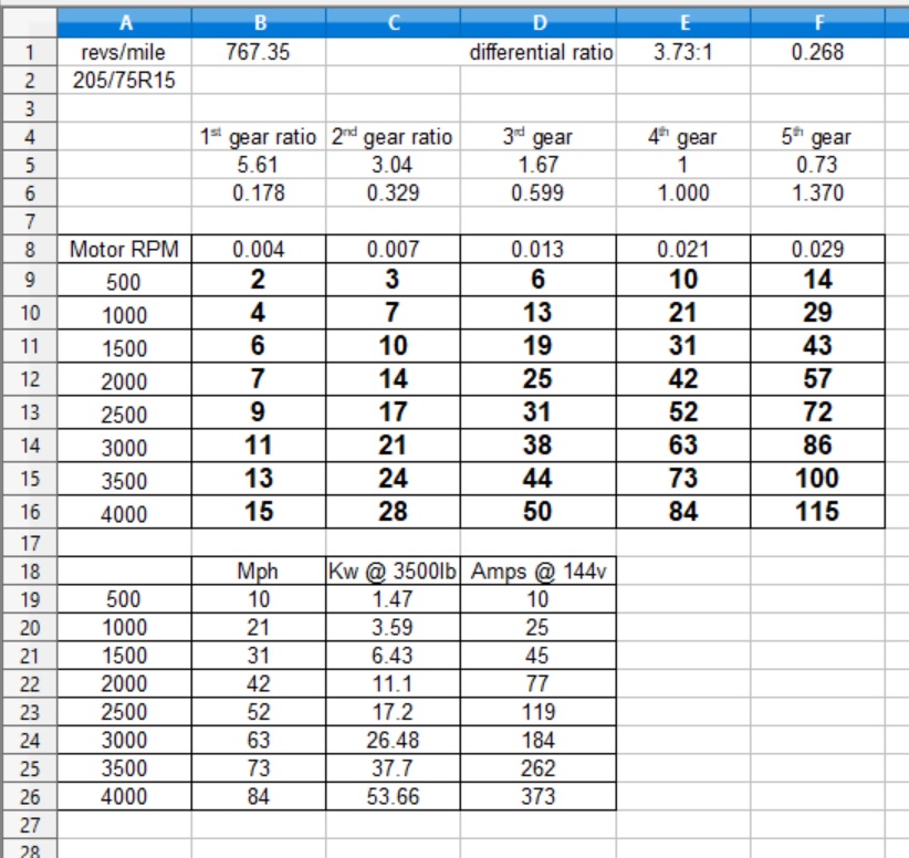

The hyper 9 puts out 162 ft/lbs, and 120hp (this is probably its peak output?)
The Warp 11 only does 135 ft/lb, and is rated at 32 hp continuous.
The price for the Hyper 9 is 4300, but that includes the controller, while the warp 11 is 3000 + at least 1500 for a controller?
It seems to me that they are both equally expensive, but is the AC version really wimpy? Am I missing something important in looking at the specs?

My point is that a 9" brushed DC motor, 1kamp controller, and 120v-156v LiFePO4 battery pack is not obsolete.... plenty of power, range, and reasonably simple to build for the average DIYer.
A Warp9 with a zilla 1k controller and 156v battery pack is capable of putting out about 150kw of power for 10-30 seconds.... which is WAY more than you need for very decent acceleration! It translates to 'feeling' like a small-block v-8. The nice thing about the Warp9 versus an 11" or 13" motor is that the max revs are higher (maybe 5000 rpm), so your existing transmission is usable.
AC motors/controllers used in all the OEM evs are more efficient, operate at lower currents, and extend range with regen braking... true... but cost more, are more complex, and operate at much higher voltage which means more complex battery pack and battery management as well as lots of computer/control stuff that may be out of the area of expertise for the average DIYer.
You have to pretty much change your mindset when looking at electric motor specs versus gasoline. with ICE motors you are used to looking at PEAK horsepower and torque ratings, but with DC electric they typical post the CONTINUOUS power ratings because they are thermally limited as they are typically air-cooled.
The good news is that a vehicle on the highway going 60mph probably only needs about 20kw to overcome air and rolling resistance, meaning that a Warp9 is plenty. The peak of 150kw in the example above would likely only be for 10 second 'acceleration' events, limited by your controller output, and then in between your motor air-cools..... a Warp 9 is PLENTY for any average urban/suburban use, trust me on that.

This is the donor vehicle, btw. It still needs a name...
