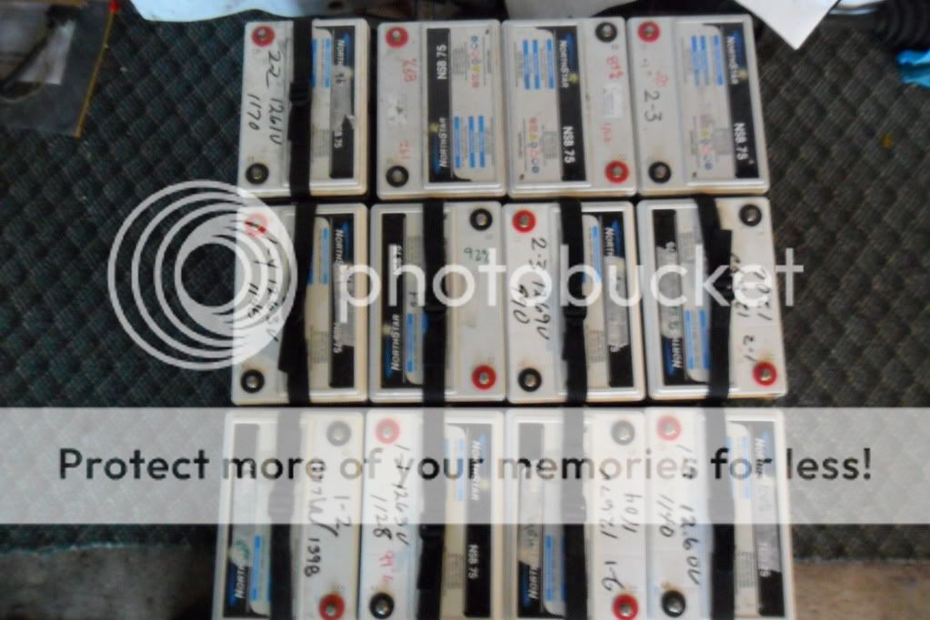

I also picked up a couple used UPS batteries, I will be able to get more shortly.

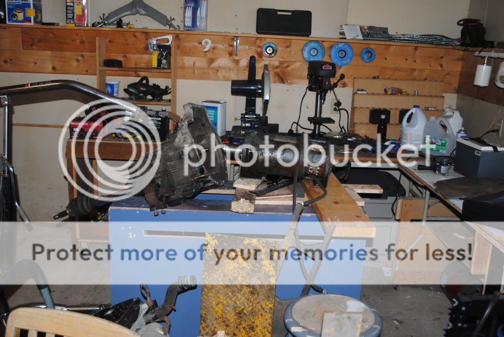

Thanks Major, I hope I can figure it out. I took the motor apart. Heres whats inside
http://i1027.photobucket.com/albums/y338/scottarseneau/DC%20Motor/SAM_0698.jpg
http://i1027.photobucket.com/albums/y338/scottarseneau/DC%20Motor/cecasing.jpg
theres more in my photobucket album.

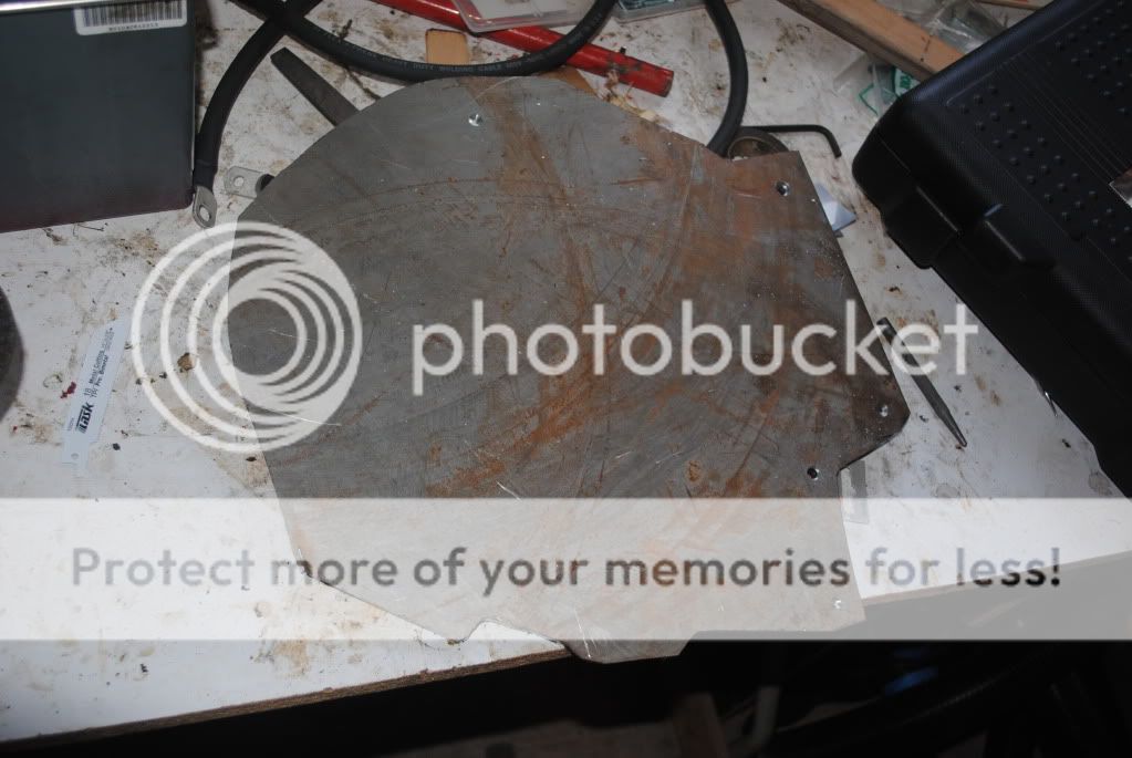

So I color coded the pic of the end cap to make it easier on me, ha ha. Im thinking to reverse the polarity I need to make the yellow terminal connect to the red brushes with no field coil connection, then move the red field coil connection to the yellow brushes. (not sure if thats right, i may have to reverse the field coil connections too?)

I also picked up some 1/4' steel for $10 at a scrap yard. I think ill double it up for the adapter plate. Started chunking away at it with the recripicating saw
http://i1027.photobucket.com/albums/y338/scottarseneau/DC%20Motor/SAM_0713.jpg

Hi Hydro,
Yep, you got the idea. Once you switch the brush connections, field coil polarity remains the same. No alterations required.

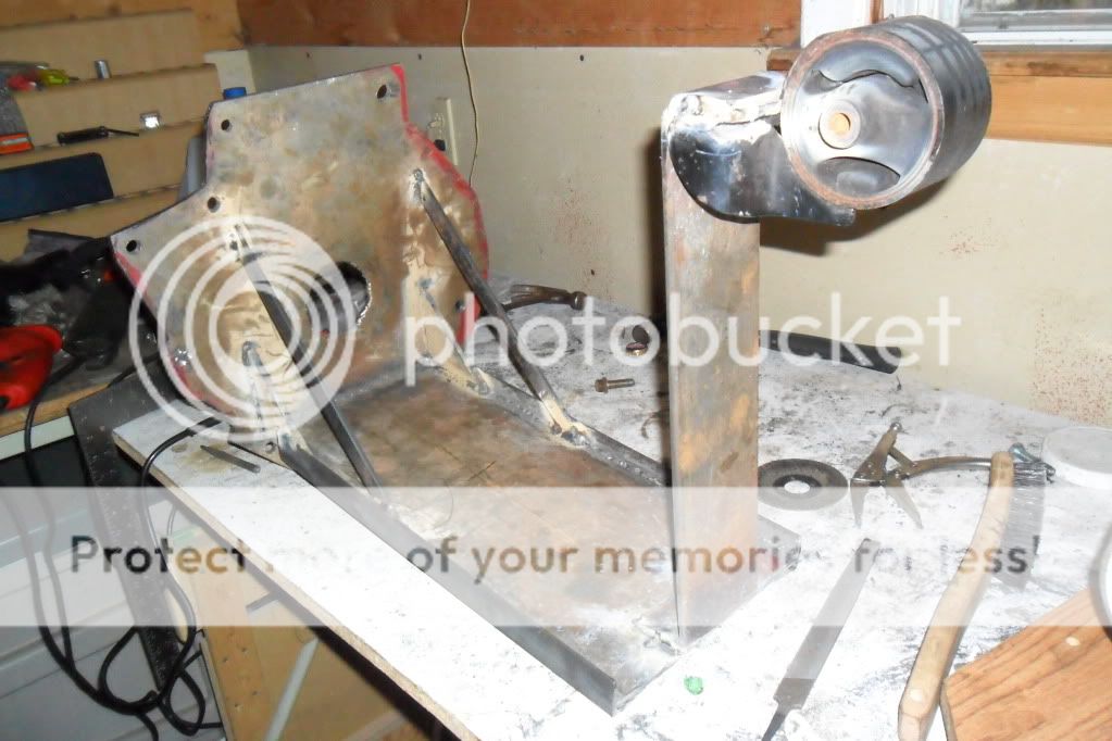

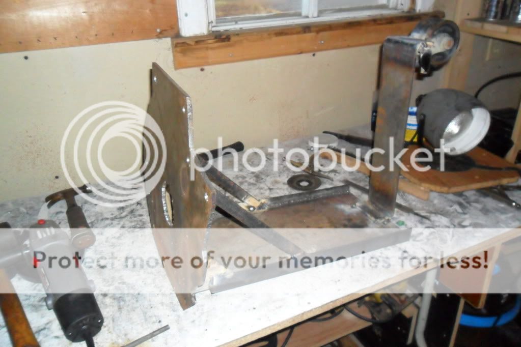

I got my coupler!!! Very excited!! I brought the Shaft for the female spline motor and the clutch plate to a machine shop and a day later they gave me back my coupler. Under $100.
They welded a big chunk of steel in between the shaft and clutch plate, then turned it on the lathe. the hole in the tranny side of the coupler goes just over 2 inches deep as the shaft is 2 inches.The 9 spline male end slides into the female pump motor. Sure hope it works! Probably should have discussed this in the forum first, but once I got that motor spinning in the right direction I couldnt wait to get my hands on a coupler!
http://i1027.photobucket.com/albums/y338/scottarseneau/DC%20Motor/SAM_0894.jpg
http://i1027.photobucket.com/albums/y338/scottarseneau/DC Motor/SAM_0889.jpg
http://i1027.photobucket.com/albums/y338/scottarseneau/DC%20Motor/SAM_0888.jpg
HydronCollider,
This coupler may or may not work. It really depends on if your transmission's main input shaft requires the support given by a "pilot" bearing.
It will be pretty easy to check. If your trans input shaft can be moved radialy this coupler won't work (at least not for long). These type tranmissions required the end of the input shaft be supported by the "pilot" bearing that was usually located in the end of the crankshaft or sometimes in the flywheel.
Without this spport the input shaft will wobble and eventually tear up/out the front bearing in the transmission
If your transmission requires a pilot bearing your coupler can probably be modified to work with the addition of a support plate and bearing and a little more mchine work.
Some pictures of the transmission input shaft and the crankshaft/flywheel will allow us to probably identify the type.
EDIT,
Found your photobucket, and located two pictures that pretty much identifies this transaxle as the type that requires a pilot bearing for support of the input shaft.
Not all is lost, as I said you will have to support the outer end of the transsmission input shaft with a bearing. There are several ways to do this. The simplest would be to support the coupler with a bearing that is mounted into a plate bolted to the front of the transmission. you would ned to put a centering bushinto the coupler.
I can recommend that you study how the outer end of the transmission input shaft was supported by engine crankshaft by the pilot bearing (this could be just a bushing). The male / female spline of the motor you are using will not give suffient centering.
DO NOT run this trabsmission without this support, You WILL destroy the transmission eventually if you do.
It can be fixed, just step back, think a bit and get a handle on what needs to be done. You got this far you can get all the way.
