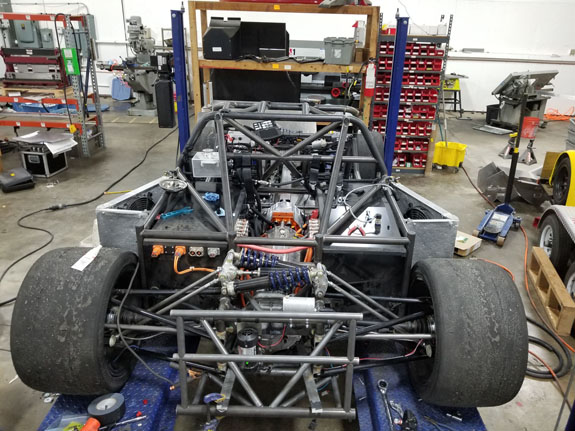

There is eventually a photo of the rear of the car, and there was that photo of the front drive components; between them they contain essentially the sum total of all design information available:
This appears to show the dual-core HVH/AMR motor flanked by battery packs. The packs sit in what are presumably normally aero tunnels, leaving the fancy rocker rear suspension holding the spring/shock units out of the non-existent airflow. :rolleyes: The usual Quaife, Porsche, or whatever transaxle is replaced by a simple bevel-gear final drive, and shaft runs up the middle to another final drive at the front.
The only technically interesting part is how the AWD is done. This is just a guess based on the photos, but it looks like front drive comes off the front of the dual motor assembly, and rear drive off the rear. There are a range of possible configurations:
  • this could be a dual-core motor with output taken off of each end, driving shafts to both axles at the same speed;
  • this could be a dual-core motor with solid drive to the rear and drive to the front through some sort of clutch (over-running, controlled friction, or even viscous);
  • this could be a dual-core motor with a centre differential; or,
  • what appears to be a dual-core motor could be separate front and rear motors, despite the common housing (unlikely because the relative front and rear power levels would not be appropriate).
There is presumably reduction gearing other than in the final drives, although speed is so high that perhaps the final ring-and-pinion sets are enough. If one reduction drive is shared between front and rear, it could be mounted at either end of the motor (presumably the rear), and the reduced output sent back through the motor's hollow shaft.
If they are driving both axles solidly at the same speed, or just letting the front over-run the rear for corners and powering when the rear slips enough, this is likely the result of their Pikes Peak experience... that with enough power that the car is usually drifting, so more sophisticated front to rear power distribution is unnecessary.

The three blue boxes are actually the three PM250DZ inverters. The battery boxes are in fact non symmetrical but not 2 to 1, and they are the same length.
So the inverters are the aluminum housings under the battery packs. This is the first time I've seen that arrangement. Now that I know what to look for, the break between the two inverters on the right side is obvious in the photos, and the length of the inverter matches the blue boxes in the drawing; in Travis's photos, the connectors on the inverters are shown so it is more obvious.
I was wondering if those might be cooling plates; that wouldn't have accounted for the inverters, but with an incomplete car and no detail of the interior of the battery cases, it's all guessing.
With the inverters accounting for the blue boxes, the two-part battery pack configuration is obvious. The removable upper rear vehicle structure is certainly nice for installation. :) In other D2 images, this structure is not removable.
Cells are cylindrical, 204S36P. Divided into 12S modules with embedded BMS in each module and Cold plates between each module.
17 modules, an odd number and so presumably accounting for the slight difference in left and right packs.
About 3 Ah per cell.
With cold plates between modules, this presumably means cooling the cells from their ends, like Rivian.
