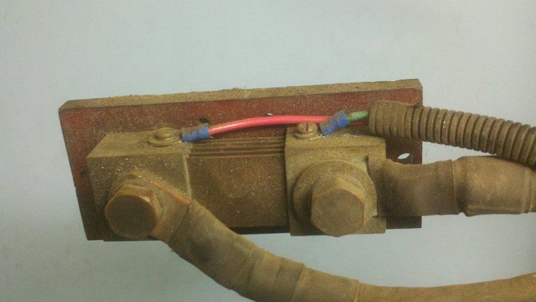

It looks like jacks includes a shunt. The one for 68 does not say if it has a shunt. This car is equipped with a shunt with leads going to the inop xantrex. I do not know much about shunts yet, and I can not see any markings on the one I have. Is there a way to determine if this one will be appropriate? It is big and heavy and has a brown composite board and was used with 20 6 volt trojans.
Do you have a picture of it? Most American shunts are 50mv and not compatible with most Chinese meters which need 75mv shunts.
You need one sized for at least your average current, but don't get one under 200A as they're kinda flimsy. http://www.lightobject.com/Search.aspx?k=shunt
Also, note, the JLD404 is $65 here. What you're looking at for $68 is not the right meter.
Yeah, looks like an American style 50mv shunt, likely 500A. Are you sure there aren't any markings under that crud somewhere?
I looked everywhere. This thing was converted in 1999, and I have no idea when it went in. I can tell you that it is heavy though. Is there a good way to test it to see if it is any good? (I am not sure if they go bad) Just wondering if this could be what is wrong with the xantrex. The display is blank and dead, 12v were present on the back of the display.
It's probably still good, but the only way to know for sure it's characteristics would be to apply a known current and measure the voltage drop. You'd have to be able to measure a 50mv drop under a 500A load to confirm my guess.
The shunt would only affect the reading on the Xantrex, not its display. If an LCD goes blank it's not getting power (bad fuse?) or part of the circuit is fried.
if you already have a shunt, it will probably be ok as they are sized to max amps you expect to put thru producing a 'typical' voltage for the meter. likke a 500a-50mV is pretty typical. Going from memory, I think both the evDisplay and CycleAnalyst expect 0-50mV output to the meter.... not sure if they can handle 0-75mV....

Here is an ebay link to a 1000 amp 75mv shunt you can use with the meter from lightobject. Buy the meter from them and get your shunt on ebay. I am using the 1000 amp but I am sure you could use the lower 800 amp too. There are a few different versions for $20 or less each on ebay.

(and BTW, 50mV shunts work with them, you just have to play around with the scales on the JLD. Jack goes over this in one of his blogs).
