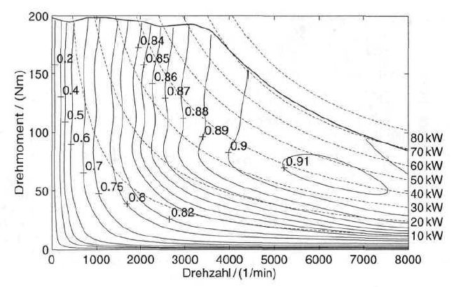

I got to wonder where your curve came from ruckus. It reminds me of something someone would just draw off the top of their head. I've tested motors and drawn motor curves and looked at motor curves many times, and that one just ain't right.
