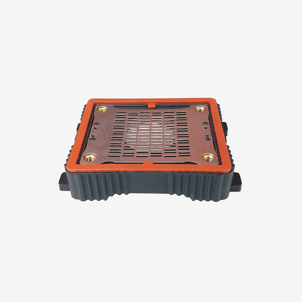

This shows how air pressure over a large area will distort a metal box if not properly vented:
Hey, look up Gore vents (same thing as Gore-Tex in your raincoats). They're little plugs you pop in to the side of your enclosure that have a small sheet of gore tex in them that lets air breath in and out slowly but keep ingress out. You still dont want to submerge them though. Looks like the they might be hard to find for consumers, but Amphenol seems to sell a copy-cat through Digikey.
Reactions: 2
oh that sounds cool. if anyone finds a supplier of these please share a link!
