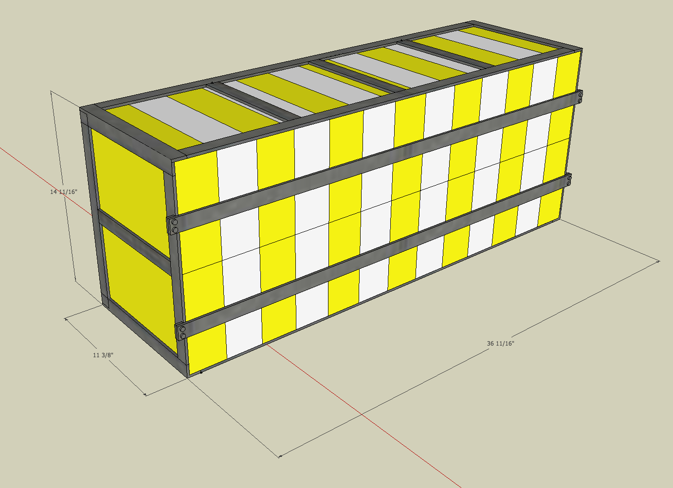

I'm working on my battery box design for my '69 bug. I'm (hopefully) using the 160ah size Thundersky cells. I'll have two packs. Below is what I was thinking for the rear pack -- it will sit on the rear luggage area behind the rear seat.
What thickness do you all think is okay to use for the angle iron? I'm leaning towards 1/8" thick with 1" width angle iron/steel, but might use 3/16" if I need more strength. Thinner would of course be better...as it would be lighter.
I'm also curious if anyone has a good way of strapping the cells down -- I have it drawn using a steel bar, but that probably won't work (and I don't want it to short anything out). I could use some tie-down straps, or some other non-conductive strapping material. I found a good picture of what Crodriver did, but he didn't mention the material he used. Any suggestions?
thanks for any advice!
corbin

I ended up using 1-1/2" x 1-1/2" x 1/8" angle iron for my boxes. As you can see, I've kept the 90 degree on all corners for rigidity. They're ridiculously strong for my usage... my rear box carries 19 cells that are underslung between frame rails (they don't rest on anything). Though, my max span is about 8 cells thick. I think the stock is up for it, though. If you need more strength, length-wise, just add triangle bracing.
I don't see a problem with bolting a hold-down bracket on the edges to keep the cells in place, but you have to be careful. My boxes are enclosed, so the tops of the cells sit a couple of inches from the battery box tops. Wood blocks wedge between the top angle and the cells. They wedge the cells from moving.

Nice! I will definitely go with 1/8" thick based on that, and I can probably get away with 1", but I'll think about moving up to 1.5" too.
Your website is great! I've been meaning to get some similar "strapping kit" to contain the cells together -- does the ebay seller have more kits? I'll try searching and finding one for myself.

I used 1/8 X 1" angle and 1/8 X 1" flat for the skeleton frame, then lined the boxes with 1/8' thick UHMW plastic. I also have a small amount of insulation in each of the five boxes. Three of the boxes house cells arranged 9 wide, the largest holds two rows of nine cells. This largest box is also unsupported from beneath. As Overlander suggests, triangle bracing is a good idea to add strength for the wider span.
I used SS strapping to hold down the cells. There are holes for the straps to pass through the bottom angle irons and small pieces of round iron to soften the radius bend of the straps. The straps have poly tubing across the top of the cells to insulate them from the posts.
I'm convinced that this design is sufficiently strong and reasonably light.
Hope this helps.
Rob

Cool! it sounds like the general consensus is 1/8" is a good thickness to use. So, I'm going with that. I'll be picking some up from SIMs metals in San Jose, CA tomorrow.
corbin
