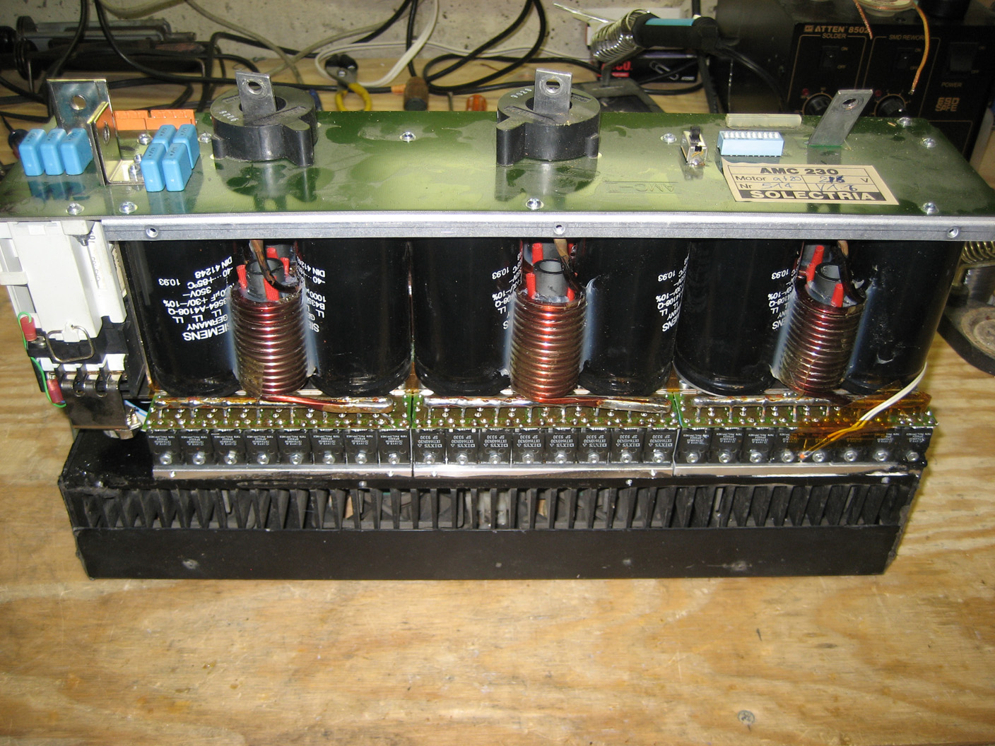

However what you are proposing is what the Solectria (Brusa) AMC2XX motor controllers did:
http://www.wolftronix.com/amc230_514/images/IMG_2825.jpg
Note the 6 inductors (3 in front, 3 in back), split between the motor phases, they implemented the bi-directional buck-boost converter in the motor controller.
The battery stack voltage is 216V and the motor runs around 150V... So they would run in buck mode while accelerating, and then boost mode during regen.
