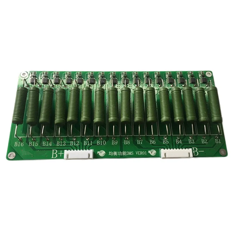

I found this on AliExpress. I am hoping it is a simple BMS. I have found no product manuel on-line
Would someone take a look at product and let me know if it is indead a BMS, how it works.and how to hook it up.
I am building a 48volt off grid solar energy pack with CALB 180ah.
Thanks, James

this is just a guess on my part, but it looks like just a very simple cell balancing board using DW01x circuits. There is no communication, adjustment or control of this board--the voltage level of each cell is determined by whichever "x letter" was selected for the "DW01x". All the cells will be continuous balancing without regard to their neighbor, to the pack, or to any target that you might desire.
You might want to investigate your options for battery management systems that allow you to monitor, adjust and control the balancing function, in addition to managing the charging and discharge functions. You might want a "smart" top level controller with dumb balancers that only turn on/off when commanded. For example you might want Pack level voltage monitoring and Pack level current control.
Here is an example of a dw01 individual circuit, it is modified for use as balancer on the board you found, then it is repeated 16 times.
