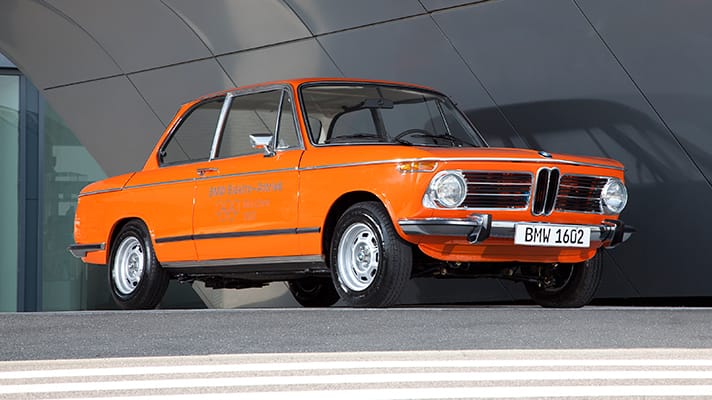

Dear DIY EV community,
I am working on a conversion to create a BMW 2002e in celebration of the first electric BWM from 1972. My aim is to meet the 50th anniversary of this visionary vehicle in 2022.
My story is that I believe in EV's and have a strong connection to the BMW 1602/2002. Last year I visited the Munich BMW museum and saw the 1602e. This was demonstrated in 1972 for the Munich Olympics.
See:
I would like to recognise @Tremelune in particular for his recent work and inspiration for me to start with the Nissan Leaf.
See below some photos of the current status:
