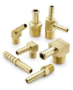

Anyone got a Thomas 12v vacuum pump for their brakes?
They look like this:
What do I use to connect into the "vacuum hole" on the top of the pump?
Mine has a threaded hole which I expect all of them do, but where do I get the connector that screws into this hole?
Cheers!
1 - 20 of 31 Posts
Your connecting it to the vacuum line right.
If so try a plummer supply.
You need a Brass Barb Fitting they come in all shape and sizes.
Charlie
Yeah, I have that pump. An auto parts store should have the fittings also. Not sure of the size though- you could take the pump with you and ask for a fitting that will fit it...
