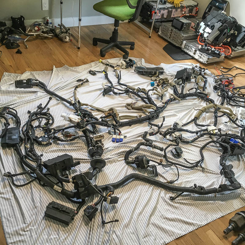

I'm researching using a Leaf as a donor for a classic conversion, and it seems like the state of things is moving so fast that even 2-year-old threads are outdated.
What is the current state? Like, instead of swapping in the whole car (which is apparently very difficult to do even after it is running on a bench), can I just use motor, reduction, and battery pack with some aftermarket controller?
What's the current easiest way to leverage cheap Leaf components in a car that never dreamed it could be electric?
Here is the megathread on Leaf donors:
https://www.diyelectriccar.com/forums/showthread.php/re-using-complete-leaf-drive-system-151458.html?highlight=leaf
Here's the megathread on a homebrew controller that may or may not exist as a purchasable product:
https://www.diyelectriccar.com/forums/showthread.php/another-homebrew-ac-controller-45909.html?highlight=johannes+huebner
Here is a thread stating all of the components needed for a complete Leaf swap to function:
https://www.diyelectriccar.com/forums/showthread.php?t=184785&highlight=leaf
The minimum we have found that works is:
Complete motor stack without AC (harness unmodified) including the park lock actuator.
Main ECU (VCM)
BCM
IPDM
J1772 inlet
Chademo inlet
Water pump
Coolant temperature sensor
Brake pedal switches (not the brake pot)
Accelerator HEPA
Start button and encoder
Two key sensors (both dash area, one above hvac and one in centre console)
Telematics module
Key security module (the bit welded to the dash crossmember)
Two original relay boxes from the engine bay harness
Repackaged HV battery with standard BMS
Heavily modified dash harness (with interior fusebox)
Body harness stripped down to just HV battery comms connector
The key
Prndl (gear selector)
Prndl light
Binnacle lower part
Sourcing a wrecked Leaf and using all of the above components doesn't seem that bad (though I would want to hide it all as much as possible), but nobody seems to have documented a full conversion, so clearly there are some difficulties I'm not seeing.
