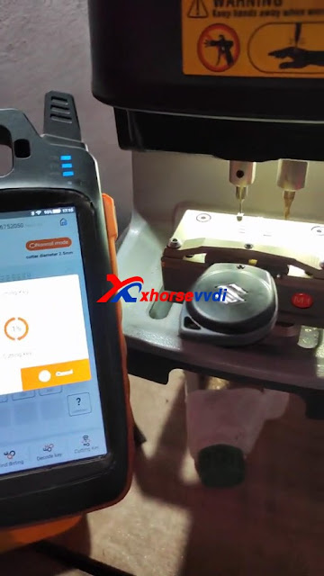

Please follow “Clamp type” to align M1 clamp tip to 2 position, this type recommend use 1.5mm to cut.
Key fixed: clear metal filings and use your finger to press the blank key on the clamp and make sure it is flat
Suzuki Swift all key lost using Xhorse VVDI Key Tool Max + Dolphin XP005 05
Select “Cutting key” and continue to make sure the cutting depth.
Suzuki Swift all key lost using Xhorse VVDI Key Tool Max + Dolphin XP005 06
Suzuki Swift all key lost using Xhorse VVDI Key Tool Max + Dolphin XP005 07
Then Start cutting key using Xhorse Dolphin XP005 automatically.
Suzuki Swift all key lost using Xhorse VVDI Key Tool Max + Dolphin XP005 08
Suzuki Swift all key lost using Xhorse VVDI Key Tool Max + Dolphin XP005 09
