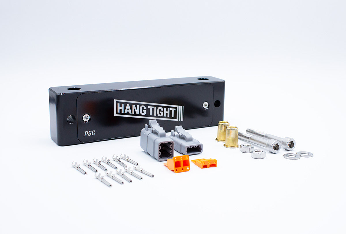

Sorry to revive an old thread, but have relevant shilling to do! In 2 weeks time Chrysler EHPS will be added to my controller. Universal PSC/NMS-PSC – NMStec
Down side is, it is relevant to a form of security! My financial security lol. I have released the code to run Volvo pumps, and may release more assist systems later on in the future. Gt86 columns are up next on my opensource list.
NMSTEC/Volvo_EPS_FREE (github.com)
