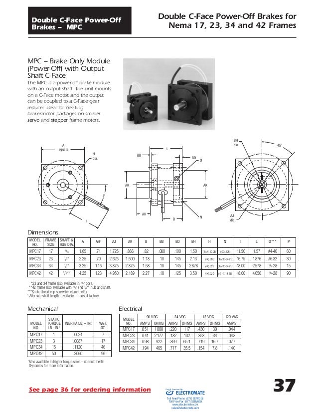

C-face, maybe?
I want to run a different motor, most other say "C face" but only NetGain offers a slipjoint or tailshaft housing
