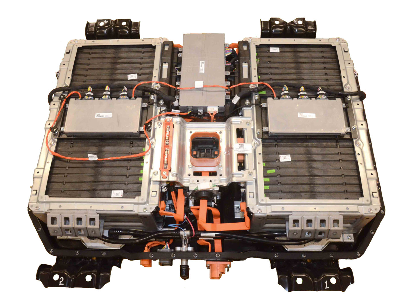

I should have mentioned earlier that unless the thing being bolted imposes lower limits, an appropriate tightening torque is determined by the bolt itself, and there are published standards for that, by size and material grade. In a few minutes of online searching, you can probably become more qualified to specify a bolt torque than the guy who picked that bolt for the kit...
Reactions: 1
I'm skeptical if you have enough clamping force to actually usefully create a decent enough thermal connection between the battery modules at the plate.
I'd think you'd need some long bolts at least between or around each battery pack and some decent boltdown force to hold them in contact.
For comparison, it is interesting to note how Chrysler attaches the same modules to the heat transfer plates of the Pacifica Hybrid.... which is also the mounting of the modules. Formed multi-part steel brackets surround the modules (in groups) and are bolted directly to the heat transfer plate.
Does anybody have a pic of how the OEM mounts them?
The best image that I have been able to find is shown in my post above (post #161).
It looks like you had a clamping plate that was just bolted around the perimeter of the entire box. I was suggesting that they should have a clamping force around each module itself.
It appears from the image which I posted earlier (which has been used in several articles about the Pacifica Hybrid) that Chrysler uses a single frame to mount and clamp a group of three modules, stacked along the axis perpendicular to the cell planes. As long as the thermal management plate is sufficiently stiff across the long dimension of the cells, then it doesn't matter how long the uninterrupted cell stack is as far as clamping to that plate is concerned.
What I'm seeing there, is there are fasteners in the middle, holding the modules down. Not a frame spanning the entire box and only clamped around the edges.
I suspect that my earlier comments may not have been clear. I didn't intend to suggest that the whole 3X2 array of 6 module was held only around the periphery of the pack.
There are fasteners all the way around the periphery of each 3-module group, and there are electronics boxes stuck on top (unrelated to securing the modules), but I don't see anything going down between the modules at the 1/3 and 2/3 points along the combined stack. As far as clamping to the thermal management plate is concerned, you only need to clamp down along opposite edges of each module, separated by the long cell dimension.
