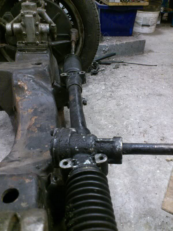

I took some time out from other stuff today and reassembled the MGB front axle assembly. It all looks good so far. I have ignored the seals and bushes and so on as they will be changed at a later date.
The steering rack currently points towards the back of the car and I will need to rotate it so that it points forward. That should be straight forward if I cut off the rack mounts and make new ones that are in the right orientation.
The standard bolt pattern to mount the cross-member to the chassis rails are angled so it is narrower at the front then the rear, I am pondering changing those to make them parallel. That will make it easier to build the chassis to fit.

This is the standard configuration on full lock.
The steering rack mounts like this (seen from the other side).
If I rotate the rack over so the column points forward I get this.
The rack mounts will then be above the rack, probably under the chassis legs (seen from the other side).

That sounds an easy solution, Todd.:)
I was working on how to use the standard MGB tapered bolts that usually mount the cross-member.
I guess no reason not to use other bolts instead. Or even to weld the cross-member to the chassis.

Are you planning to widen the cross member? Reversing the cross member and rack position without rejigging the steering geometry will give you toe in on turn instead of toe out. Sort of a reverse Ackerman steering geometry. Either the rack needs to be narrower or the cross member wider to accommodate the changes that are needed to the steering arms to correct the steering geometry.
4,458 Posts
Re: I want to build a trike!
Hi Woodsmith,
I don't think he's reversing the crossmember - he'll just be sitting on top of it, rather than behind it, so he's rotating the rack "on its mounts", so to speak, to get the steering wheel ahead of the wheels. There shouldn't be any changes in Ackerman, or any of the geometry.
Did I get it right Woodster? :)

Spot on.:)
Instead of sitting 2' behind the front wheels I am moving the seating to on top of the wheels. The requires the steering column to be about 3-4' ahead of the axle. So by rotating the rack the column points forward where I will mate it to a right angle gear box to then direct it upwards towards the steering wheel.

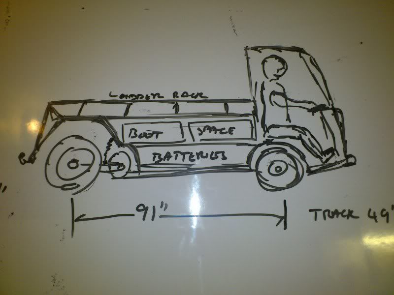

This is the noticeboard sketch I made one night when I couldn't sleep.
It shows the steering column brought forwards, the battery pack low on the floor between the axles, an enclosed load area above the pack, and a flat pickup bed over the top. There will be a tow hitch at the rear.
This sketch is assuming the reverse trike layout using the same motor and swing arm I had made up before, and the same bridging structure over the top of the rear wheel to the tow hitch.
If I find an MGB axle then I will go with a conventional four wheeler layout at the rear.
6,324 Posts
Hi Woody
How much space do you need? - why not build it a la Lotus 7 and use a trailer when required?
I think it would make a more "fun" car

Fun is often different things to different people, I have an electric tractor that is huge fun and 'burns rubber'.:D
Seriously though, it isn't so much about the 'fun' aspect, more the local work vehicle for when I am actively going out to work again. The construction and joinery jobs I am willing to do will be within 10 miles away and mostly via urban roads.
Ideally I would want to be able to carry a few 8'x4' boards and timbers up to 12' long, along with two tool boxes and some power tools. If possible I would want a 1 ton payload but would be happy with around 1000-1500lbs. I also want to be able to tow a trailer as well, for extra capacity. (I think I will need at least a couple of gears in the transmission.)
I will be mostly using it for fetching and carrying and so the cargo aspect is paramount. I can cycle the non cargo journeys, or use one of my cycle trailers for small cargo trips, and the diesel car for longer range when needed.
