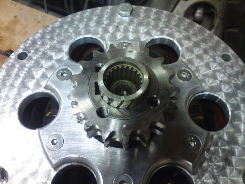

I just want to throw an idea out to those with more know how then I have as I am just pondering the more elegant looking options....:)
With very little work I can make clearance on the swing arm to fit a 57t sprocket on the hub. I will need to machine the sprocket to fit the hub mounting.
I could then have a 12t sprocket on the motor which will give me a 4.75:1 ratio, close enough to the 5:1 I'd like.
However....
The sprocket on my motor is currently a 17t on a taper lock clamped around a hollow sleeve that used to be a gear pinion.
As a reminder, the motor is really like a giant golf buggy motor and doesn't have a bearing on the DE of the armature. The shaft is just splined and locates inside the gear pinion which is supported by the bearing in the new DE cap. The gear teeth were machined off leaving a 40mm sleeve with internal splines.
Anyway, If I was to buy a 12t pilot bore sprocket, bore it out to a shrink fit on the 40mm splined sleeve, shrink it on and then weld it I would have a 12t drive sprocket on the motor.
Would that be a wise move, to weld the sprocket on, or am I setting myself up for a headache later on?
If it is acceptable could I MIG or stick weld it or should I find someone to TIG weld it on?
Cheers.:)

Hi Woody
I reckon it should be OK if you machine a good shrink fit. Would it be too much extra work to turn down the end of the shaft to remove those grooves and maximise surface contact?
The main thing in welding something like this, as you probably know, is to try and keep the cooling rate as slow as possible to avoid cracking, since you'll be welding a relatively low-carbon sprocket to a higher carbon shaft. I would preheat the shaft to 150–200C. TIG would be better than MIG as it has a higher heat input. MIG welds freeze faster.

Thanks Malcolm.:)
I'm not sure if I can turn away the grooves, they are as hard as the gear teeth were IIRC. I removed the gear by grinding and then by turning, losing a couple of cutter tips in the process.
If I can turn it it would also provide a good square shoulder to set the sprocket against.
Maybe grinding away the hard surface first would be a good way to prepare for turning.
I may have to opt for someone else to carry out the whole job to sufficient accuracy and strength, given I don't have TIG.
I would need to be careful as the sprocket would need to go at the correct end of the sleeve and I've not had much luck with farming out 'one chance only' machining work.:rolleyes:
Re: I want to build a trike!
Ditto what Malcom said, and I would add that, depending on how much you intend to use the trike, you have to keep wear in mind with a 12T sprocket. It will probably wear the chain more, but it's something to keep in mind as you can't just pop a new sprocket on it.
I would go for it personally. Replacement shouldn't be needed very often, and it should be too difficult to cut the TIG welds on a lathe.
Yes, that was one of my concerns. I figured that I could always turn off the worn sprocket and replace as required. Also by the time I have worn out the first one I might also have a better solution.
I guess I should try to find someone who can TIG it for me.
I will also need to find someone to machine the rear sprocket to match the hub mounting. It is too big for my lathe, and will need the bolt holes accurately indexed.
All this is getting spendy, not helped by wanting the sprockets to be Duplex for the stronger chain.:D

Looking at Todd's trike, and how the frame rails extend past the outsides of the rear wheel axles, I decided to have a look at mine to see how that would look. Not going to do it as I would not be able to remove the wheel and it would completely alter the single sided swing arm look.
In the process it occurred to me that now I don't have a big motor at the back the swing arm pivots don't need to be so far apart. In my earlier sketch, above, I placed the joints on either side of the chassis with the FD unit in between set to the left.
However, without the motor it also means I can move both pivots to the right of the FD and bring them closer together reducing the width of the swing arm.
It will increase the forces on the pivots due to lateral loading on the rear wheel. I am using M20 rose joints, they are big! The chassis in that area can be 'big' too!:D
Seriously though. If the pivot is strong enough like that then it does simplify the build and layout .:)
