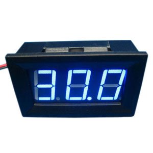

Finally got some new meters in, so I can rebuild my gauge panel without needing so many isolated DC-DCs (I managed to lose 2 and fried another one (that's 3 I've fried)).
Using 3 of these 50V DVMs instead of 2 99V meters will also give me more insight to the booster pack, since ~1/3 is SEs and ~2/3 is CAs.
