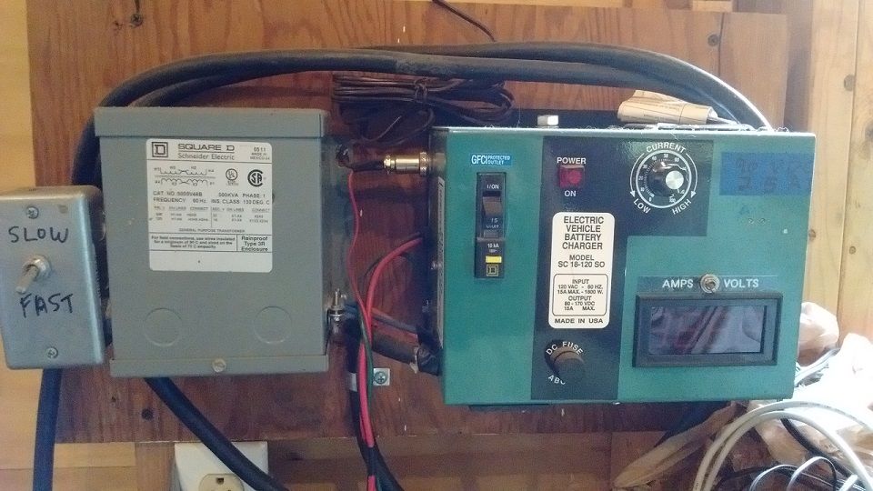

[FS] Russco SC 18-120 SO battery charger and boost transformer $250
1760 Views 10 Replies 3 Participants Last post by  Frank
Used to charge a string of Thundersky 100Ah cells (24S). $250 + shipping. Includes SB50 connectors (one for pack, other to supply 12V).

What is the charge algorithm for this charger? Im interested.
Is the input voltage just 120 for this size charger?
IIRC it's CC, CV. It's set up so it needs a 12V input (presumably controlled by a BMS) but I fed it straight 12V via the second SB50. I cannot recall what happened end of charge but I can look in the manual and report back. I had the Thunderskys on a commuter bike that I turned into a drag racer in 2014 so it's been sitting awhile.
Yes it's fed from 120VAC.
There are two small adjusting screws: one to control CV voltage and the other to control shut-off current. I liked this charger as it is isolated but once I moved to the higher voltage packs I couldn't use it.
