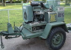

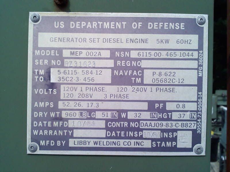

Thanks everyone for helping me understand better the details I need to collect, and how to use them. I don't know that 120 amps at 30mph is my constant draw. I remember seeing that match up but I don't remember if I was climbing or on the level. Unfortunately where I live, not much is really level. And I still have not put a loaded trailer on back to see what a difference that would make. I did however find a trailer/generator combination that may work for me. Here's some photos.
This is a jeep-size trailer with a 5kW generator on it. This would be a perfect match to the Zivan NG5 144-30 since it needs 4400w to provide a full 30 amps. And since it's all military, it fits in with the theme of the convoy. The combination gen/trlr weighs in at about 1500 lbs. That would put a tax on my power needs. It also makes me realize just how much more efficient today's hybrids are compared to the rugged military equipment I'm working with.

Maybe you can solve the problem with something like this:
http://www.jstraubel.com/EVpusher/EVpusher2.htm
A trailer pushing a car sounds ridiculous, and dangerous, and unreasonable...
I love it :)
aesthetically speaking I think your better off with that 5K though...
would it run biodiesel stock? I know they can run commercial diesel, so it seems like it should, but they are built to run JP8...
Admin: 'one of many'
4,838 Posts
I love it :)
That's why they are not legal in the UK.:D
For a military Jeep a military trailer has to be the one to go for.
It would look authentic and quite reasonable to be towed along in the convoy.
I think a big red or yellow painted civvy gen set with Honda on the side would look wrong.;)
