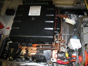

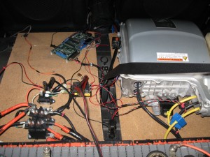

Battery: Two custom packs made of 42 Prius Battery Modules
Motor and Transmission Mounted

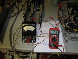

Manual Charging of Battery Stack

We are running two battery packs of 42 series modules in parallel (best case 13 amp-hr). I hope just enough to get me to work and back daily. I wanted to run all in series so we would not need to modify the controller we have -- not sure what effect the modifications have had on its overall performance. I was not able to get any answers on the dielectric operating voltage of the motor, so we went with the lower voltage.
For test runs we are not fully charging or discharging (we think) the battery pack. Only charging the battery pack at 5 amps for now. We don’t have a battery fan or BMS setup yet. Have been charging the pack to 357 volts (42 x 8.5).
The Prius battery modules are nice to work with from a packaging and flexibility point of view. You must keep a close eye on the temperature of the battery modules when charging to get a full charge. We put one pack in what looked like thermal runaway before we got smarter about charging. It took two large fans more than an hour to get it back to room temperature.

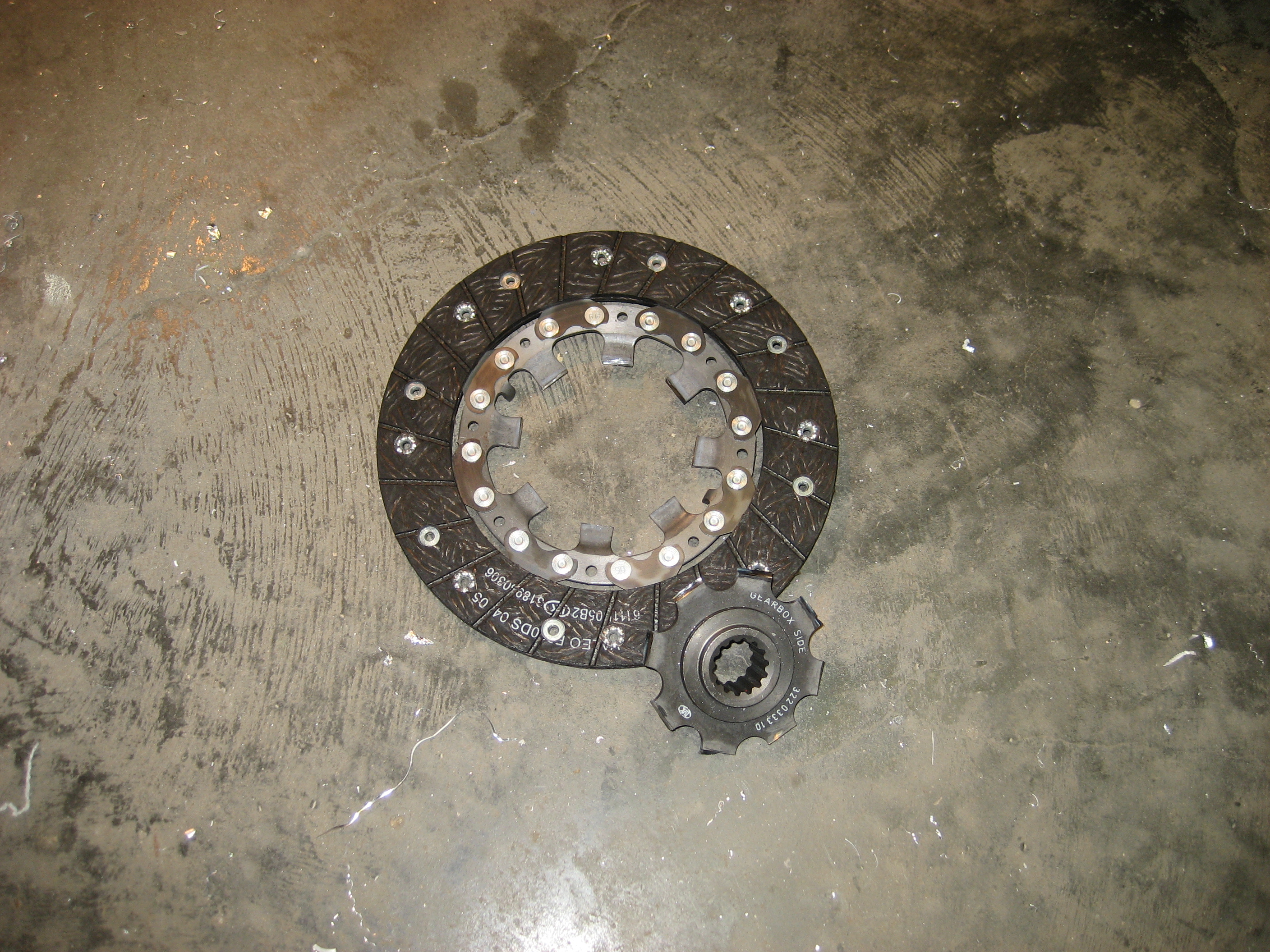

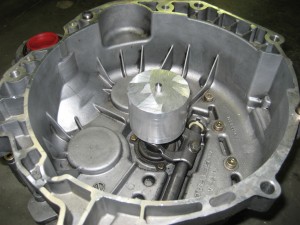

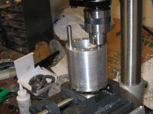

Making the Coupler
The following shows the basic steps used to fabricate the Motor to Transmisson Coupler. This coupler used concepts shown by Tischer.
Testing fit of B-lock on Centering Plug:

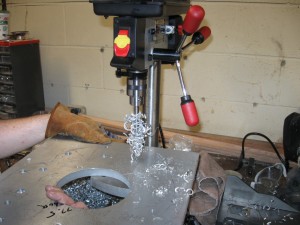

Not shown here but we clamped on the B-Lock and drilled pilot holes using B-Lock as guide by removing and replacing each B-Lock screws one by one to drill the holes shown:
Its tough, but Adam lets it know who’s the boss:
Transmission Spline Coupler is cut loose. Note, the circular step bushing on the back we can use to center this piece to the coupler.
Test fit of Transmission Spline Coupler to its centering hole:
Boring out motor shaft clearance hole:
Used previously drilled pilot holes to center and drill each hole through aluminum spacer. Then we bolted on the Transmission Spline Coupler to match drill the bolt and locating pin holes:
Looks like its going to work:

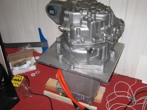

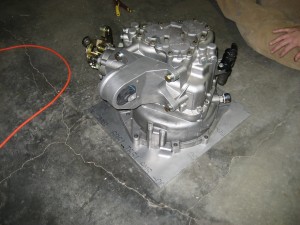

168 Posts
Discussion Starter #12

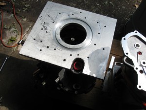

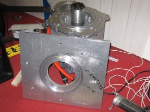

These are the steps we used to create the adapter plate to attach and center properly the motor to the transmission.
We started with a 3/4" 6061 aluminum plate and made an acrylic template that showed the bolt holes from both transmission and motor as well as the outlines. This kept us on track and helped make decisions.
The next step was to drill holes for the alignment pins in the transmission. We marked the two spots using the transmission as a guide.
The use of transfer punches made sure the plate was marked properly.
Here are the finished holes with threads, looks like we selected the correct bolt lengths.
From there we needed to find the exact center of the transmission to later line up with the exact center of the motor. To do this we created a 'center punch' that we fitted onto the transmission shaft and used the clutch action to make our mark.
At this point we didn't have the capability for precise machining on a piece of this size. So we hired a machinist to cut our centering ring and the hole for the coupler. Here it is back from the machine shop.
And then the first complete fitting test between motor and transmission.
Then we began the process of marking the bolt holes for the motor using a transfer screw set, shown above.

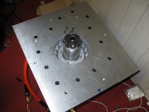

http://bmpenterprises.net/blog/wp-content/uploads/2009/12/IMG_0600.jpg
After drilling and testing all the holes they needed to be countersunk so the transmission could sit flush against the plate.
This is the plate countersunk and bolted to the motor.
http://bmpenterprises.net/blog/wp-content/uploads/2009/12/IMG_03011.jpg
The last modification to the plate was to make room for the trans-axle on that side. So we cut a radius by drilling several holes and cutting out with a saw.
See additional pictures at [URL="http://bmpenterprises.net/blog/2010/01/02/making-the-transmission-adapter-plate/"]http://bmpenterprises.net/blog/2010/01/02/making-the-transmission-adapter-plate/[/URL]

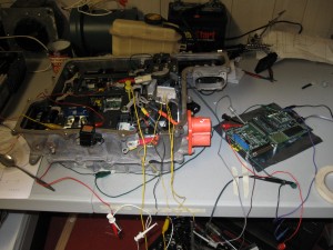

This post contains a breif overview of what we learned trying to use an Industrial VFD as the Motor Controller.
If any one has some ideas or experience on how to overcome the issues associated with the transition from Coast to Stop, to Run, and then to Flying Start discussed below I would appriciate the help.
We purchased two used Industrial Variable Frequency Drives on eBay. The first one was a 30 HP 460 AC Benshaw Sensorless Vector Drive RSi030SX4B which turned out not have enough current output to get the car rolling consistently from a dead stop without tripping the hardware over-current protection circuit (~80 Amp). We were able to drive the car, once the car started rolling. It just could not supply enough current to move the car without tripping the hardware protection limit. The second one which we are using now is a 100 HP 460VAC Benshaw Sensorless Vector Drive RSi100SG-4B (~150 Amp).
If you are planning to try to use an Industrial Motor Control in your electric vehicle project here are some lessons learned:
Most units above 30 HP are only available in the higher 460 VAC. Unless you plan to run a 600 VDC system you will need to modify the unit to operate at a lower voltage.
Make sure it has a sensorless vector torque producing mode of operation, or you will need an external shaft position sensor to get high torque at low speeds.
Make sure the maximum AC frequency output of the controller is known and is high enough to support the the max motor rpm desired. The 100 HP unit we have is limited to 120 hz which sets our max to 2500 rpms, 40 mph in second gear. To get more out of our motor, it should be more like 300 Hz.
Make sure the controller has the ability to turn off the phase loss detection. If not you will need to "fake out" the detection circuits.
Make sure that it has a control mode which lets you command an output torque not speed. Our present controller only lets us command a target motor speed with timed speed ramps which results in difficult operating conditions when stopping.
If the controller does not have a command torque mode, it needs to have someway to associate an external switch input to the "COAST TO STOP/RUN control input to turn off the drive output when coming to a stop if you do not have a clutch. This input is needed to circumvent the controller speed control loop which is trying to hold the rpm at the commanded speed.
If the controller does not have a commanded torque mode it needs a "flying start" mode which keeps the the Controller's output current low until the motor and commanded rpm are the same. Unfortunately our experience to date is that this does not work well in our electric vehicle application and is the only reason we cannot drive the car around town safely. If "flying start" mode does not work well, the only way to accelerate after a "COAST TO STOP/RUN" command is issued, is to come to a complete stop, and then accelerate. The alternative to a full stop and then start is a screaming controller and a bucking car while the controller tries to sync the speed. This does not work in traffic.

Thanks !! for reading and trying to help. I had hoped to put more info up on how we modified the drive but other things are too demanding right now. To get the drive to operate at the lower voltage we shorted out and trimmed some of the input voltage sense resistors and startup resistors on the auxiliary power supplies.
You are correct, we bypassed the AC/DC front end and tied into the DC Capacitor bus. We are using a pre-charge resistor before applying battery to prevent inrush.
We learned quickly we had to set the ramp down time much longer than the ramp up time or our heads might come off when you let off the accelerator peddle. We learned the hard way how well Regen in an AC Induction motor can work. The drive I have unfortunately does not have a parameter to adjust Regen current level. In Regen, it only halts deceleration based on the sensed input voltage increase which is not useful because that is basically held fixed by the battery. Have thought about using the future battery current sense circuit to offset the input voltage sense.
Last time we drove the Mini we had the ramp up time set for 5 seconds and the ramp down at 15 seconds. The 15 seconds avoids the head snapping and helps keep the Regen current to battery low. I have not investigated the relationship between the ramp times and the “flying start”. I was wondering if the issue was related to my inability to hold the throttle peddle still while the drive tries to sync up the frequency. I would like to think the drive would quickly sync up and then apply power to ramp like normal to whatever the set point was. It seems the ramp times and power should be off until it has synchronized. It acts like its driving current while its searching. I wondered if it is turning on the boost current during this time or some brake current. There is another mode “Delta Freq” I have not investigated to see if it would help here. In the “Delta Freq” mode the Accel/Decel time is the time that takes to reach a target frequency from any frequency. I tried this mode early on to try to address accelerator response. I did not like the results at the time. Do you think this mode would help with this issue?
