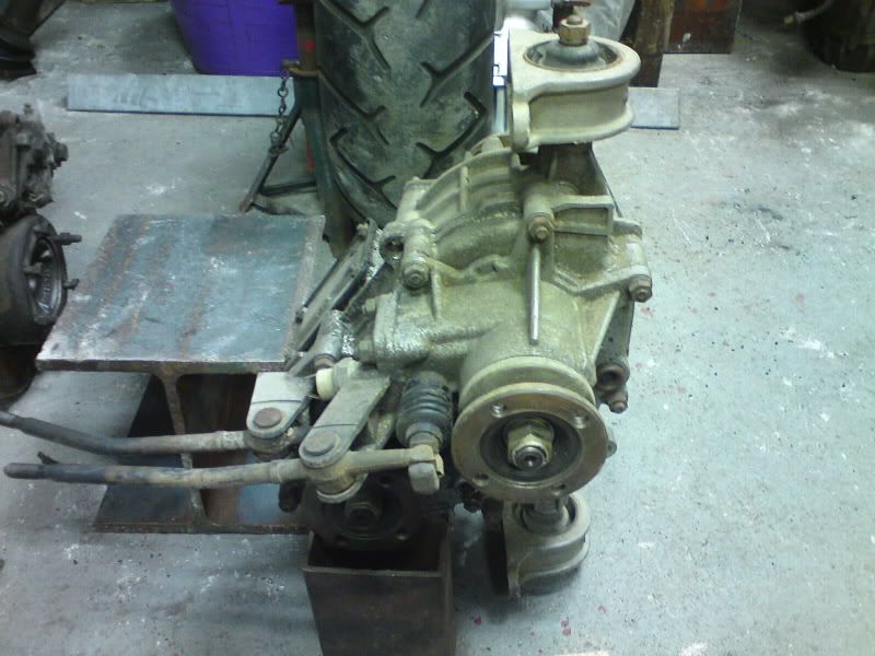

The Lada Niva transfer box weighs 27.4kg
In comparison a rear wheel from the tractor weighs 25kg
So if I were to build a trike, as Jim suggested to me, with the 12" motor, driving the motorbike wheel through the transfer box to get two speeds I would be looking at 170kg just in those parts alone!:D

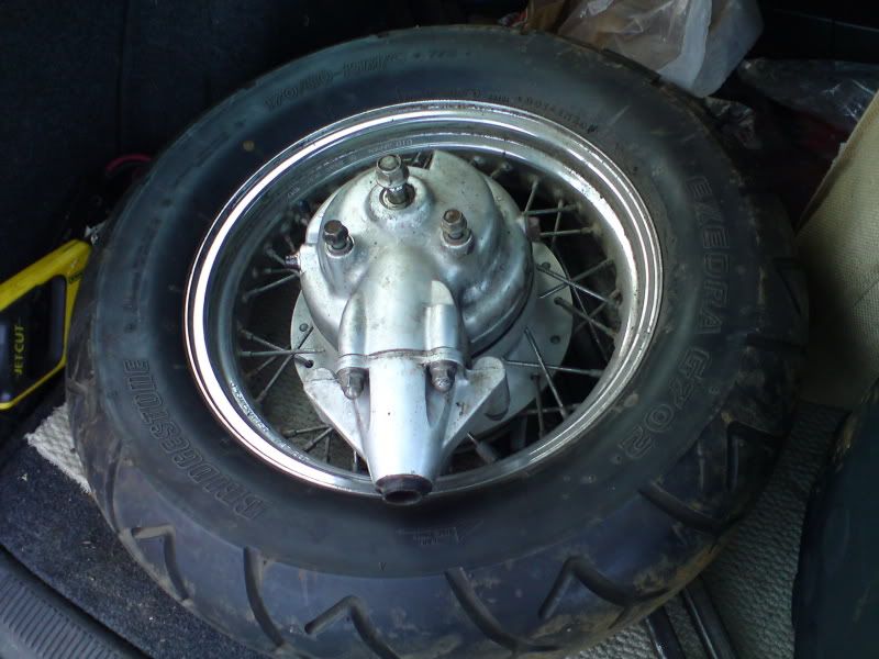

I guess it will depend on what reduction I have to work with. I must check the ratio on that Virago wheel.
It would be nice to be able to just spin the wheel as I will know I have the max torque available. It is also good for showing others that it 'has some grunt'.:D
I am still dithering over finding the rest of the Virago parts, not knowing which bike the wheel was from, or getting a complete rear swing arm set up in chain or shaft drive from any other bike.
The drive to the wheel will also dictate a lot, chain or shaft. I prefer shaft but will need the whole set up and a means of off setting the drive line or having an angle drive from the motor. Chain is easier to work with, even if I needed a jack shaft.

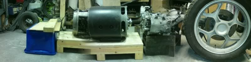

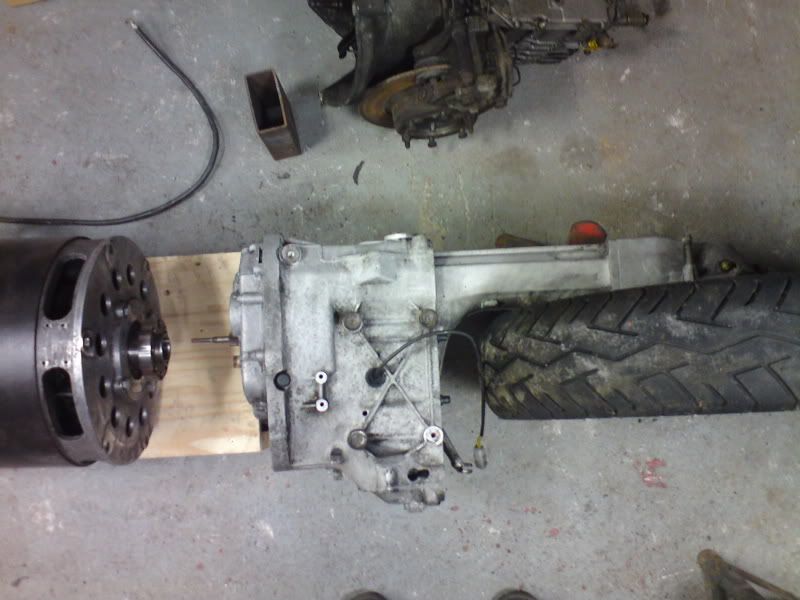

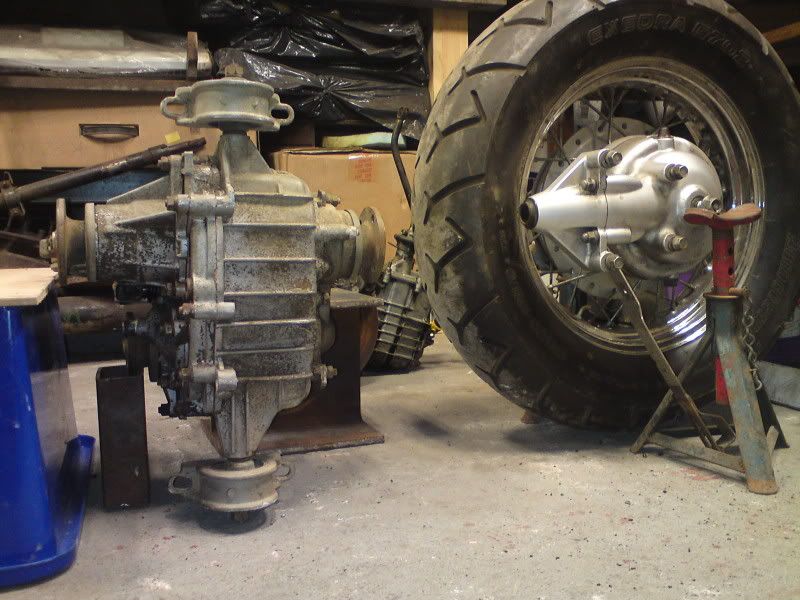

Here are some photos in the newly vacated workshop to tease Jim with!
12" motor, propshaft tunnel under the seat, transfer box behind to off set the dive to the Virago wheel.:D

And with propshaft.
