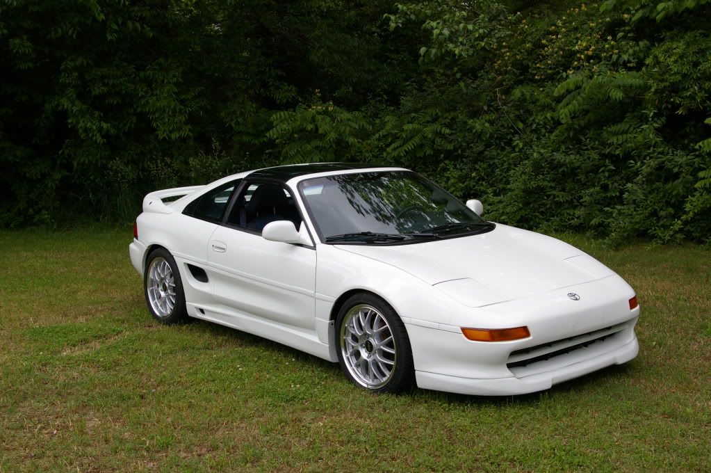

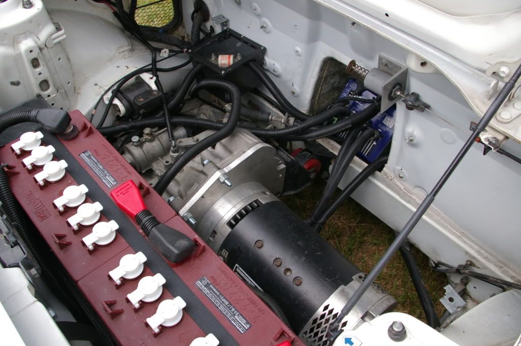

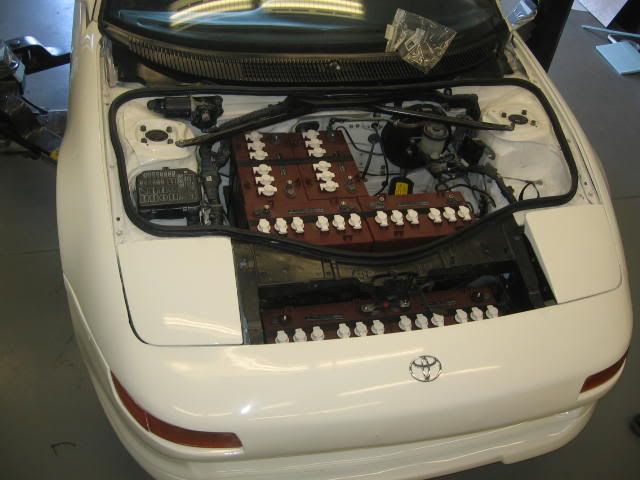

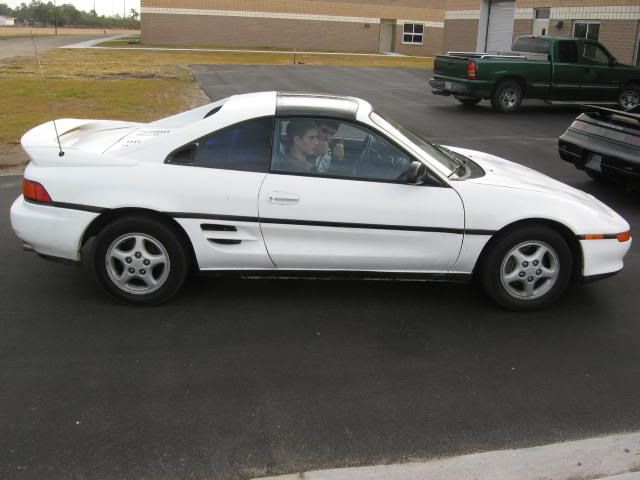

Well, after keeping this project under the radar for 3 months, it is time for the unveiling! I will provide more info later, but wanted to share a couple of pics of the Topsail High School MR2 project. We just placed first in the nation for the 6th straight year in the SMARTT Challenge competition and the 1991 MR2 was our newest conversion. Completed on Thursday, competed on Friday....now that is cutting it close!
3350 pounds
13 12 volt FLA Batteries for 156 Volts
ADC 9" motor
Raptor 1200 amp controller
17 Posts

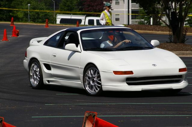

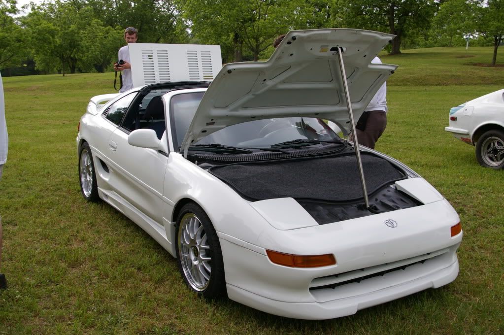

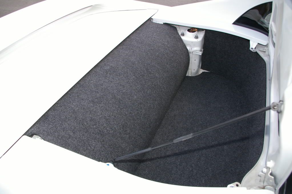

Here are a few more pics... We have to use lead acid in our competition and chose to use flooded as opposed to AGM because 99% of the time, this car will be a daily driver and only autocross a couple of times a year. It rides and handles very, very well though. It has D2 coilovers and ST sway bars for suspension mods. We had to go with 7kg front and 9kg rear to compensate for the added weight.

Thanks for the compliments! We really stived to raise the bar with this car at our annual competition. In the range event, we drove 48 miles and still had at least 15 more miles left in her. We stopped because we had alraedy won our class!

Not much acid yet....we were not able to get a hard run because the. Coupler has broken welds, or at least that is what I think has happened. We plan on dropping the motor Wednesday and taking a look.

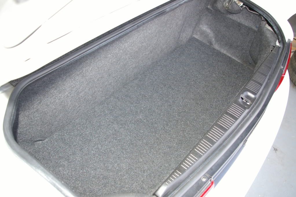

Did you guys do a documentary build site online? details on racking, components, layout, etc? You squeezed a lot of lead in there, and I bet other would like to see how!
17 Posts
Discussion Starter · #18 ·
We wanted to do a Blog but we intentionally kept the project top secret so we could surprise our competitors at the final event this year...also, I had told the students that if the car was not ready, we were not going to compete. Didn't want to put it out there and not bring the goods. Our competitors were very, very surprised! We have won the last five years with different vehicles but this one set a new standard.
