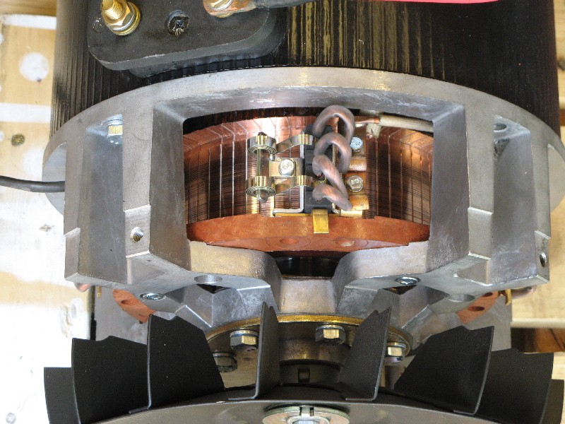

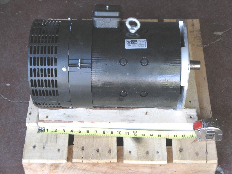

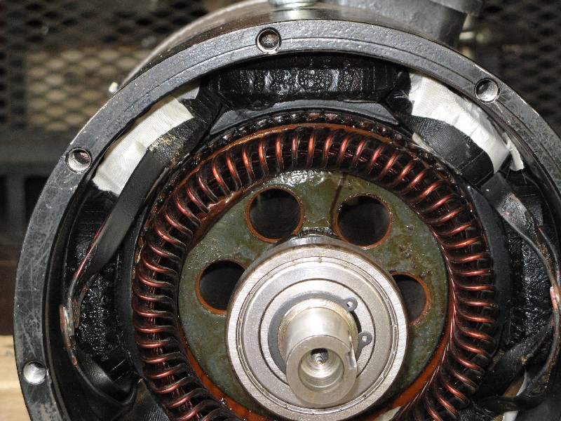

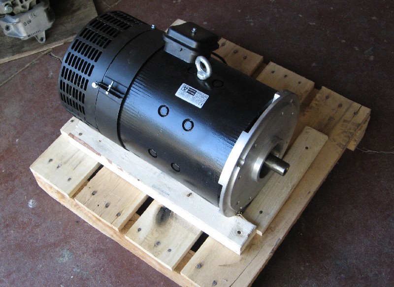

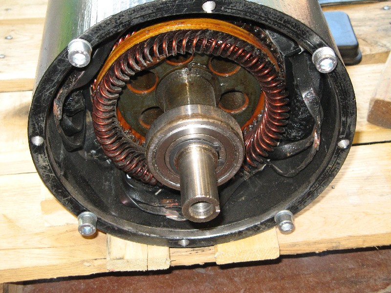

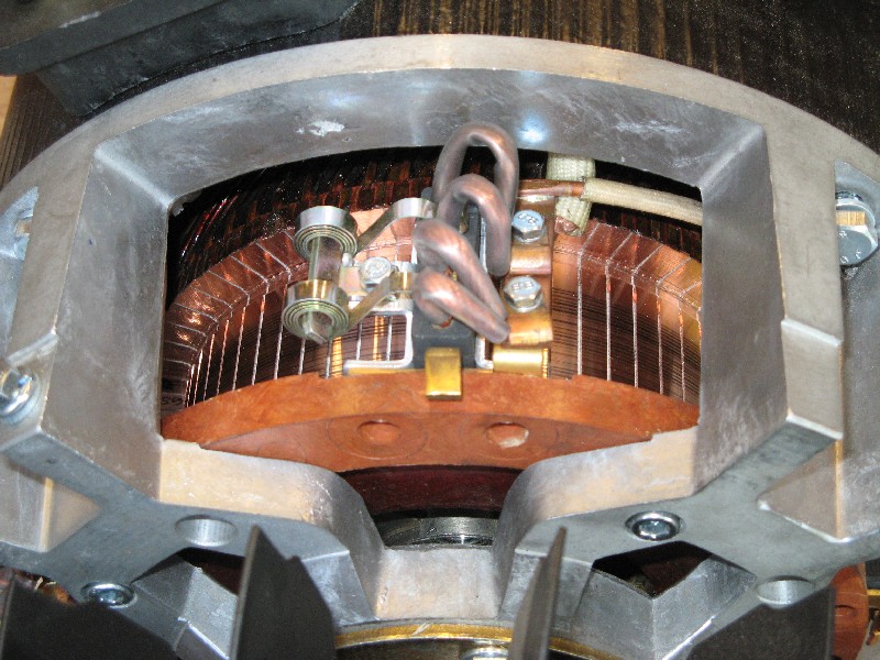

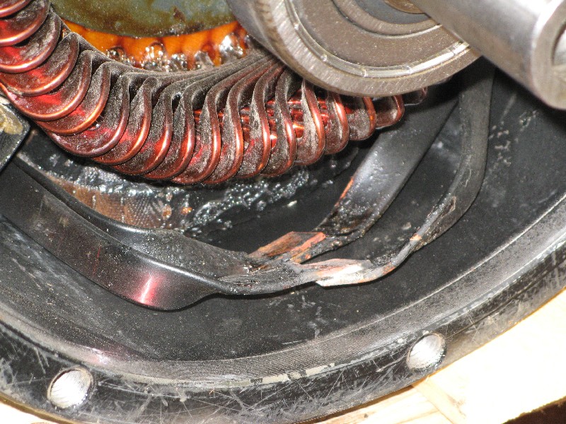

I got my new Kostov 11” motor the other day. Curious about the workmanship and quality of this motor I took a look inside to check it out. Overall construction of the armature seems pretty robust. The commutator was large and brush holder design seemed rugged. The field windings however I thought could use some attention. The spot weld splice of the Interpole winding conductors seemed a bit shoddy as they were not insulated or strain relieved. I could see the possibility of these splices fatiguing or making contact with the case in a prolonged heavy vibration environment. I don’t think it would pass a shaker table test… Aside from that the motor looks to be built pretty well. Here are some of the internal dimensions:
Field iron length = 4.75”
Armature diameter = 6.87”
Magnetic volume of armature = 176.1 in^3
Commutator diameter = 5.85”
Commutator segment = 0.25” X 2.10”
Brush contact area = 0.49” X 1.56”

Wow I was always told that the magnetics for a Kostov motor was rather on the small side due to the inter poles but the magnetics look as big as a GE 11.

Well, I am not claiming that our motors have no defects whatsoever but I cannot quite agree about the shaker table test.
First of all, there is an insulation strip going round the inside of the case so the winding connections cannot short to the case (you can see the insulation strip's edge on the last photo - as it is all painted black, it is difficult to see it clearly if you do not know what to look for).
Second, the two conductors with the weldings are actually carrying the same current in paralel so even if they touch, this will not be detrimental to the motor.
Third, if I am not mistaken, during varnishing of the windings the welds also get covered with varnish. As the varnish is transparent you can only see it by very close inspection or if you scratch the weld with a knife (there should be some fine dust).
Regarding the reversing, indeed the brushes are neutral timed and the motor can safely run at high voltage in both directions. Contrary to non interpoled motor, it is not advisable to advance the brushes of our motors as this will significantly worsen commutation.
P.S. ...maybe I should have started with the fact that I work for Kostov in Bulgaria (www.kostov-motors.com). :)

... if I am not mistaken, during varnishing of the windings the welds also get covered with varnish. As the varnish is transparent you can only see it by very close inspection or if you scratch the weld with a knife (there should be some fine dust).
Well I guess my motor must have missed the final QA/QC inspection then. It definitely did not have any varnish on the weld splices of the interpole field winding conductors. I verified this with an ohm meter. Just touching the meter probes to the weld zone yielded continuity – did not have to scratch at the surface with the probes…
Not to worry as this was easily remedied by applying a couple thin coats of class F red insulating enamel to the exposed areas. This type of insulating enamel has a dielectric strength of 2100 V/mil and can be purchased from Grainger or motor rewinding shops.
This is why I added "If I am not mistaken" to this argument :)
Otherwise the first 2 arguments are still valid.
