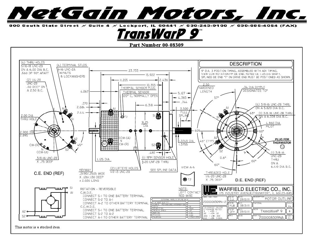

i want to do a direct drive conversion for my Ev using either an 11" or a dual 9", depending on what i can fit in the car. i looked around and decided it it either had to be a transwarp from netgain, or a kostov motor that i would have to modify for direct drive use.
i like the netgain, firstly because it comes with the slip yolk already installed and it has two bearings on the drive side for added strength, but its expensive, 2000 to 3000 more expensive (for a dual nine).
i think kostov make a nice cheap motor and have great value for money, but they don't come with a slip yolk, which means i'll have get one made. This will cost money and time.
so if any one has experience with using kostov or another motor for direct drive, how hard was it to make a slip yolk for you motor?
i also saw that netgain sell the slip yolk assembly and shaft housing separately for under $500 on their website, would it fit on a kostov motor? i had a look at the drawings of the transwarp 9 and the kostov dual 9 and to me it looks like they're not computable(netgain have a thicker shaft), but feel free to take a look.
any hep or information would help greatly thanks for your time:D

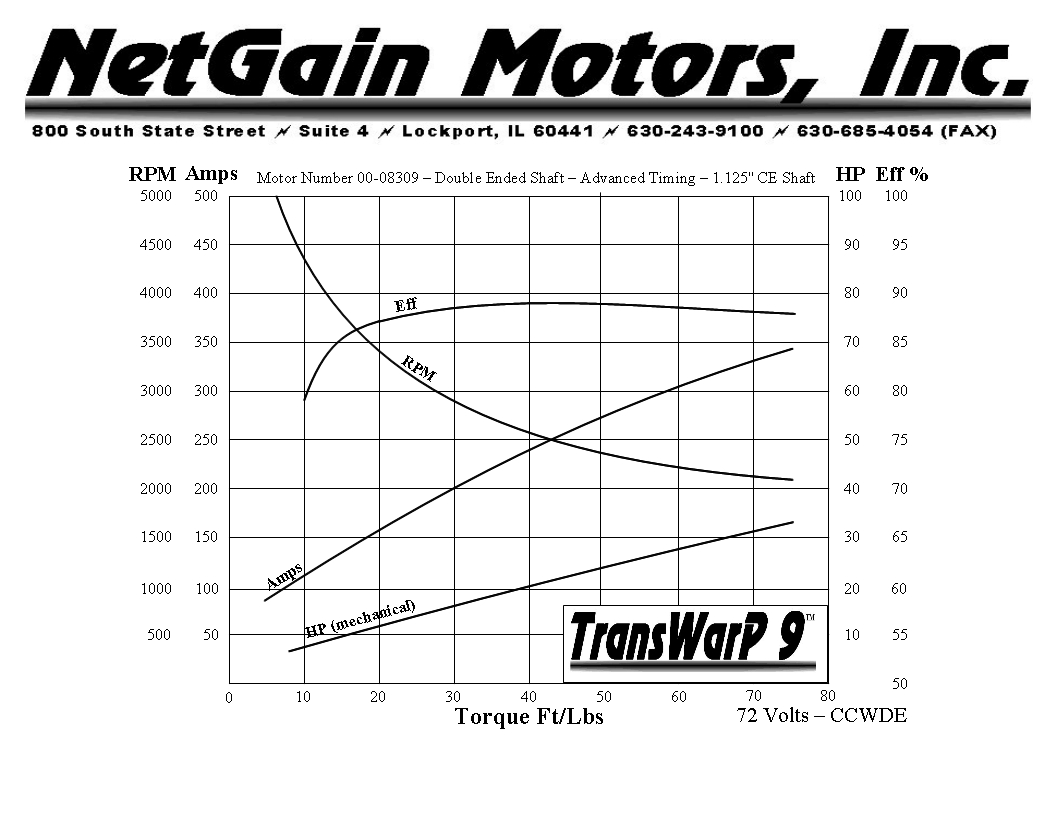

I think you should be more interested in motor rpm/torque rather than the coupling method.
Having no gear box means you achieve torque by overusing amps which affects your range greatly.
I remember some evidence where a gearbox conversion used 200W/km vs. 270-300W/km when gearbox was removed.
I hope you are keeping at least the axle gear ratio (1:3.6?).

i was planning the use a diff ratio of around 3.6-4 which would give me a motor speed of around 3000rpm. i have a few diff options with the car i'm thinking about using.
i can guess at lower speeds or start stop traffic it would be a good idea to have a gearbox or a lower ratio to keep the revs higher and current lower, but i live in an area where the majority of roads are 100kmh(62mph). so the motor will be revving fairly high anyway.
i don't know a huge amount about how motors behave but i saw that on the netgain site they posted maximum efficiency at around 3000rpm. so i was planing on aiming to have my motor run at around that speed for as long as possible. at 100kmh, with a diff ratio of around 3.6-4, and normal sized tires the motor will spin at 3000rpm. the table they have on their website was easy for me to comprehend:confused:
i'm not sure if i;m reading the graphs correctly(do all the lines relate to each other or just touque), but i have noticed that netgain only post stats at 72v while you guys have you stats at 144v and on your graph, if I'm reading it correctly your efficiency comes at a greater rpm, around 5000rpm. does that mean that the higher the voltage the higher rpm the motor achieves maximum efficiency? or is it a difference in how the motors are made?
with the information i had available it looks as though 3000rpm would be fine for a nine inch to handle, and given that there is two of them i figure that they wouldn't have to work to hard, so wouldn't need huge amounts of current at take off.

The 'slip yoke' is designed from a turbo 400 trans tail end.

If I wanted a direct drive street EV (and I kinda do) I would consider this hardware from EVsource.
Using the TH400 shorty housing has issues, most notably the limited oil volume that can be in there for lubrication. If you have even the slightest leak you run out almost before you know it. Some have used grease, but the tail housing bearing isn't designed to be a greased bearing. Some have run without a tail housing at all, using the splines directly, but those splines where designed to be fitted with an outside support bearing. I don't know if there would be life issues or increased vibration issues.
The sliding spline driveshaft is a common part of any vehicle with a 2 piece drive shaft. That would be most trucks and some long wheel base automobiles. It has also been used for years as a retrofit to older Mopars that came with a ball and trunnion joint to allow sliding movement in the driveshaft. The spline is designed to run dry, usually not seeing any love until it's time to replace the U-joints anyway.
