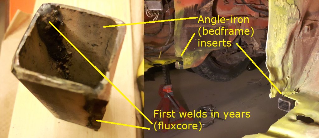

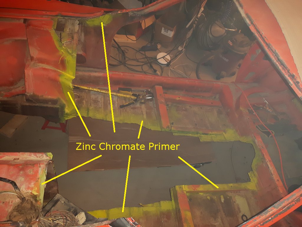

Update, Bodywork:
Keep in mind, I've very minimal bodywork experience. The goal here is to make the yellow piece fit the orange pieces, and no longer just in a rough way.
After months of staring at things and not knowing what to do, and it being too late one night to run a grinder, I eventually just grabbed tin snips and just started cutting to motivate myself into acting. My logic was: If you cut something tonight that you're not supposed to, you can fix it faster than you figure out what's perfect (and won't ever anyway).

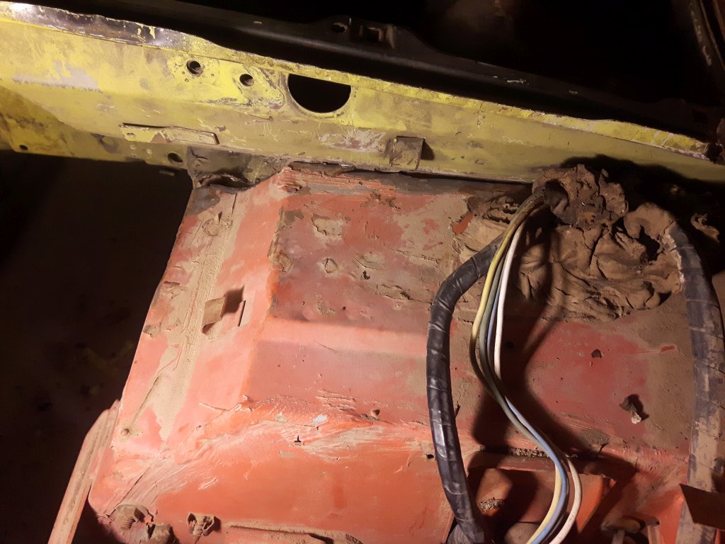

Started with the passenger's floorpan:
Whew. I measured from the frame edge underneath and still got it wrong. It varies from 1" overlap to zero overlap. Oh well. First bodywork in 3 months, broke the seal. Onward next night!
That's the driver's floorpan. Good enough.

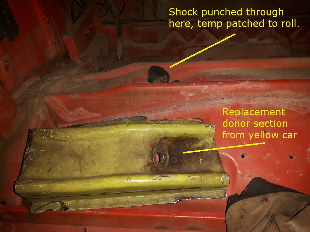

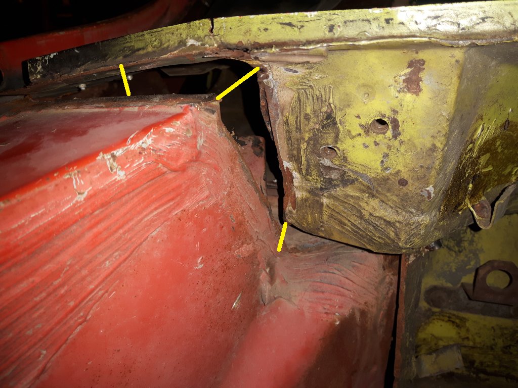

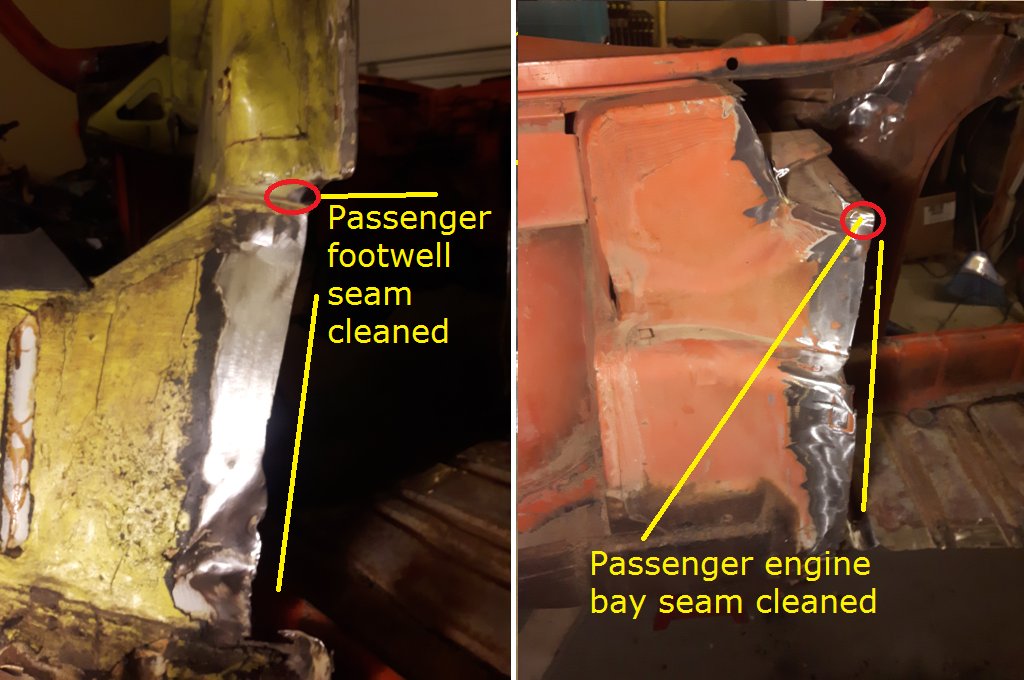

Okay, back to work. This is from inside the engine bay, looking at the box where the cabin heater assembly goes (VIN plate is just over that yellow lip).
See the top of the yellow lip where the metal is torn?
In order to originally shove the yellow car inside the orange body, the three of us used prybars and my legs. It did not want to go. This resulted, I suspect, in bowing the top of the firewall upwards into an arc, and deforming some of the metal below.
This is going to be an ongoing issue.
The yellow panel is fit. That's how much it doesn't fit by. I have to go at some of the sections where it's being blocked and start chopping metal until it fits.
I scribe some lines from underneath the car to see where I have to clean the sheet metal to prep it for welding, and then flapwheel the grime, paint, and undercoat off.
6
This is about the best the three of us ever had it fit in Phoenix, and that was while the far side of the trans tunnel was still floating in air. It got much worse when we shoved it downward.
Good news, both sides of the dash arch need to move in the same direction.
Driver's side by the wiring harness lines up decently already.

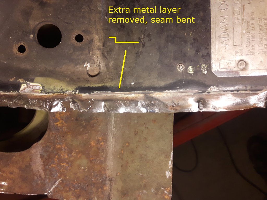

A bodywork mentor once told me to make the firewall fit, it would help to remove one layer of the double-thick sheet metal along the edge where it attaches to the fender. This was my first attempt, I ground through it in some places by accident.
Someone pointed out you zig-zag a double-90 degree bend to make one layer of sheet metal cup under the next, so I used a cresent wrench to bend and rebend it gradually along the edge. Seemed to work. Doesn't show on camera.

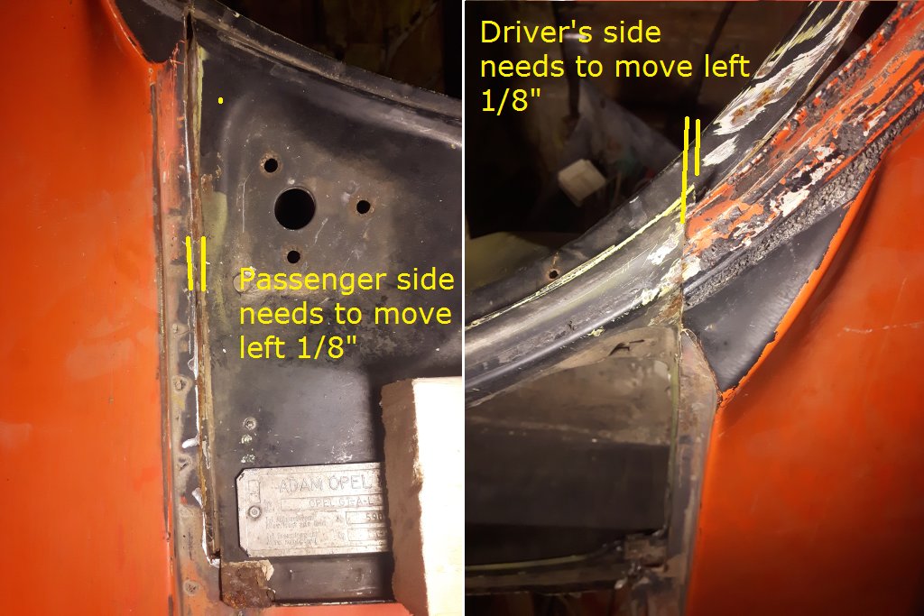

Cleaned up the passenger footwell where the panels will overlap (by about an inch).
The driver's side, in contrast is almost butted flush (I got frustrated in Phoenix and ran out of time, so I just cut once).
I figure, on such a long seam through the air, some overlap is just fine. I'm not worried about water ingress like I am a bit on the floorpans.

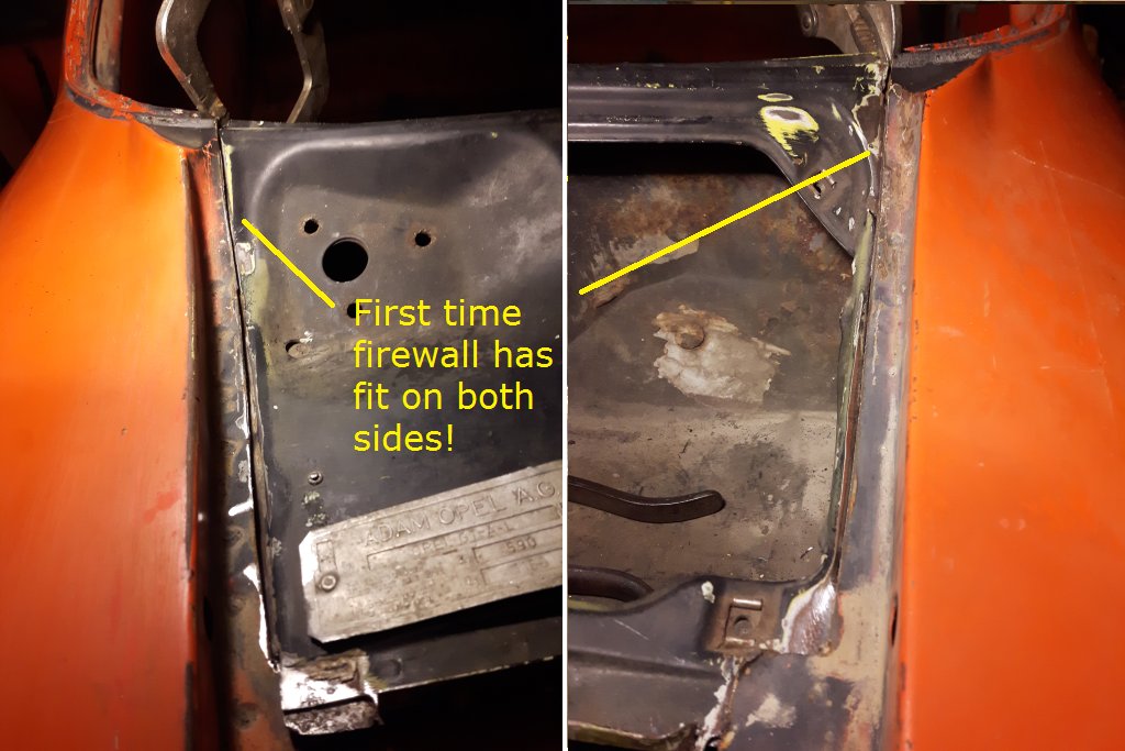

For the first time ever, the entire dash arch of the yellow firewall fits inside the orange body. This is farther than we ever got in Phoenix.
Great success!

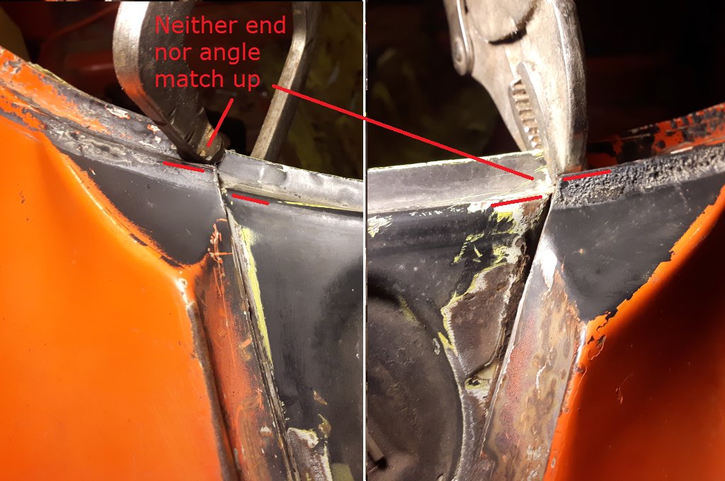

However...
Great failure!

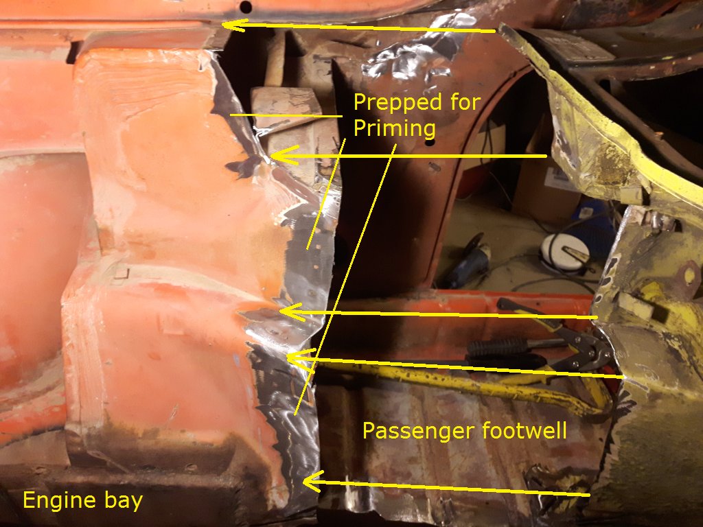

Two issues:
1 - The inside of the lip (the edge) matches, but the main supporting lip does not.
2 - Harder to show on camera, but the angle of the lip is way off. Like, 10+ degrees off (The yellow is angled lower than orange).
Perplexingly, this was not always a problem. I remember it fitting better than this.
I think what has to happen is that I have to tack some of the yellow in place, in the right place (starting here) and then forcing it into place everywhere else. I care about the fitment of the windshield, I do not care about the fitment of the seats and trans tunnel.
I may, after keeping it all this time, chop the firewall into lower horizontal (trans tunnel, floorpan, seat rail) and upper vertical (dash) sections. If you think of them as an "L" shape, I'm sure that the angle of the "L" was deformed during all the prybarring and that's what's forcing the angle to be wrong here.
You're now caught up on progress.

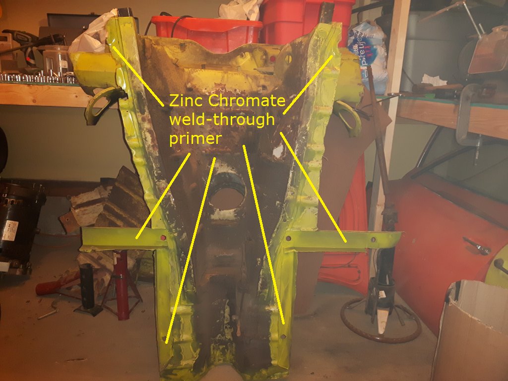

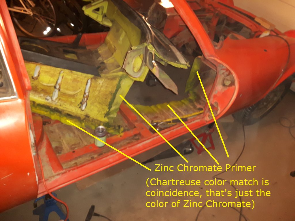

I'm a bit stumped about where to go next, because I'm doing multiple processes at the same time.
1 - What do I coat the cleaned metal with before welding? For example, in the overlapped section, should it stay naked? Do I use weld-through primer? (I've heard that's for aluminum or galvanized steel, but I've had it recommended before on bodywork). Do I use anything?
2 - I'm going to attempt to tack a few spots up top when I can get the dash arch perfect. Then weld in angle iron at the trans tunnel rails at the Yellow/Orange gap on one side. Then shove the bottom end in, and start welding it all up.
I don't know any of the obvious "Before you do X, make sure you Y" or "Don't do X" or "It is critical that you do X", and so on. So, any advice before I ruin things further, now's the time, because it's all about to be a lot more permanent.

But considering I'm using flux-core, I was thinking of making two shields of thin sheet metal on a flexible tube with a magnet base, to basically shoulder every seam with and keep the spatter to a minimum. And/or adding a big rectifier to convert the flux-core to DC at least, cut down on that some more.

Onto the priming party.
I broke apart the two car sections for maybe the last time to prime the joints (feel free to declare your ToldJaSos now, as I bask in my ignorance and hubris). It might not be a lie. Everything might go perfect.
Priming begins. Colormatching is coincidence, that's just the color of the chemical. Oddly, the can specifically says not for use on ferrous steels. Aluminum or galvanized steel only. I tried to look up why but found no reason not to use Zinc Chromate on steel.
I got this far before I realized, on some advice I should do the underside, and anything I'm not going to get around to painting later either so at least it's not bare metal. So I pulled the whole comparment out of the vehicle again.
Two coats. Last (maybe) look at the step-through frame car. Farewell convenience.
Funny how well matched the color of the primer is. I painted it and I can barely tell where it stops and the factor color starts. This is the underside of the trans tunnel, dash up top, seat rails at the mid.
I'm not a welder. I have at most a few hours behind the trigger.
I have the cheapest (and used) flux core welder money can't buy.
I was thinking last night, I have helped family and friends by welding things and fixing things and building things. I have volunteered. I have taught 30 or 40 people to begin welding. But I don't think I've welded on something for me in 7 years. Feels good.
In order to jam the two car sections together, because the pieces are so big they can't just move into place. They have to rotate into place. This means the trans rails had to be cut extra far to have room for the front end of the yellow car to swing through. That means there's a gap to fill.
It's ghetto and I know it's ghetto. It's angle iron from discarded bedframes. I cut it on a half-melted wood-cutting chop saw with an abrasive blade stuck in it. I tried welding inside the box a little, just because I could.
It's ugly, but hopefully it holds up. These box sections nest entirely into the engine comparment side of the trans rails, and then can be wiggled forward through the gap until they're also nested inside the trans tunnel section. Then if all's well, they'll get welded along their seams, welded to fill the gap, holes drilled and rosette welded on either side of the existing trans rails as well.
That's as far as I got. I think it's time to fit things as best I can one last time, and then assemble it all with self-tapping screws and start welding. There'll be a ton of cleanup from the horrible flux-core (and novice skills). I'm especially excited about upside-down welding the floor pans together under the car.
