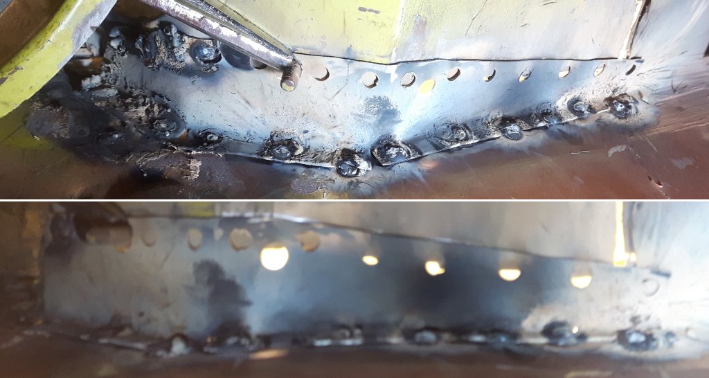

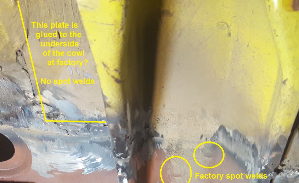

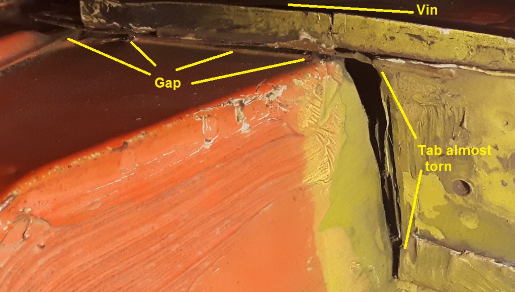

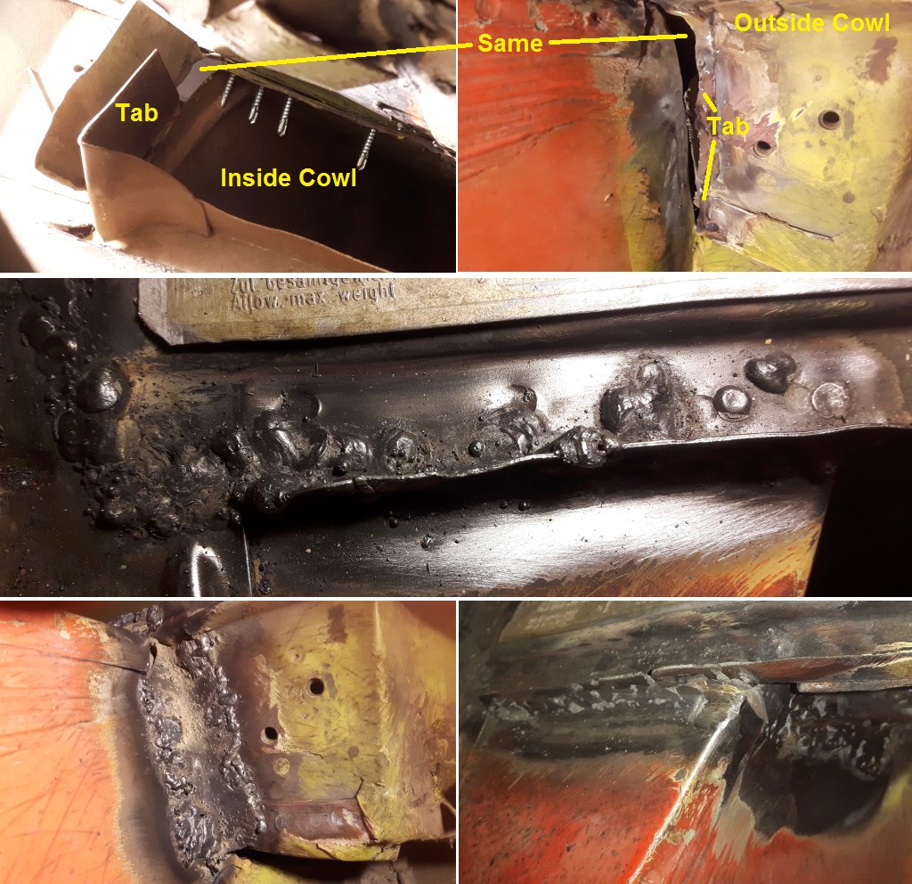

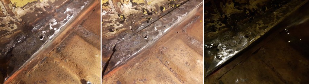

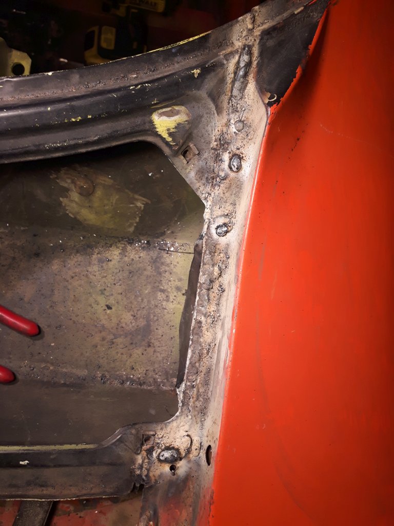

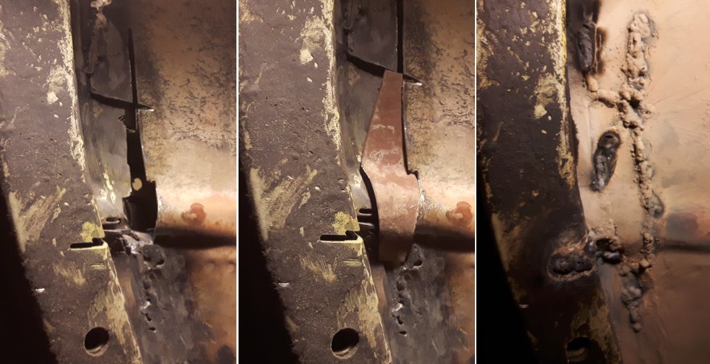

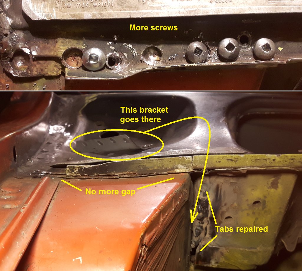

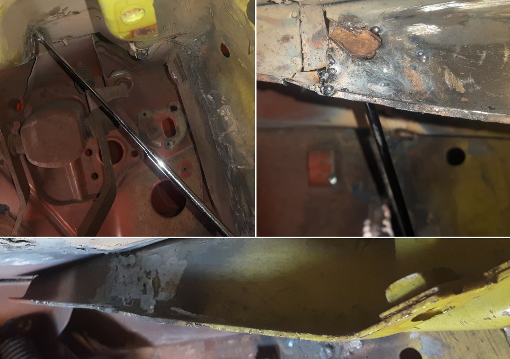

Productive-ish two weeks of bodywork. Four steps forward, three steps back. Frustrating, but, inching progress. Probably spent more time on the car than I have combined since I left Phoenix.

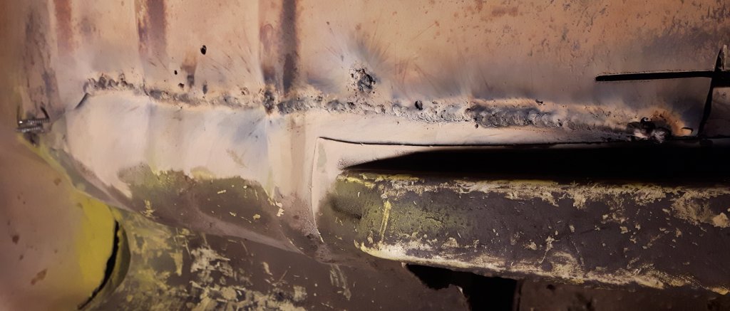

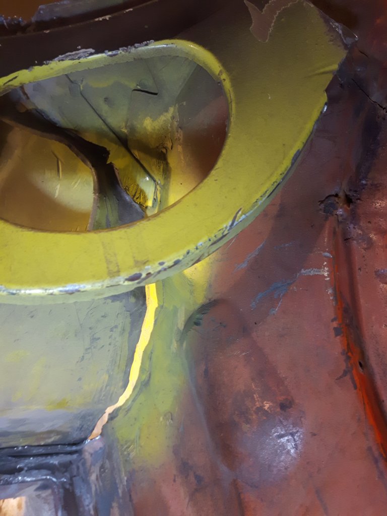

First up, a terrible choice to start on, the cowl seam next to the VIN plate. I had tried drilling holes to rosette weld, but, I lacked a way to clamp the metal underneath. Even my long welding clamps didn't reach or wouldn't fit. So, in the end there was no point to the rosettes, most of them were just holes I had to hover and fill. I both burned through and left holes. Gave up and coming back to it later with more practice since it's a cosmetic area.

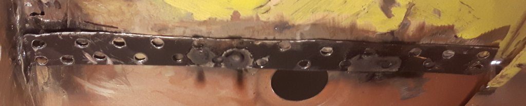

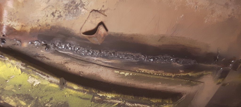

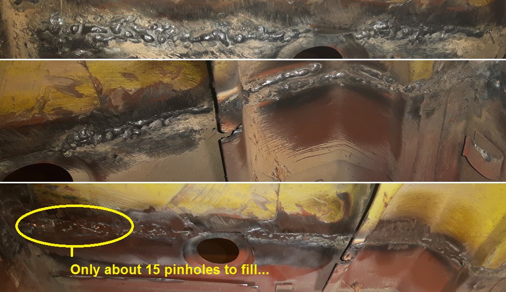

I figured a good place to practice would be the seat rails, since they've got 3 seams, double the metal, aren't really that structural, and will be hidden under the seats.
First up, driver's side:

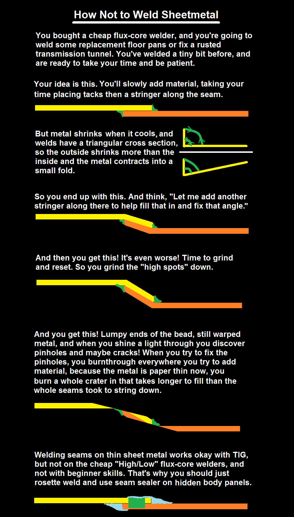

So, this has become my method:
1 - Tack a few places with the 2-setting welder on "Low", then tack as much as I can just to build up thickness.
2 - Try to run a bead (I've stopped doing this). Run 1/4"-long diagonal beads, pause 2 seconds, run another one next to it when it's partially but not fully cool.
3 - Sometimes, flick the welder to "High" and try to run a bead through all of that to re-melt it and fill inevitable voids.
4 - Grind it flush.
5 - Find all the places there was too much material to melt and it left gaps. Also find pinholes. Fill them.
6 - Grind again.
7 - Repeat grind/weld cycle 3 times before most of the holes are covered.
Moving on, passenger's side. This one also has rosette welds to try.
A tangent on this one...
When I was welding the rosettes behind the rear seat bolt, the metal... changed. Hard to describe. It was like it wasn't steel anymore. It looks like I welded across the whole surface, but I didn't, just the rosettes. It was matte grey and clay-like. When I ground it, same deal, was not like steel anymore, soft and gummy. It's right through the base metal. The base got hot, but, not that hot.
Anyone familiar with that?
Could be all the lead paint alloying with steel?
Could be all the zinc and chromium from the zinc chromate?
... end tangent. It doesn't matter and I'm not fixing it, was just curious.

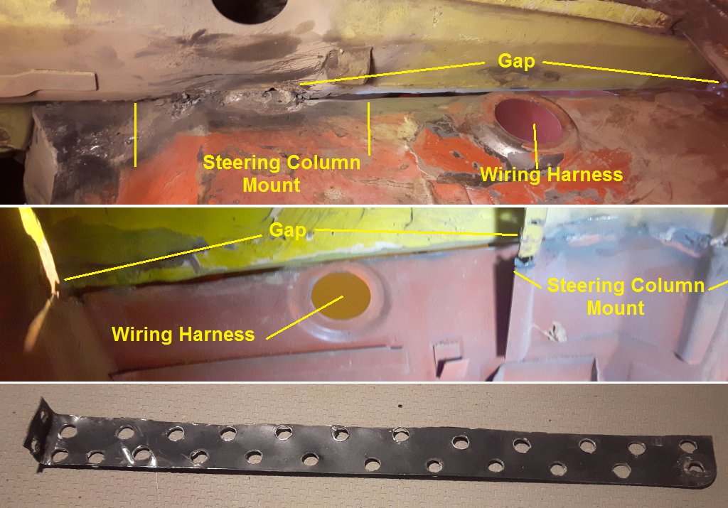

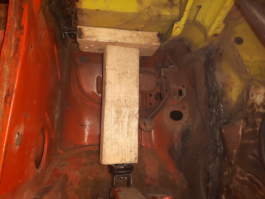

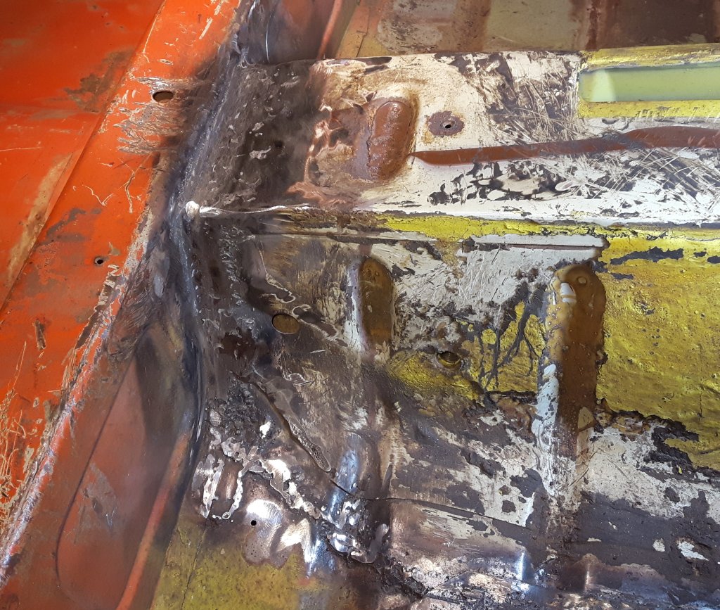

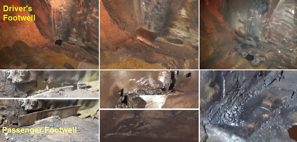

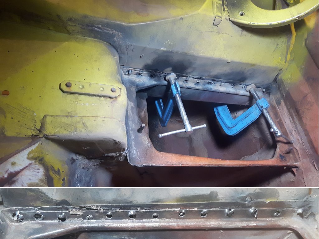

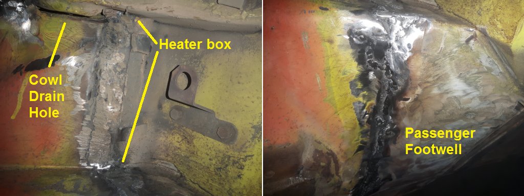

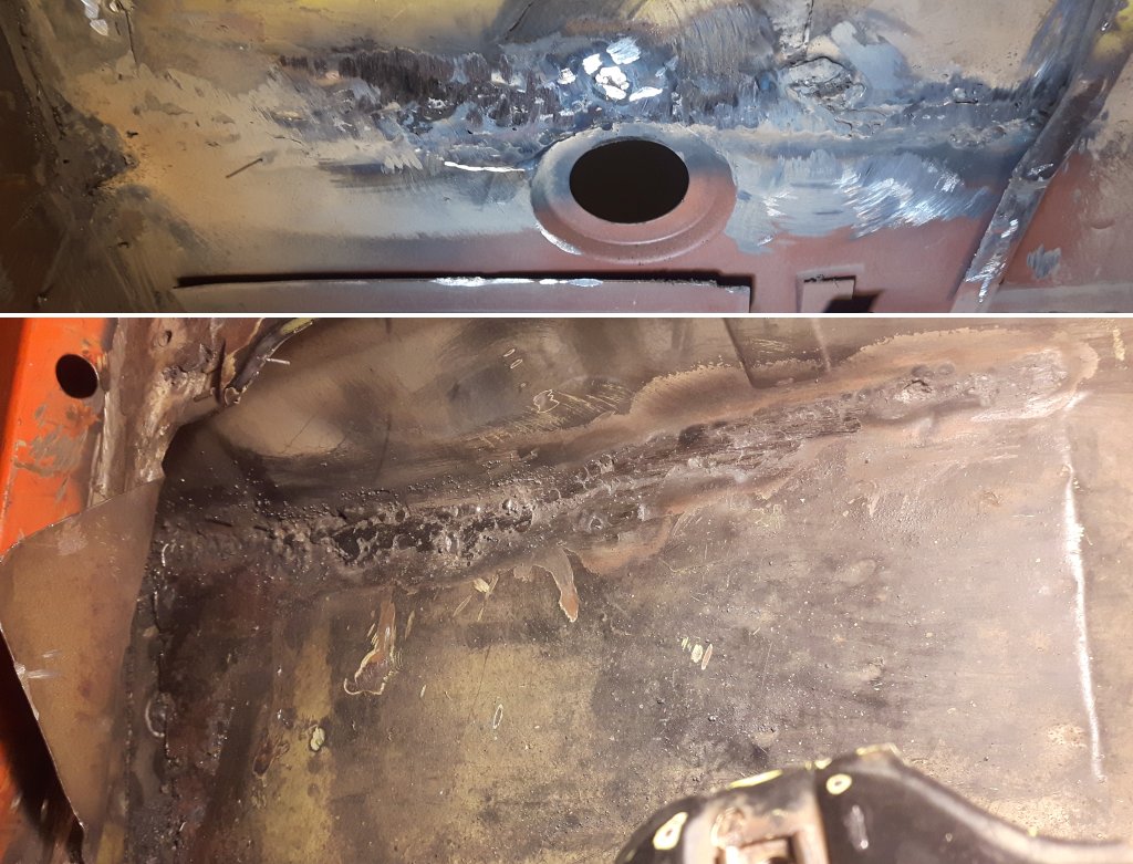

Next up I wanted to experiment with a vertical weld, so I picked the driver's footwell, under the cowl. I remember hastily and angrily cutting this at Doug's place, knowing there was no extra overlapped material as usual, because I was running out of time and worried about how I was going to make the two body sections nest together for the inspection.
I just ran the grinder vertically downwards, lined up with where the wiring harness sprouts from the footwell on the top portion.
Except, despite lining up perfectly in the transverse direction, there was this whole extra triangle section missing in the longitudinal direction. I couldn't figure out what I did. Had I bent it? Had that panel gone sideways for that triangle and I had cut it?
These are great questions for someone who cares what the panel up behind the dash looks like. Instead I got tired of trying to figure it out and used the 3rd biggest hammer I own. Done.
My smashing job didn't result in a great fit. Especially where the metal changed directions. So screwed a 1/2" strip of sheet metal to fill the little gap left.
I chose... poorly.

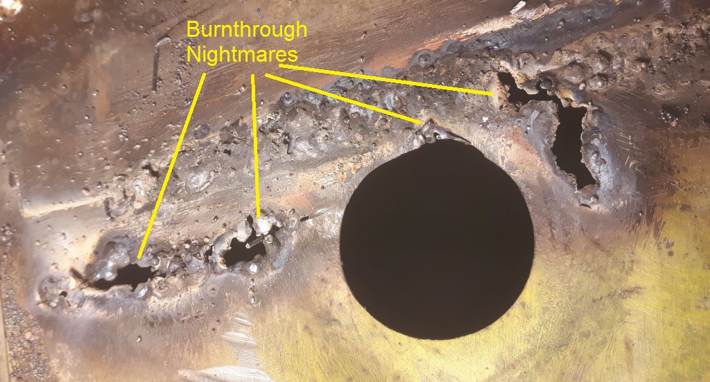

I tried welding from inside the car, at arms-length (can't fit into the area to see better). It added some material but, I could not get it to fill.
So then I welded on the other side, in the engine bay. It just kept feeling like there was more to weld. I welded down the middle. I welded at the edges of the filler piece. I added so many puddles that dripped and ran down the metal that I turned the welder to "High" and tried to fuse back down to flat.
By the time I was done it looked like I'd stapled a crocodile to the metal. There's probably a half pound of wire in there, and STILL holes everywhere.
Then I tried to clean it up and grind it back to a reasonable thickness. Went through almost a whole grinder wheel until my hands were numb. Took off way too much material and exposed some holes. Dozens of holes. Ugh.
Vertical welding sheet metal in a place that I can't reach or see much of what I'm doing is difficult. I gave up for now and moved onto the floor pans.

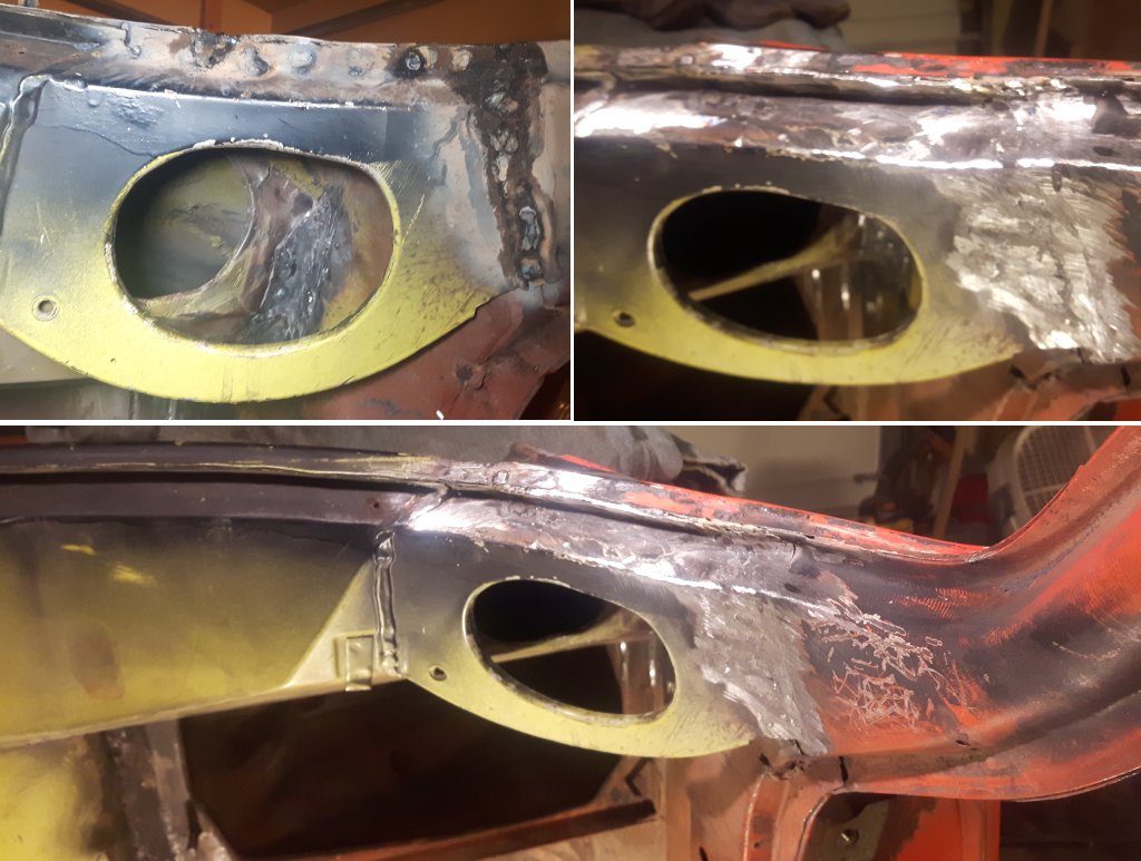

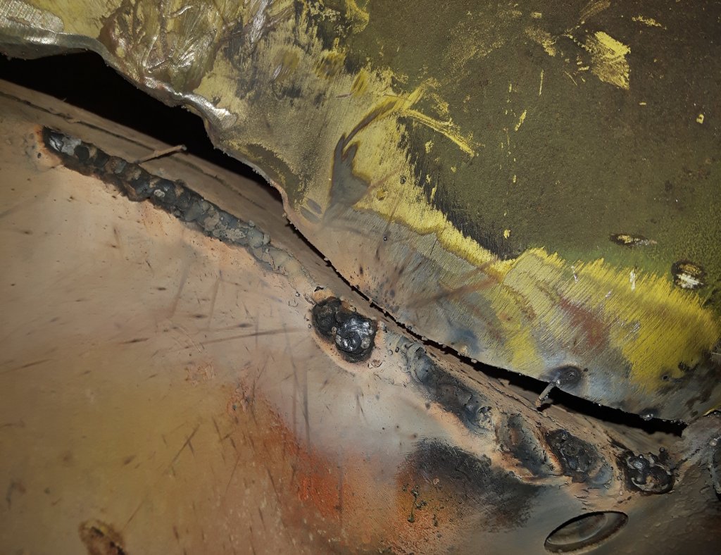

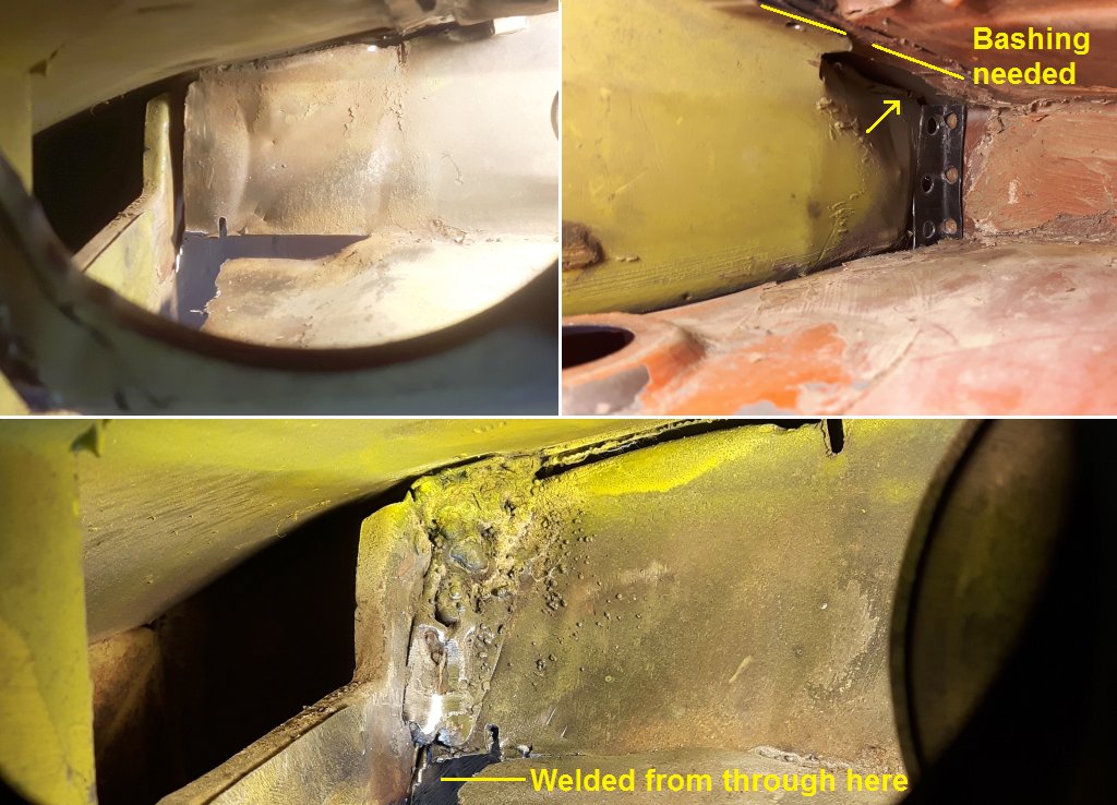

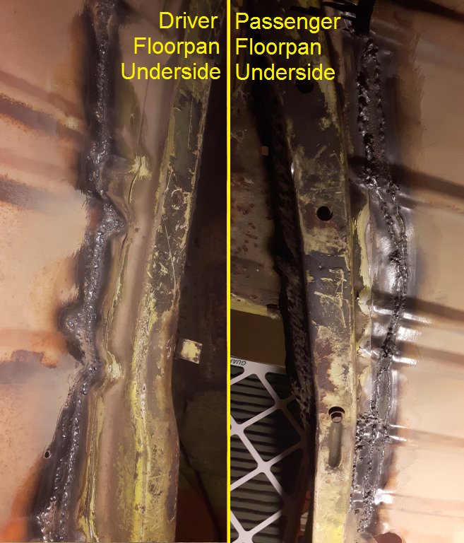

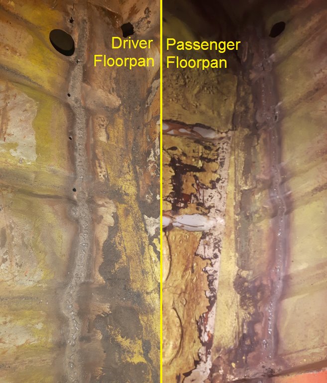

Oh, and I upgraded my welder by adding a 150A FWB rectifier, so it's at least DC now instead of AC. Seems to have predictably cut down on the spatter.
This actually went pretty well. Slow, but, measurable progress with no unknowns.
What's odd is that the welds look much worse than they are. When welding, I can control the puddle well, nice and smooth, steady, it goes where I want it to, and it fuses the metal together. But the metal I'm adding doesn't follow the puddle. It wanders and drifts off up to 3/8" away as it cools, usually towards the nearest other glob. Hence the crocodile look to it. It's almost like I'm TIG welding, the base metal is fused, but I'm adding globs randomly to the surface like I'm using a hot glue gun. This isn't a problem, since I don't actually need extra material and am removing it later, I just need the puddle to fuse the metals, but, it looks bad.
I didn't rosette weld since the overlap was so narrow most places. I just followed my procedure from the seat rails, and then went to run a bead underneath.

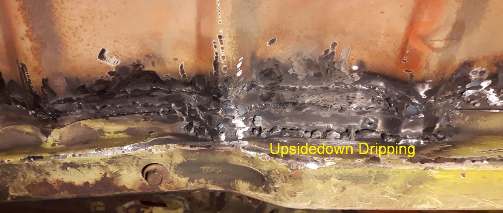

Welding upside-down was, as expected, even harder than vertical.
There's no forgiveness. If you overheat an area, it will drip. If it drips, you cannot just weld hotter overtop the same area like you can from top-down. Any attempt to fix it just makes it drip more. You have to stop and grind it.
Also, I don't have room for my welding mask and the creeper, so I'm worming along the floor. And, welding off to the side. But not enough to the side to have room for my shoulders to to be sideways. Between that and trying to apply pressure upside down with a grinder (having to lift my arm and the grinder, rather than using those weights to do the grinding for me), it's fairly exhausting. I have to stop every few inches.

This is the most frustrating part of the process because, with a flux-core welder being so poorly suited to sheet metal, it will often take 3-6 attempts at a seam before I caught all the screwups. And, I can't alternate weld/grind/weld/grind/weld/grind, I have to do all my grinding at the start. So it's become that progress has slowed to a stop because I'm bottlenecked on grinding. And I'm getting nothing done and I only get one chance per day at fixing a mistake. I'd very much rather "Oh well, grind it flat, try again" back and forth without having to change positions and jigging, and get one area finished and feel good about completion, versus having to juggle all my mistakes across the whole car every day, trying to re-establish the position and jigging, and never get anything done.
I've been at the shop every night for the last 2 weeks, and I get done maybe 1 foot of welding done per night by the time I figure out how to get access and set everything up and do 2 or 3 passes after fixing yesterday's mistakes. Over half my time is moving stuff around rather than just getting work done.

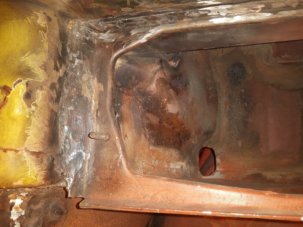

Here's a shot of the floorpan, welded from both above and below. Haven't had time to grind yet. I think the upsidedown stuff is decent, I'm clearly getting penetration through to the top side, stopping just before burnthrough most of the time.

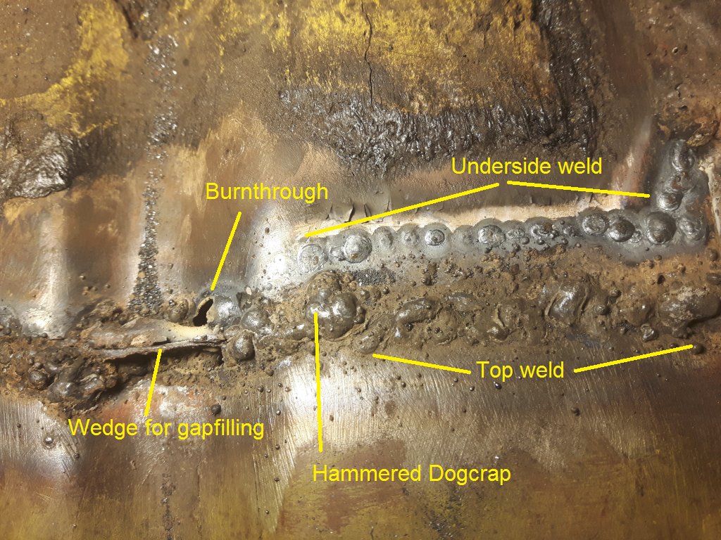

More frustration. Sometimes, even waiting 5 seconds between the shortest possible tacks, a burnthrough results in "pushing" the pinhole an inch or two before it even starts to close. I've resorted to just holding the trigger and clanging around the hole like you'd call farmer's for lunch on a triangle. Eventually all the edges are thick enough to actually hold a tack and start to close. Then it has to be all ground then probably welded again once or twice again later.
Trying to be persistent but it doesn't feel like progress anymore.
Last bit of welding I've done is some of the underside of the driver seat rail. This is the side that didn't have room for rosette welds.

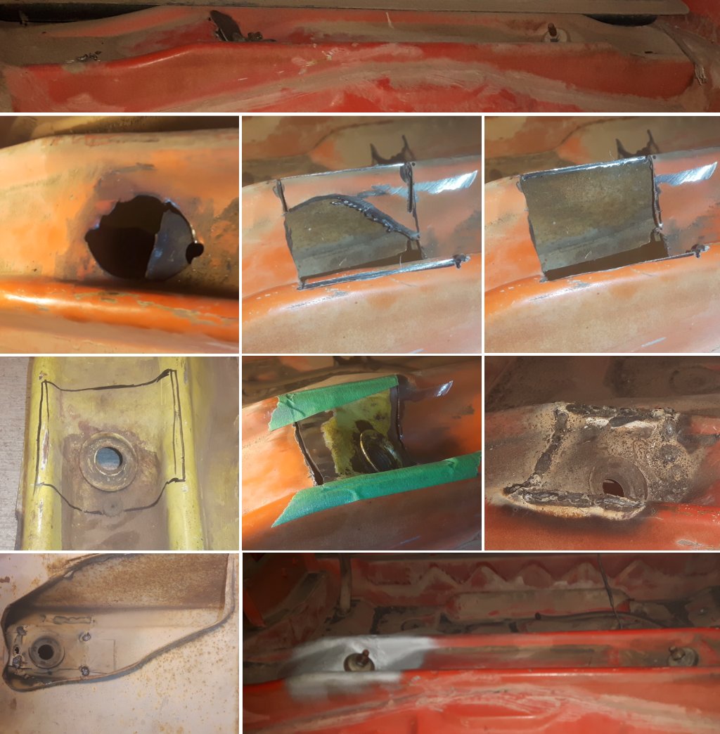

The reason I haven't posted any updates isn't because I haven't been working on the car. I've actually been working on it almost every spare night for 2 months since my last update, and given a choice between documenting and working, I've been working.
Also, because I can only grind at the start of the night, not when I'm done, all my pictures are of ugly welds rather than what I clean them up to be when I run the grinder again. So I kept putting things off until after I'd grinded.

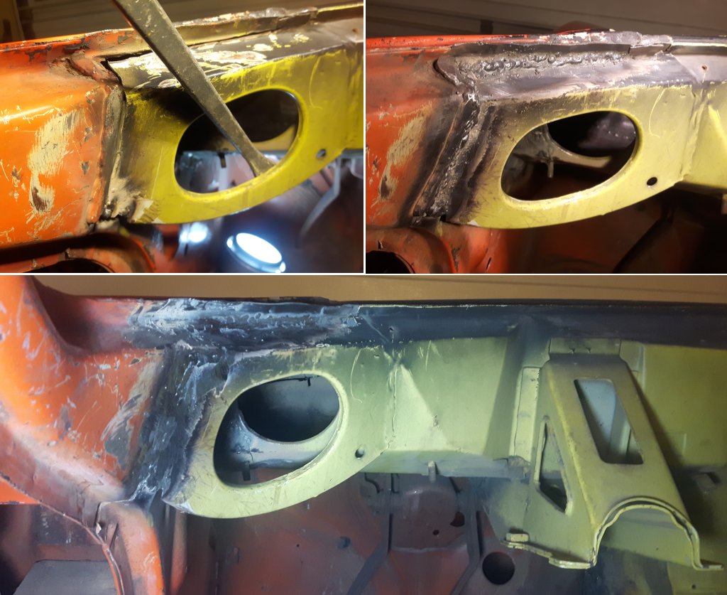

Bodywork Update:

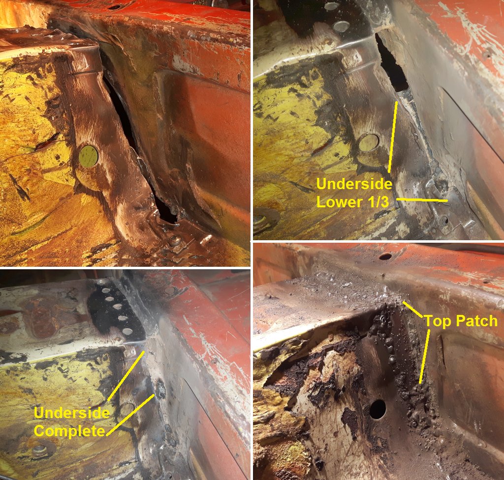

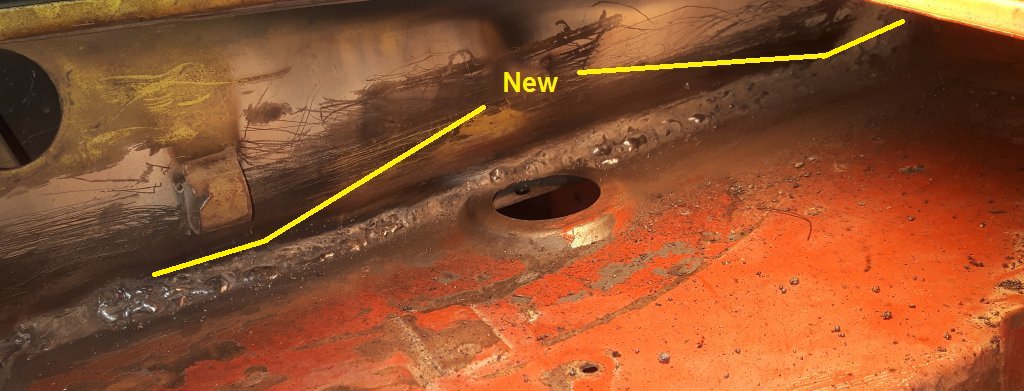

- Welded underside of passenger seat rail. First pass anyway. And there's a 4" triangle that starts on the right that I need to patch under the seat rail where I over-trimmed.
- Welded first pass on driver's side cowl. Came out a lot better than the passenger side because the opening into the cowl is 1/8" away and it could be clamped tight (passenger side has the vin plate and isn't accessible for at least 10", I don't have clamps long enough). I later cleaned it up and grind it smooth and no second pass was needed.

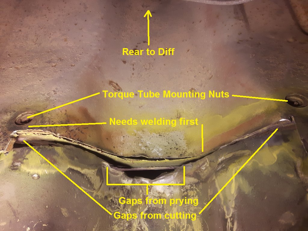

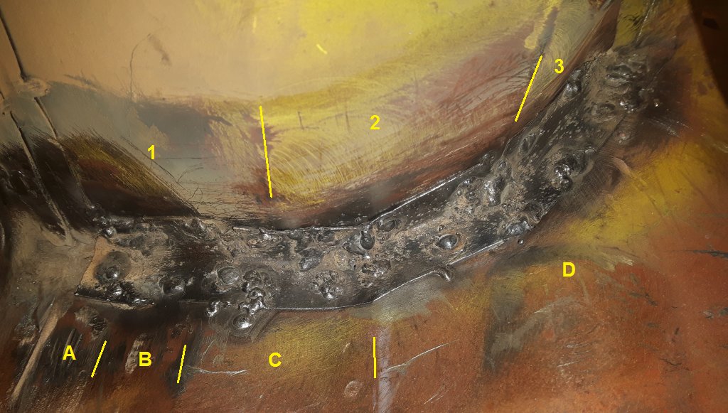

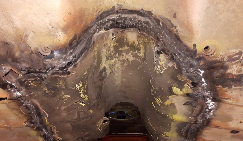

- Next up, a 13 hour work binge to mostly finish the biggest gap, the back of the trans tunnel where it means the parcel shelf box frame. There's a 1" gap because I had to cut extra to angle the whole yellow trans tunnel/firewall/cowl section into the orange body. It's also beat up from being pried on by 3 men.
It's actually 3 layers of metal:
1 - The square-ish top of the trans tunnel.
2 - The round underside where the driveshaft passes, and
3 - A second hovering rounded shell of heavier gauge sheet that reaches from the diff to just inside the trans rail, perhaps to protect from torque tube failing and puncturing through the car.
The handbrake lever cavity is formed between layers 1 and 2.
Also, either the previous owner when removing the trans tunnel, or me, trimming it flush, left the edge of the floorpan loose from the parcel shelf box, so that had to be welded first.
Here's the underside:
And welded, poorly...
Naturally I don't bother to straighten the trans tunnel floor *before* I shove the trans tunnel in place and weld the seat rails. So then I had to straighten sheet metal from a gap I couldn't even reach pliers into. I ended up cutting a 2x4 into an arch, propping it against the underside with a jack, and using the 2x4 as an anvil. A ratchet extension as a punch and I mostly flattened out the bottom sheet.

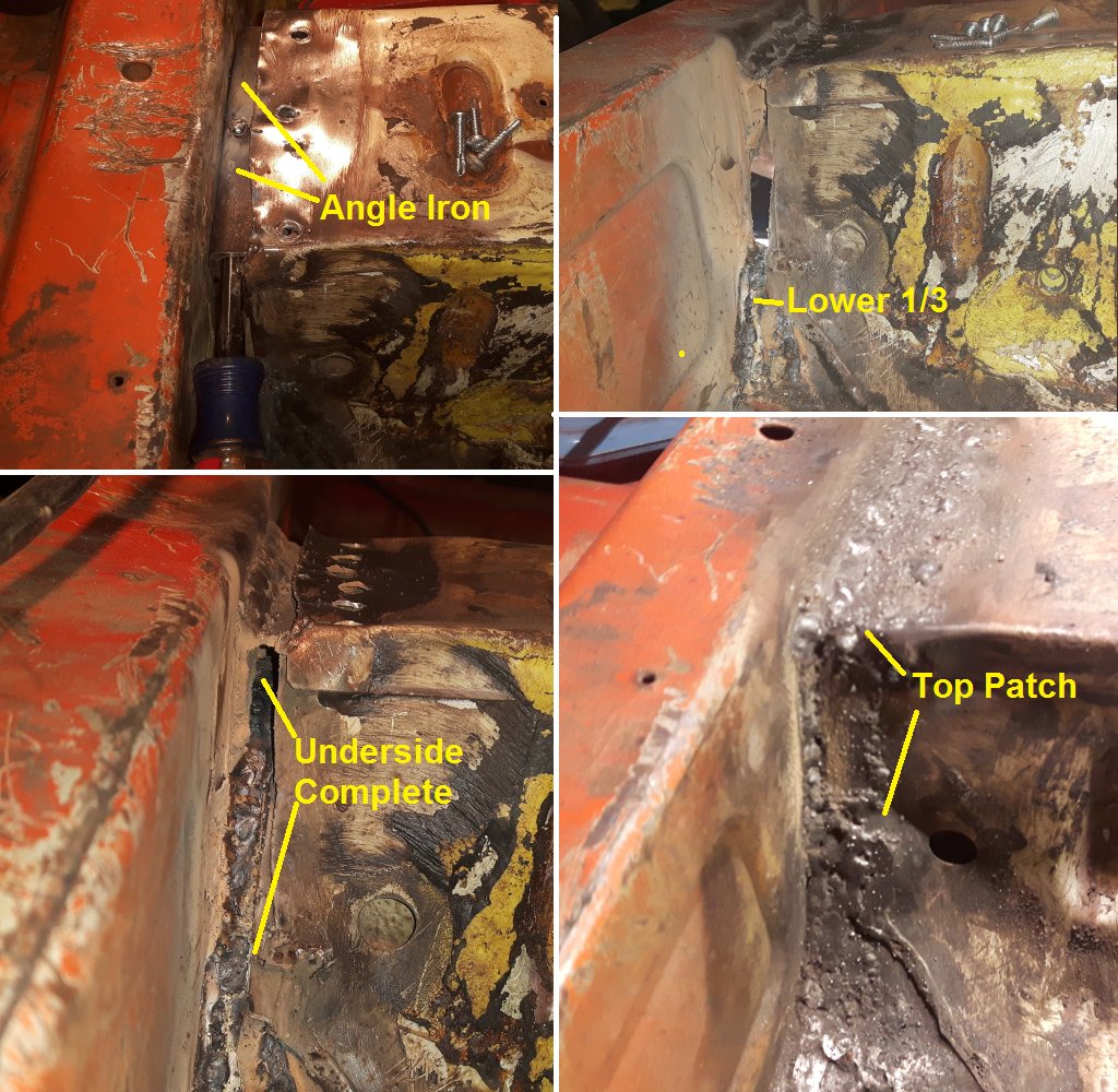

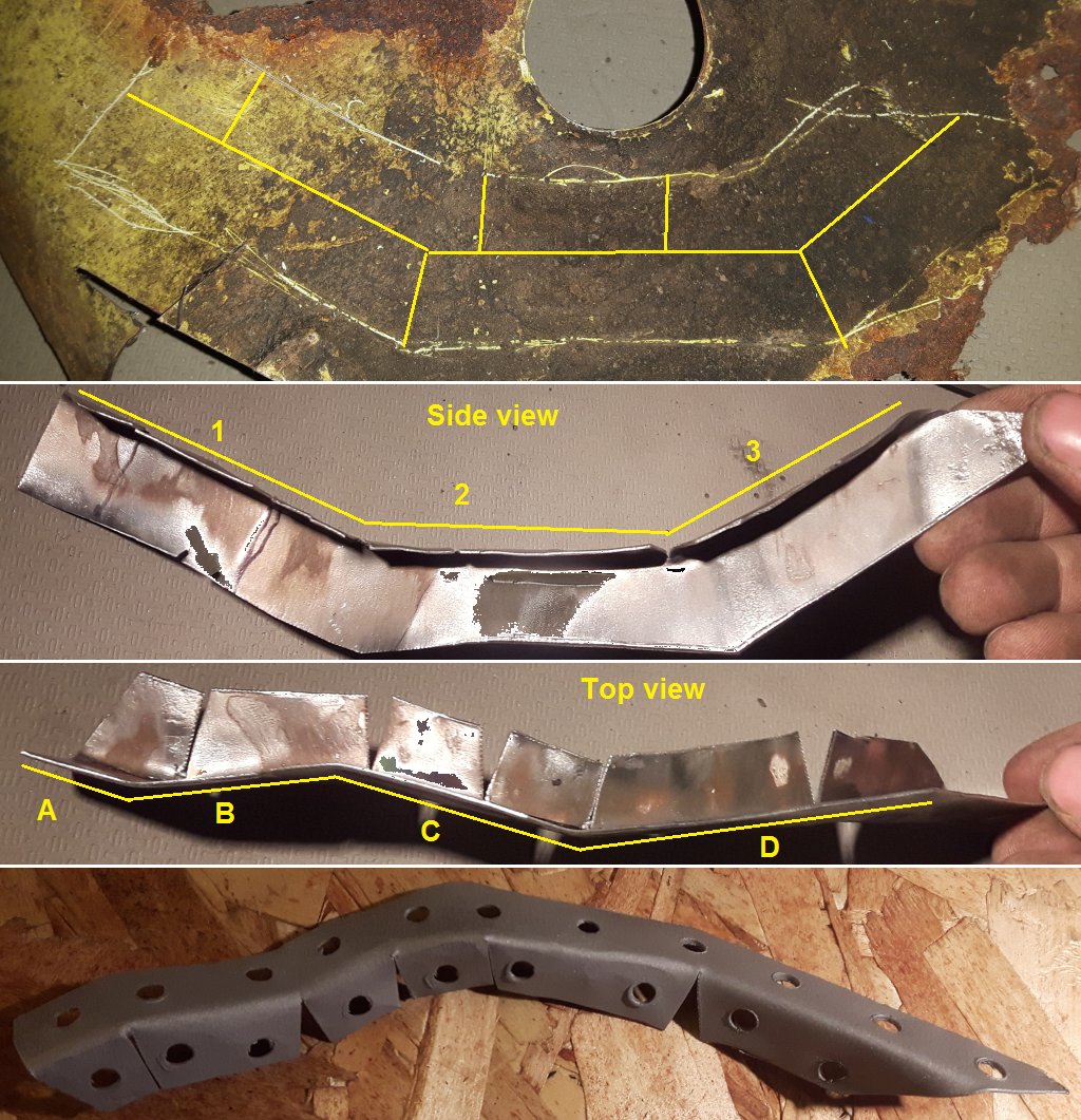

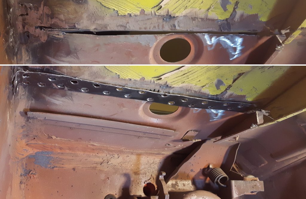

- Next up, I wanted the back of the trans tunnel to be strong because I knew I had no way to rejoin the middle layer of sheet metal. I could weld the bottom and the top but not the inside. I cut up some bedframe angle iron, chopped it in half, hooked the pieces in from the middle of the underside, then lifted them together and tacked them into place. This took like 8 tries because there's no way to hold them and they kept slipping on me and falling back to the floor after I'd already crawled out from underneath, but, persistence worked. Slagged the back rail and filled the rosettes on top.
- Gap-filled in 5 pieces. The lower part of the arches on either side, the underside of the top, and then top of the arches on the side. The difference in the gap between the bottom (round) sheet metal and the top (square) I just filled with probably a pound of weld about half way up until they got too far apart to make that sensible. I figured by the time I tried to weld a 3/4" wide strip 4" tall, with only 1/4" gap, I'd just up with so many holes I might as well fill it solid anyways. So I did. The only patches were on the top 1/3 where the square sheet starts to really rise above the lower arch.
"Done", after some grinding:
And the underside, and I also connected the last 8" on either side to connect to the seat rails, which means the underside sheet metal is "done", at least a first pass:

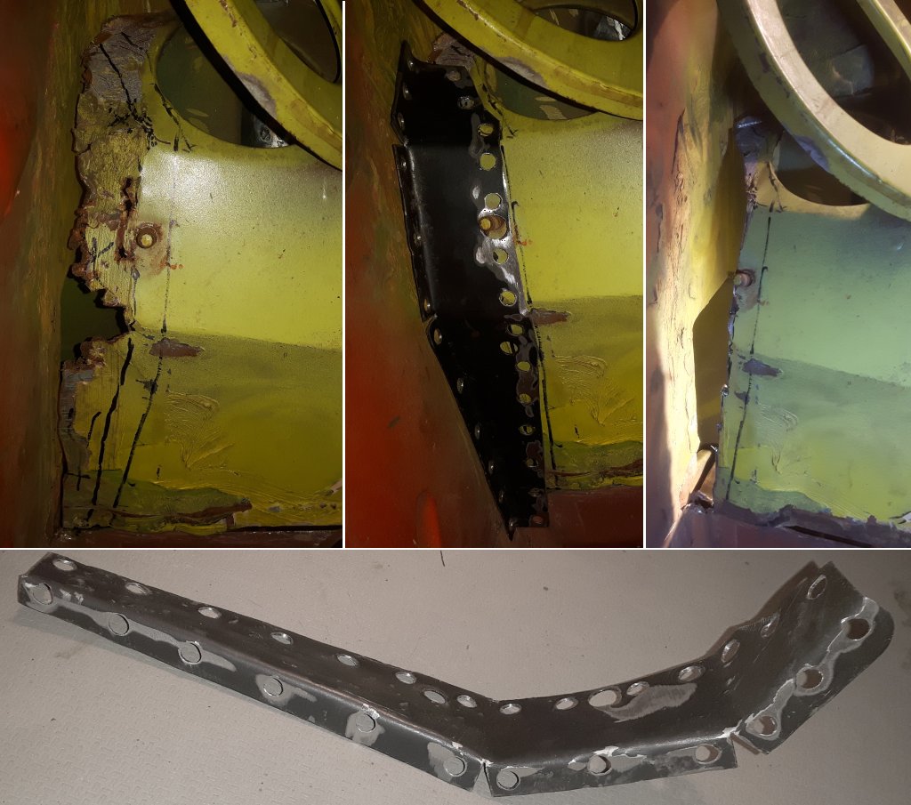

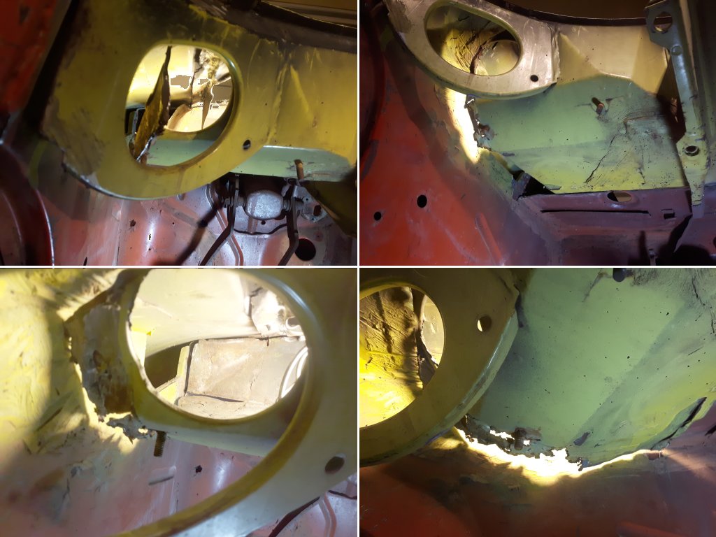

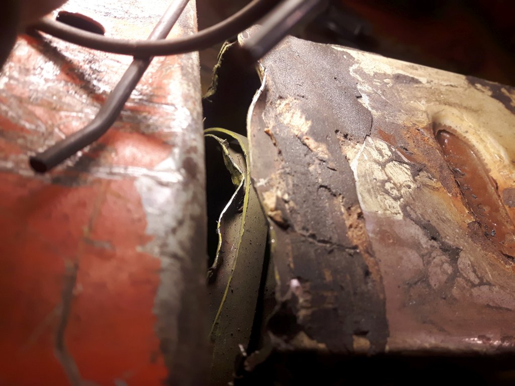

Around this time I noticed the floorboards had rusted through in what I thought were "good" original Orange-car areas. Tried to patch and still left holes. I've wirebrushed and spritzed with Evaporust every day for a couple weeks and it looks like those are the worst of them, so maybe just fill them rather than patch the whole panel.
My big push for that month was to finish the seam at the back of the trans tunnel so that I could bolt the torque tube on and have some choices as to what I wanted to work on if I burned out. I.E. Instead of endless bodywork, with the torque tube attached and no worries about welding near it, I could start to plan the electrical driveline for variety if nothing else.

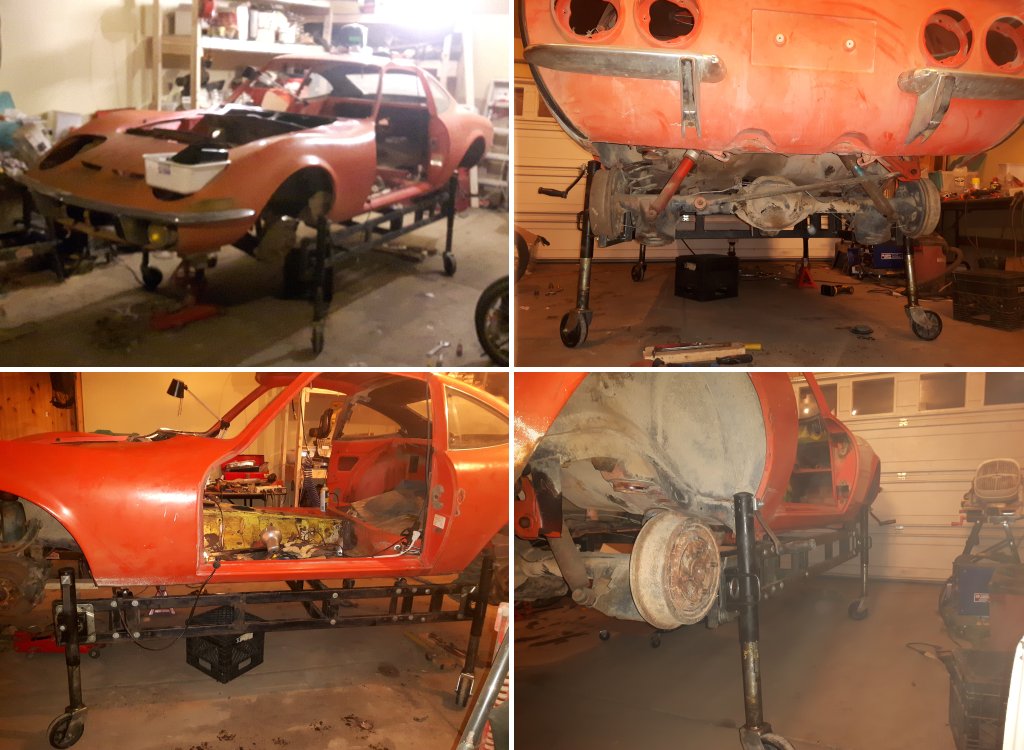

A friend sold his GT rotisserie to a gentleman who will end up not needing it until the summer, so, he offered to let me be borrow it short-term on a kind of "get my ass in gear" basis until then.
This, naturally, after I'd just completed all the cramped upsidedown welding from underneath the car. ("all, mhm", sneers future me I'm sure).
The rotisserie takes up 2' behind and 2' in front of the car, and I thought it'd be a bit tight, plus it requires welding up support inside the vehicle. So I opted to borrow just his body dolly instead.

For weeks, I couldn't even use the creeper under the car because with the jack stacks maxed out: Creeper, Me, Welding Helmet, pick 2 of those 3 there's room for. So every weld I'd be laying on the cold (Canadian) concrete floor, bucking and shimmying 2" at a time, all the way under all the way back. Welding upside down with my unsupported head back and arms stretched horizontally. Every time I forgot a tool, needed to adjust a lamp, needed to piss, wanted to take a picture, cramped up, or even just wanted to turn and face a different direction (my shoulders are wider than the car was off the ground), was an excuse to just quit for the night rather than crawl all the way out and all the way back under. And there's never room to get out from beside the car either.
Lit my beard on fire thrice from rebounding sparks. Lit my hair on fire when the bandana slipped off. Ugh.
For anyone who doesn't own a body dolly or rotisserie, especially for body work, I can't emphasize enough how huge of a difference it makes:
- The night it was installed, I yanked out the rear assembly and sat cross legged where the diff used to be.
- When I want to work beside the car, I can shove it sideways.
- Any time I'm under the car, I'm comfortably on the creeper. And I can roll and switch which direction I'm facing.
- Any time I need to move under the car, the dolly's framework is like monkey bars, one hand can spin or move you anywhere you want to be. You can brace your arm, or tools, or rig clamps off of it.
- Whatever the perfect height to work is, up or down it goes.
- Any time I'm leaning over or crawling into the engine bay? The car has a scaffolding around it that fits my steeltoes.
- Want to film what you're doing? There's distance between ground and car to frame the shot properly.
- Want to see what you're doing? There's room for a lamp to cast light rather than just a spot.
... And yeah, it feels like cheating.

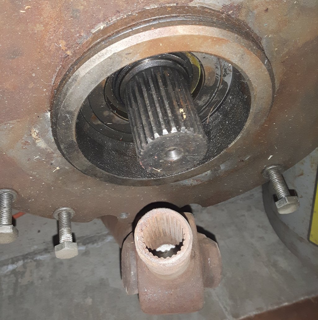

First thing I did with the body dolly up, was want to inspect the rear assembly. Since I'm borrowing someone else's garage as a shop, conditional on them not needing it, I was never comfortable taking the rear off because it would be stranded on the jackstands. Now that it's on the body dolly it's not as big of a deal. I could at least roll it to the driveway on 5 minutes notice.
I had been spraying insides and outsides of all suspension bolts at start and end of every night for over a week so I figured they'd all be loose. They were. Except for one...
Oh the nut came off easy enough. And the bolt side spun on its own just fine. But the bolt would not come out.
I worked it back and forth. I spun it. I slipped the nut back on and sledgehammered it until the mounting bracket was bent like you can see in the photo above and the nut was mashed like a scoop of ice cream. The bolt would just not separate from the control arm.
Eventually I just spun it with the impact wrench until it started smoking, but all that did was tear the sleeve away from the rubber.
I ended up having to take an angle grinder to it 4 times to chop it down.
I presume the whole rubber and sleeve are pressed into the control arm, but, no matter, since I had an extra set from the other vehicle.

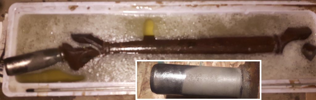

As I was stumped for quiet things to work on, 2 filler tasks had been occupying my time for the last month:
1 - Pick away with a screwdriver at the rubber sheet covering the trans tunnel.
2 - Clean up tools and vacuum out the weld/grinding dust.
I was actually stalling for time, because someone had told me an easy way to remove it was to use dry ice to superfreeze the rubber, then smash it with a hammer. Brian here had mentioned that it gets cold enough in Canada to just let it sit outside on a cold night, and then come smash it just before dawn.
I didn't want to take the car off the jackstands and push it outside until I was done welding, but then the obvious hit me: "Just open the garage door, point a furnace fan underneath the car, and kill a half hour in the driveway with the car running until the Opel is all frozen."
So I checked the weather and it looked like we weren't going to get any more cold (enough) snaps this year.
Abandoning ship I bought a wire cup for the grinder and stripped it off manually in a few hours. Feels dumb that I waited weeks for cold weather just to avoid a few hours work. It's not that much work.
I'll come back and finish it up with a paint scuffer later. I just needed to check for holes, since I noticed a pinhole just below the headlight lever. Again, my goal being to not be welding in the trans tunnel anymore so I could rig up the driveline.
Umm... hmm... hang on, I'd lost the pinhole I spotted earlier...
Uhh, a bit like Clever Tom and the Leprechaun, minus the red ribbons.
I'd run out of easy stuff. The lower, flat, and long weld seams were done. I figured the next thing I do should the be the strongest and the easiest to line up. That was the heater box. I left lots of metal (the box is made of thicker sheet) and lots of overlap when I first cut it out, so I knew it was located well.
Welding went mostly okay, it's hard to reach there. You have to lean over the rockers, around the doorframe a bit, and then forward and then sideways.
Also, these were my first inside corners on the vehicle. The grinder wheel can't reach every area on an inside corner. I bought the cheapest die grinding burrs (rotary files), a $40 8-pack, and they were all junk. Suitable for aluminum maybe. I'd get maybe 20 seconds of grinding out of them before they'd dull. More on that later.
In general, it was a treat to not burn through the second I touched the trigger, if all metal on the car was this thick I'd be fine.
Now that the side of the passenger firewall was anchored at the correct height and width, I could do the long seam.
I originally thought I'd left far too much material here on top, but once I actually sunk the tail end of the trans tunnel down where it needed to be that last inch, it really pulled the dash area back. I was left with butted metal 1/2 way up and even a gap at the top.
Frustrating weld. Get the weld done in about 20 minutes, patiently, 1/8th inch at a time, then an extra stringer on top to make sure it's not just sitting on the surface. Even then, like 15 pinholes. Kept climbing into the engine bay and back to try to fix them. Spent a whole night just on fixing some of this seam before giving up with trying to grind flush.

Amateur Welding Tangent:
This was the moment I decided that from now on, no more butt or seam welds.
My early logic was: "Don't rely on seam sealer, take your time, weld the whole edge."
I'd been suggested a variety of advice on bodywork and did perhaps the worst thing, tried to mix it.
Option 1 - Overlap sheetmetal and rosette weld.
Option 2 - Zero overlap and butt weld.
Option 3 - Overlap, rosette and then seam weld, best of both?
Instead, I thought "Option 3 seems like overkill. If I do that, I'll have 3x more linear feet of weld than I have of seam. I'll skip rosettes, just overlap and then seam weld. If I think it's too weak, I'll drill through one sheet after and rosette weld to add more strength.
And in my hubris, I perhaps misattributed why spot welds and seam sealer are done, thinking it was only for cost. I thought I'd just take a bit more time and do it "properly".
Here's a diagram of where I went wrong:
Posted that to a welding forum for the guys to get a kick out of.

Back to the heater core, the cowl was floating pretty high above it, so I wanted it clamped down. Went through all of my clamps before I found some both short and deep enough to go up, around the drain trough, and back down (they clamped a piece of wood).
Just needing enough tacks to hold them together. I didn't want to weld more until I figured out how I'm going to grind inside the corners.
Positioning was stupid, it's not that far into the car but it's just about impossible to reach. And if I can reach, I have nothing to hold my torso there while I use my hands to weld. When I went back later, best I could figure was to lay on my back with ass on the edge of the parcel shelf, seat rail grinding into my back, one shoulder in the footwell, reaching upwards to wash myself with the fountain of metal dripping down. Caught my hair smouldering again.
Moving to the right, I next had to weld the underside of the cowl to the side of the car. There's at least a 1/4" a gap here, I'm not sure why. My thoughts:
1 - It was cut properly, but my fitment is terrible (and it's way too late to change).
2 - I cut it out that way (it's about a sloppy angled cut with a cutoff wheel).
3 - I cut it properly but in the mad dash in Phoenix to shove the cars together, I discovered there wasn't enough draft angle to actually make the pieces fit, so I trimmed it.
In any case, with rosette welds being the new commitment, it was time for my first bracket.
I should have picked a simpler bracket for my first.
The passenger wall isn't straight like the driver's side is. The passenger side has has 4 different angles in the vertical direction, and the cowl has 3 different angle changes in the horizontal direction. None of the angle changes match up with each other, so the resulting bracket requires 5 cuts and 7 different bends.
I did make a design error. You get to choose which side of the bracket is flush, and which has cuts taken out of it when you do your origami. If the pieces you're joining butt, then it doesn't matter. But I chose for the flush side to be the wall, and made my cuts along the cowl. The cowl is floating off the wall by 1/4", so all the missing "V" sections had air behind them (versus, if I'd done it the other way, the wall would have the "V" sections, and it doesn't matter because the wall is continuous).
Not that it matters, the welds came out hideous. So much for a pretty bracket. The footwell is no wider than my welding helmet, and I can't reach or look across from the driver's side over the trans tunnel, so this was all welded somewhat blindly with my left hand from me using the rocker panel as a pillow, my hips balancing on a chair outside the car, and me supporting myself into position by lifting myself up on the A-pillar like a monkey. If I had a 3rd arm or a bored child I'd have used them to take a picture.
Let's try the driver's side!
Friends in Phoenix had helped bend up the edge of the cowl (no way to make it angle itself in otherwise), so that had to be straightened first. Revealing... damage that's not my fault! The front of the yellow car had disintegrated over 50 years, and the cowl had already rusted through when I got it.
No problem, I'll make a wider bracket and cut away the rust. This bracket donor material, courtesy of a BBQ wing (1mm, same as most of the Opel). This time I put the "V" sections along the wall.
Side stepping for a moment, I have to figure out how to weld the far, inside vertical corner of the cowl, since the driver's side doesn't have the heater box, the cowl continues to an underhang below the fender.
A little bracket. A little bashing. And using the gap I just made cutting away rust, I can sort of weld, a tiny bit. A bit more. Missed a spot. Oh well, hold the trigger and hope it fills.
My quality is plummeting. But no one will ever see any of these brackets, ever, after I finish the car. My shame is mine only to bear.
Next, the fitment issue with the gap between the cowl and the driver's footwell. It is what it is, I prioritized the windshield arch and let this be the result.
Not a problem, another easy bracket.
Great, so it's time to weld each of those in. Starting with the side. This is even worse than trying to weld in the passenger compartment, because you're welding 6" deeper into the footwell, the pedals won't let you go as deep, and the steering column support won't let you work perpendicular to the weld. So you're upsidedown and sideways again.
I weld along the side, start doing the underhang, and then notice... what the heck is going on with my holes? The one big hole was already there in the scrap piece, that's okay, but why can I see light through the others?
HOW DID I CUT THAT SO WRONG? I didn't just measure. After I made the bracket I also held it up and traced the outline. Then drew my cut line.
Great. So much for remembering to put the cut lines on the correct side. Now I have 6 semi-circles to fill. One step forward two steps back.
How did I not notice this earlier before I'd welded half the bracket on? Because the angle you're seeing the pictures taken from, are angles that are possible for a camera, but impossible for my head to be in. And even if I could, there's nowhere to put a light that wouldn't be blocking my vision, so it was dark.
At this point I put the camera away and finished the welding without it. But wait, it gets better, then worse again!

Here's the underhang at the edge of the cowl and the bracket, pretty simple:
It's quite a gap to fill, so gotta make sure I fixture it right:
Easy enough. Weld from above first. Do the middle first, come back and move the wood to do the edges later.
From above, that worked amazing. It's been a month since I welded something that wasn't vertical or upsidedown. Not a single burnthrough either the orange footwell or the yellow cowl. I even lay an extra stringer or two on top since I want to be sure it's waterproof. I can't grind or finish any of this since it's in an alcove under the fender, but it looks good so far.
Let's check underneath and weld the rosettes on either side of the seam now:
It didn't get welded at all. Somehow I gapfilled 3/16", laying a bead right onto it, without any of it welding through. As if I was using a copper backing plate. Heat resistant BBQ paint is my guess.
I literally just grabbed one end of the bracket and yanked it away. No point in having metal interfering with the electrical box.
Except that there were a few places it wasn't quite flush. Not a big deal, this was so easy, I'll just lay a few stringers into the gaps and across the seam. And let's get the easy parts of the steering column bracket while we're at it.
I went from zero burnthroughs into the cowl, to 15. Fix those, cause another 15. Fix those, cause another 15. Back and forth, 3 hours later until I've basically tack-filled an inch wide strip along the edge of the cowl and give up. Super for waterproofing, good thing it's only the electrical box below it.
Giving up, because everything I try just makes it worse.
I move onto the steering column bracket. It has some pretty big diagonal scars in it from the way the angle grinder had to cut it away from the donor cars. A couple little patch pieces at least give something for the weld to hang onto:
Good enough.
One oddity. There's a slightly thicker plate that the steering column is spot welded to, underneath the thinner sheet metal of the cowl. I went to weld a little bit around that seam to reinforce it, and it just bubbled and hissed and dripped away, and never fused. I melted probably an inch away from the corner without it fusing or finding a spot weld to anchor to.
From what I can tell, these two layers aren't spot welded anywhere. Nor brazed. They seem to just be glued together and then seam sealed over, at the factory. It ends right at the edge of the cowl
Onto the next thing. Over by the VIN area in the engine bay, over and around the heater box there's more seams to complete.
Few issues:
1 - Even though it's screwed down, they're the first screws I put in when I was joining the two cars to make the windshield arch line up. They held a lot of force from me prying to force everything to fit, and buckled a bit. They need more clamping force and some holes to plug weld through. (This area was brass brazed from the factory).
2 - The gap along the side is too big to fill. It needs a bracket.
3 - There is a tab/wing that goes into the space in the cowl, perhaps to direct airflow (I actually have 2 wings, one from each car). It's almost torn off.
So, first tack the tab down better. Then connect the top better. Then fab and weld a bracket.
So far so good.

I'd tried repairing the vertical sheet metal by building a stack of weld and grinding it flat. It didn't work, but, whatever. After playing the 3 hour game of "Fix it until it's f...ruined" on the driver's side of the cowl, I'm leaving the passenger side alone until maybe later.
But while I'm squished into the engine bay, might as well clean and patch the reverse sides of the vertical seams below the cowl:
And speaking of which, back around the inside of the car, I've since assembled a variety of options for grinding inside corners. I've tried:
- Dremel with sandpaper drums (10 years old wet climate glue, rips apart in 5 seconds in a dry climate). Burned through a dozen at least.
- "High speed steel" rotary files/grinding burrs. High speed cheese more like it, they remove maybe a pencil eraser's worth of steel before they're just dull noisemakers.
- Die grinder abrasive stones. Made of chalk apparently, they're good at turning abrasive into aerosols, not much else.
- Air-powered miniature belt sander. Good at tearing sandpaper.
It's better, but not great. Good thing no one will ever see this again. As long as the blower assembly fits, it's done.
Now that the cowl is in place and I'm sure I won't have to be bending things away and reaching inside, I can secure the wing-things that follow the windshield arch.
Driver's side done. Being conservative about removing material for vanity's sake, it's an important structural area leading into the A pillar and I don't want any burnthrough craters.
And, passenger side done.
There's a little bit of angle difference between the yellow and orange cars, in terms of where the interior bends are after the windshield arch. Far as I can tell, that wasn't me, they're just not the same angles. Hopefully doesn't matter, as I prioritized the exterior of the car.
Running out of places to patch. Next up are the holes at the bottoms of the firewall cut away by the previous owner. Couple ugly patches to make:
I'll clean them up later. Moving on.
Underneath, I had a slice missing from where I was overly enthusiastic with the grinder, where the seat rail meets the transmission rail:
And that should be the last of joining the two cars together!

Now that I have a car, I want to work on the driveline. That's the fun and rewarding part, where you at least get to see that the motor spins and turns the wheels. It's a temporary step that's just going to have to be undone soon, the car is nowhere ready to be rolling, but, it's a mental milestone that makes the project feel worth doing again after 10 months of tedious repairs.
Before I can even think about mounting the motor, I need a rear suspension, torque tube, and driveshaft to connect it to.
After removing the rear suspension that can't reasonably be run without rebuilding it (diff has been exposed to dirt for decades perhaps), I rolled that away and rolled in my spare, original to the Yellow car. It's a lot harder for 1 person to do than I imagined. The bolts for the torque tube aren't very long, the angle has to be just right, and the whole thing wants to flip and flop around. It took me most of an evening.
I get most of it hooked up, and then remember that the passenger shock mount is just a gaping hole. If you recall this:
What the previous owner had done, presumably around the time he cut away the transmission tunnel, was to remove not just the driveshaft, but the torque tube that leads to the differential as well.
The torque tube is 1 of the 3 points of contact for the suspension (5 if you count the shocks, 6 if you count the track rod). If you remove it, there is nothing that prevents the differential from rotating around the axle and pointing straight up or down (instead of forwards).
What the guys who helped buy and transport the cars for me in Phoenix discovered as they tried to make the car roll, is that the whole suspension was dragging. One guy later discovered that the passenger side shock had punched right through the suspension mount. He fabricated two temporary plates to sister what used to be the shock mount so that the vehicle could at least roll around.
Since he got it done before I ever even saw my cars, and they'd served their purpose so well, in the 10 months that've followed I've never even taken a closer look at them. He also took time to chop out the undamaged matching section from the vehicle carcass I left in his back yard, and sent it my way to use a patch piece.
So, since I was looking forward to getting a break from welding... time for more welding!
It makes a night and day difference to be welding metal that's just a tiny bit thicker than the 1mm used most places on the body.
I reinforced it underneath, but couldn't fit a grinder in to make it look pretty. I'll revisit with a wire brush and some primer later.
The challenging part about this was positioning. I could not get into a position where I could see what I was welding. The gap between the suspension cross member and the upper parcel shelf member just barely fits a welding mask sideways, definitely no room for shoulders to clear. The suspension beam is digging into your ribs, the angle iron above the sway-bar mounts is digging into your hips, the lower parcel shelf cross member is digging into the side of your knee. Just a miserable place to weld sideways.
Trying to see what I was doing, my mask started sliding off into the gas tank area. Tried to catch it, let the stinger touch metal, got a quick zap of welder's flash. 1/4 second tops.

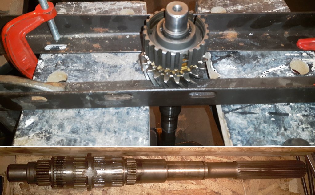

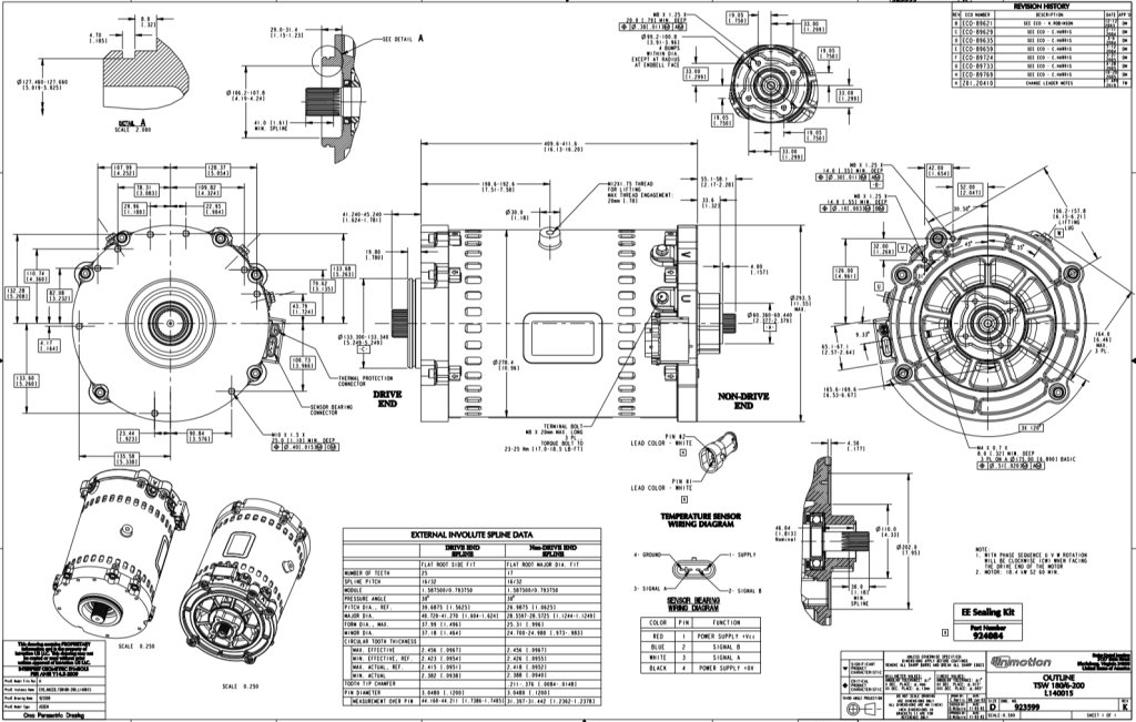

Anyway, now that the rear suspension and torque tube are in place, it's time to think about the driveshaft. No point in mounting it, because I'm going to have to haul it around and try to fit different things to it.
Here is it next to the motor:
(aside - That's my 200th photo in this thread).
The inside of the driveshaft splines are about 1", the outside of the motor splines are about 1.6".
For comparison, the cross section on the tranny output from my mid-sized 4x4 SUV is only 1.2".
Cross-sectional-area-wise that motor shaft is about 2.5x the real estate, so, can easily handle 2.5x the torque.
Batteries are good for some 700+ hp.
Speed controller is good for 480 hp.
Motor I'm not sure of, I think 480 would be too high for more than a sprint.
Doesn't matter, differential will need a dentist if I try to use much more than stock. It's just a fitment problem.
Even if I'm just building a coupler myself, I'm going to need something to interface with the GT's driveshaft. That means the output shaft from an old transmission. The local GT Co-op has several, including one that the founder stole the input shaft from 15 years ago.
Here's the motor, a rebuilt but obsolete for the owner 4-speed for scale (55lbs vs. 255lbs for the motor), and the parts tranny:
In the inset photo above... going through old photos my friends in Phoenix took of the previous owner's garage, there was a transmission there.
I recall them even mentioned this, and said it was missing a bell housing. I figured it would be useless then, as a typical EV conversion involves an adapter plate that connects motor face to bell housing.
I don't know who ended up with it, if anyone. I would've walked right past it.
Prior to seeing the tranmission, I could not have identified it as such. I know nothing about cars so, the only way I'd identify a transmission is by the distinct shape of a bell housing.
Driveshaft is rusty but maybe salvageable. I only have the one. The nose cleaned up decently, giving the rest a bath in Evaporust while I work on the tranny:

Depending on how far back I can get the motor into the transmission tunnel (and where I want the center to be), will also depend on how much of a driveshaft extension I need.
If I want the motor to stay above the trans rails (like the transmission does), the farthest rearward I could put it is about this far:
However, I previously thought the lowest point on the car was the bottom of the trans rail. Having see couple GT undersides now, I note that the exhaust pipes are way lower than that, so I could have some room to play at stock clearances.
If I'm going to have the coupler be that long, it can't be unsupported all the way from the motor shaft, even if the motor shaft is as beefy as it is. So that means probably keeping the tail housing on the transmission, which has seals, a bushing, and a bearing (that I would have to replace with a sealed one or add a seal to, since the transmission body would be absent). That's roughly the right length, and I could mount that to the face of the motor with an adapter plate.
Something like that.

I was feeling kinda depressed about it having taken me 10 months to do this work (10 months elapsed, 3 months of work). All I've done is weld the a little bit of sheet metal, I compare what I got done after 2 weeks of evenings and think "that's it?".
So, I did a little panning tour of where I've welded. Moving just slow enough to say "X to Y" for each seam. Turns out, it's a 5 minute video of me just monotonously reading out what got welded:
https://www.youtube.com/watch?v=p2rsRyfvLbE
It still doesn't feel like it should've taken this long, but, it does feel a bit more like I have been actually progressing.

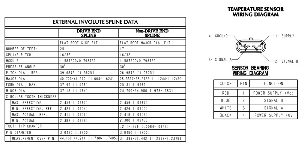

In other news, I asked for specs on the motor shaft from the manufacturer, and to my surprise they sent me an entire page of data just for the spline.
I took that to The Gear Center, a gear/driveshaft store to see if they could find anything that could fit. They got stumped and said they'd look into it for a couple days for me. Not promising.
Went back to the forklift junkyard I got the motor from, he'd originally said he was going to try to save the gearbox for me when they got around to scrapping the rest of the machine. I presumed since I never heard from him that it wasn't a priority before they hauled it to the junkyard. Confirmed that, yeah, that was the case. He said I could try the forklift company, but to not expect it to be affordable. They have another pair of those lifts they're turning into a single working one, but it might not be for months if at all.
If the gear is too expensive, or I can't find it at all, my plan is to spin the motor up, use the grinder to shave the teeth off (I don't have a lathe, I don't want it disassemble the motor, and the shaft is hardened anyway), and then build a taper-lock coupler instead (a sleeve with a matching hole through it, a slot cut longitudinally through it, and then a pair of screws on each side to clamp it tight):
After picking up the motor 2 or 3 times, I've had enough of that. I'm expecting to do that at least a half-dozen times, and I don't think I could do it a half-dozen times safely without a jack. 255lbs is enough to pin me and break ribs if I screw up, and it'd be hours before anyone would find me. I'd jig something up with a ramp or my floor jack if I had to, but, I'll want a motorcycle lift to work on my motorcycle, and, might as well buy it now since they're 50% off ($60). That'll help me lift the motor into position (the car being on the body dolly, I'll then move the whole car to where the motor lines up).
And now after 8 or 10 posts in a row, anyone following is all caught up with my last 2 months of progress.

I have to admit that I haven't read enough to see if you listed the exact diameter of your motor shaft or the tooth count. I can't make out the spec sheet well enough to see the measurements.
I am having a similar problem finding a female splined coupler for my motor (1 3/16" x 18 spline)- after much googling and cursing I figured out that it matches a late 60s dodge clutch and some high end VW dune buggy clutch. These are straight spline but should get me close enough to get the job done.
I would be glad to do a quick search through all the info I amassed looking for mine if you throw me the specs for your motor.
22 Posts
Ok - scratch that. I managed to blow up the bottom picture to a readable size.
A quick search of 1 5/8" x 25 spline brought up a ford massy clutch alignment tool.
https://www.tractorpartsasap.com/new-ford-massey-ferguson-119887.html
You might be able to find a scrap clutch at a tractor repair shop - it wouldn't be a perfect match but some quality time with a file and a stone should get you what you need.
1,023 Posts
Discussion Starter #79
Heh, that mirrors what the guy at Gear Center said yesterday. "40mm... hmm... *calculator*... that's pretty close to 1 5/8"..."
The tool you showed looks like the male spline, not the female, but, $18 is a great price. If couplers are going to be roughly in that range, I'd be happy.
1,023 Posts
